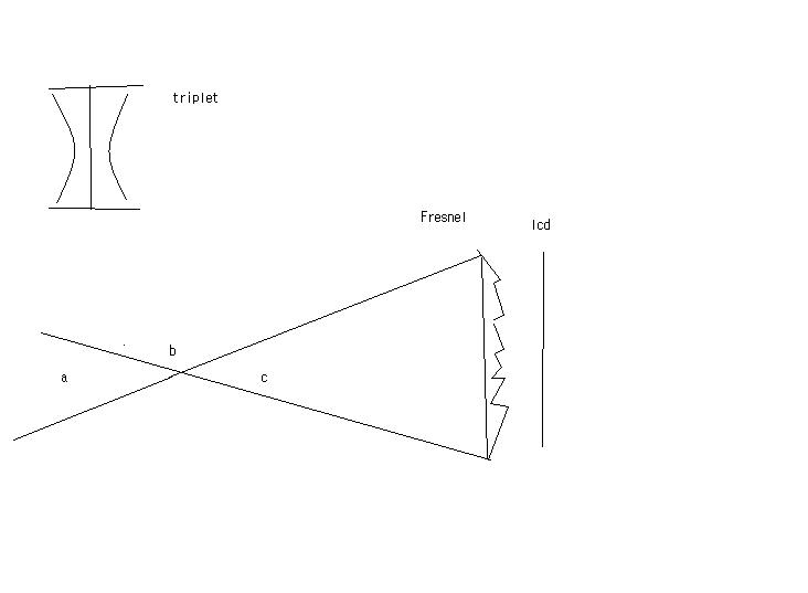

Triplet distance??
Prjoect 30% finished.
how far is triplet placed?
is it supposed to be placed past focal point or before?
and is that point on the beginning of the triplet , middle of triplet, or at the end on the third lens on the triplet?
btw the Fresnel is 330mm .
thanx.
Unless you have a varifocal lens or are never going to move the PJ once set up then you will want to be able to move the triplet slightly to focus the image correctly (many also find that a slight off-focus makes the image better as it reduces the screen door effect).
Therefore without knowing your exact circumstances it is impossible to calculate an exact distance and even with everything I'm gussing it would be very difficult to calculate. If you do need to fix it then your best bet is a bit of trial and error before finalising your design.
HTH,
Steve

It is actually very easy to calculate the distances:
1/focal length = 1/LCD to lens + 1/lens to screen
If you know the throw distance and the projector lens focal length, then you can solve for the LCD to lens distance, which is what I think you are asking:
1/LCD to lens = 1/focal length - 1/lens to screen
For example: (300 mm fl lens & 10 foot throw distance)
1/LCD to lens = 1/300 mm - 1/3048 mm (that's 10 feet)
LCD to lens = 332.75 mm (always more than lens focal length)
Those distances are measured from the principle planes of the lens, which are right about the center of a simple lens. For a triplet, they are probably at each end. For your projector, try making the middle of the adjustment range the calculated distance from the LCD. Then you will have some play for focussing.

the optical center (plane) on a triplet is at F distance from the smallest focusing point when you are focusing the sun (paralell light). It is easier to work with the back focal lengh. the 135 triplet has a 38cm back focal lengh, it means that there is 7cm between the rear lens end and the optical center.
