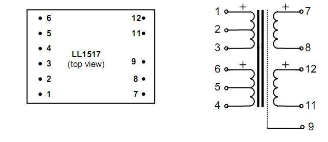

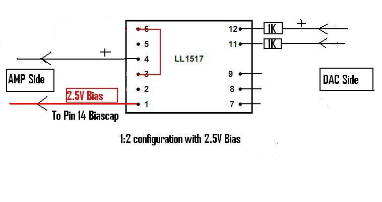

One way of removing the input DC coupling cap on the Tripath chip amps is via transformer. Remember in these Tripath chips the input is biases to 2.5V & the cap is as much to keep this away from the signal line coming in as it is to also block any DC that might already be on the line coming in.
Transformers work in this configuration because one end of the secondary winding is connected to the Tripath pin on which the 2.5V bias is generated (in the case of the TA2020 chip this is pin 14 - called the biascap) & the other end of the secondary winding goes directly to the capless input of the tripath.
So in my case I have a transformer on the output of the DAC and the secondaries connected straight to the Tripath as above - a DC coupling. Removing the cap noticeably removes the smearing in HF & lower LF along with the fact that there is now no turn on pop of any sort even though there is 10mV & 55mV on the speakers out (I'll be removing this shortly with a DC offset circuit.
Diagrams attached
Diagrams attached

I don't know what you mean about the "bias stuff" - it's just done to avoid having a cap on the input. If you consider removing the input cap a good thing then this is the way to go when using a transformer.
