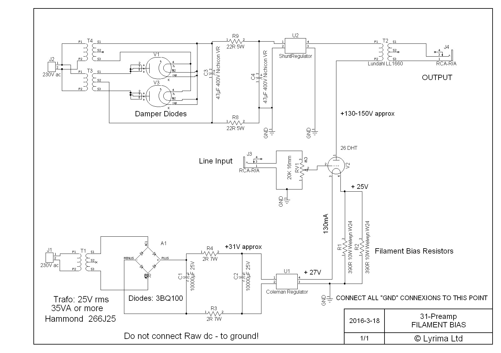

If you are interested in trying filament bias, this is my starting-point schematic, revised for the 31.

hi
here my shematic now:
for information: its only a testing circuit!
Ive changed cathode bypass cap to ultrapath,- i thinks its better.
also i turned from voltage regulator to lcl-filter for filament. its incredible but it sounds much better....
why?Triodenklaus: You might want to check your filament supply..
each tube has a own power supply. i measered exactly 2V/129mA...
I was triggered that you put in 32Volts AC, filter L-C-L and end up with a mere 2 Volts DC?
Is that correct?
Is that correct?
Choke input supply, so approx. 0.9 x 32 of DC voltage.
170 ohm of choke DCR x 130 mA is 22 volt loss.
Then some diode loss.
So the 2 volts at the end seems not strange IMO.
