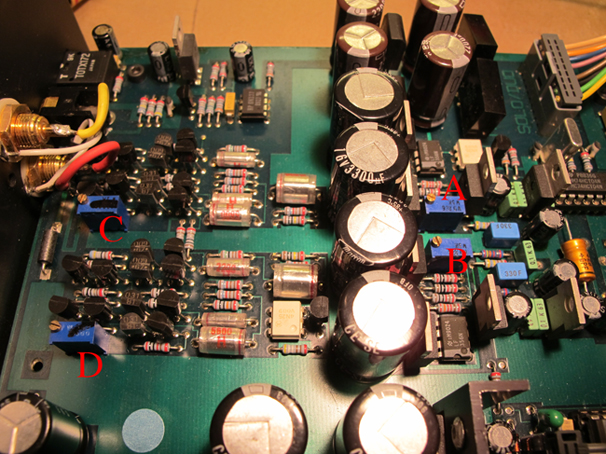

HI, it lacking schematic, before I make mistakes and intending to change opamp, I'm trying to find out which is the function of the four trimmer in the main board of the MICROMEGA SOLO H. Two regulate the output offset (but which: those closer to the output connectors or those closer to the LF356N?). And the other two?

You would have to see what they connect to. Are there four opamps or do the other trimmers go elsewhere ?
I've a Stage 2 (now retired from service) and I did an opamp swap on that. I found when measuring the offset that you can get an inaccurate result due to low level HF hash on the output. I used a simple R/C filter soldered to a phone plug. Somthing like 22K and a 1uf.

Hi, thanks for your answer. I apologize for my bad english. I read your post on Stage 2 and links to TVC (Micromega BS). There is always refers to the offset trimmer adjustment. I sent him a photo of the main board Micromega Solo (on the main board is written Micromega Duo but it is a H bitstream). I think the trimmer A and B (those close to LF 356N) serve to offset, but I don't know about C and D close to the output stage, full of transistor (it is probably a stage coupled in DC).

I would guess that trimmers A and B are adjusted first to reduce the offset of the LM356 output pin to zero. Having done that the other two will be adjusted to set the final offset at the sockets to zero. It would have to be done in that oder because they would interact.
That would be my best guess without seeing the circuit
You would have to use the correct ground for the LM356 to get the most accurate reading and I would still recommend a filter for the adjustment (or use a scope and do it by eye)

. Let's see if I am understanding. So the first stage closer to LF356N in Micromega Solo is similar to the final stage of the Micromega Stage 2. Trimmer on pin 1 and 5 with wiper on + voltage across the resistor r29 in Micromega Stage 2, while on the Micromega Solo trimmer on pin 1 and 5 on LF356N and wiper on + voltage (pin7). To measure the offset I have to put the edge strength of the HF filter on pin 6. But what's the ground point recommended to insert the edge of the HF filter capacitor? For trimmer closer to output sockets I will use the filter mounted directly on the output socket, as you recommended. The OPA606 is valid as a substitute for LF356N?

To measure the offset on the LF356, try and see if any resistor connected to the opamp goes to ground and if so then use that as ground for the adjustment.
The OPA606 looks like it should be OK as a replacement but I always advise checking with a scope to be sure.
