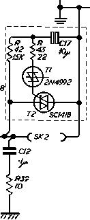

Hey thanks!!
Asen, you're right: the Quad 405 uses such a circuit, you can see it below. Thanks, that's what I was looking for!
Indeed, when using this circuit you've got to be carefull otherwise the whole amp can burn out. I would use it in combination with fuses between the PSU and the pos. and neg. rail of the amp, AND with a short circuit protection of the output devices.

hugobross said:I would use it in combination with fuses between the PSU and the pos. and neg. rail of the amp, <snip> HB.
I think so too. Short out the rails on the amplifier side of the fuses. Use a pair of SCR's here, not triacs because SCR's have a much higher surge rating. (Itsm) Make sure you drive the gate on good and quick and strong so the SCR can safely stand the rapid rise of anode current.

"Use a pair of SCR's here, not triacs because SCR's have a much higher surge rating. (Itsm) Make sure you drive the gate on good and quick and strong so the SCR can safely stand the rapid rise of anode current."
Why not use a triac? Motorola TO220 triacs can do an ITSM of 450A. The 350A spec is for 8.3mS, not the exponential decay of a capacitor. Peavey uses the MAC224A5 in their 1100W amp. The only time the triac blows is when some idiot has put tin foil behind the mains fuse. By that time every emitter resistor, every output, and the bridge rectifier are gone. Do you care about another $1.50 for the triac at that point? If you have the correct fuses it is not a problem.
