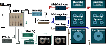

Frank, Sound Dr... thanks for sharing your time.
I have been thinking two ways to do the tri amping on this speaker. (Correct me please if I'm wrong)
First, Mixer--> Equalizer-->Active Xover-->P19-->Hi
-->P3A-->Mid
-->P3A-->Low
Second, Mixer--> Equalizer-->Active Xover-->Car amp1-->Hi
-->Car amp2-->Mid
-->Car amp3-->Low
Note: P19,P3A from Elliott Sound Products
I have already a Mixer,Equalizer and Active Xover
Car amp will be powered by Regulated power supply
All setup will be use for home only
Questions:
If I connect the P19 amp to the tweeter, do I need to have a 25uF cap in series with the tweeter? Is the 25uF sufficient? I guess The P3A will be directly connected to the Mid as well as the Low.
If car amp1 is 25w stereo and will be driving a two 4 ohms tweeter, then the current will be 5A. Am I right?
If car amp2 is 50w stereo and will be driving a two 8 ohms Midrange, then the current will be 5A. Likewise for the Bass
So, the Regulated power supply will be be rated 20A (5A allowance) and 12V. Again, please correct me if I'm wrong.

The second paragraph: (I'm trying to calculate the voltage and current rating of the planned regulated power supply) Following the formula of current= square root of (power/resistance)
"If car amp1 is 25w stereo and will be driving a two 4 ohms tweeter, then the current will be 5A. Am I right?
So, the Regulated power supply will be be rated 20A (5A allowance) and 12V. Again, please correct me if I'm wrong."
I'm thinking of a diy power supply that use a torroidal transformer to power the three car amps mentioned above. 12V, 20A power supply maybe?
Also, please see attached image (pasetup4.gif) for my inspiration (dream).

The supply should be 13.8V DC for the car amps if you are going to use them. It will work though it does seem an expensive way to go about it.I'm thinking of a diy power supply that use a toroidal transformer to power the three car amps mentioned above. 12V, 20A power supply maybe?
