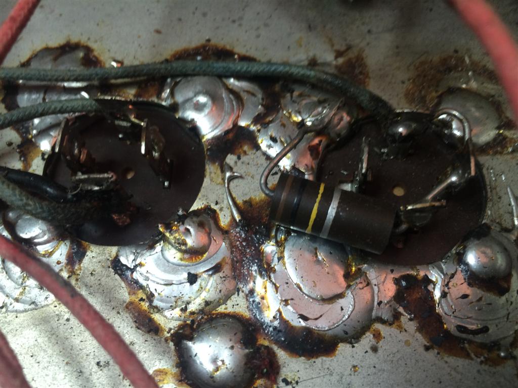

I have a cool rare-ish "Signature" Traynor head on the bench, same as the Bassmaster amps but with Trem instead of the Mid-range expander.
The tube chart lists 6CA4 (EL34) tubes and I believe this amp was built around 1968.

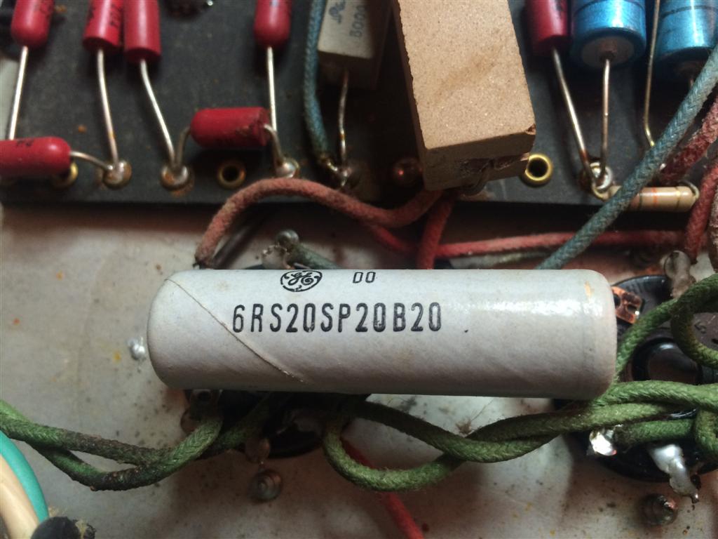

What's in front of me differs slightly from the schematic, namely a mystery component wired across the plates (GE, picture attached) which I assume is a high voltage capacitor, any takers? The two 470ohm screen resistors (R29, 30) are not present, instead a single 20W 1K resistor is wired in series with the screen supply voltage.

sounds like your amp has had some work done to it to convert it from the original tubes which where 7027a's.
what's it currently running for output tubes?
the "mystery part" is supposedly a transient suppressor (a diac anti-parallel diodes or something along those lines) most consider it a tone killer.
i would (if your output tubes are 6L6) reference the bassmaster mkII schematic as a guide on sorting this one out.
if you look at early bassmaster schematics you'll see the "mystery part"

Also, whats the verdict on the suppressor, can it come out? Should I drop in a .005/1600V orange drop across the plates instead?

Pete followed hifi design examples with his amps. Only he and Gar Gillies used the biased suppressor, which we call the "Canadian Connection" in our books, even though Mullard suggested it in their original notes for the EL-34. You can easily tie pins 1&8 together and ease bias setting.
