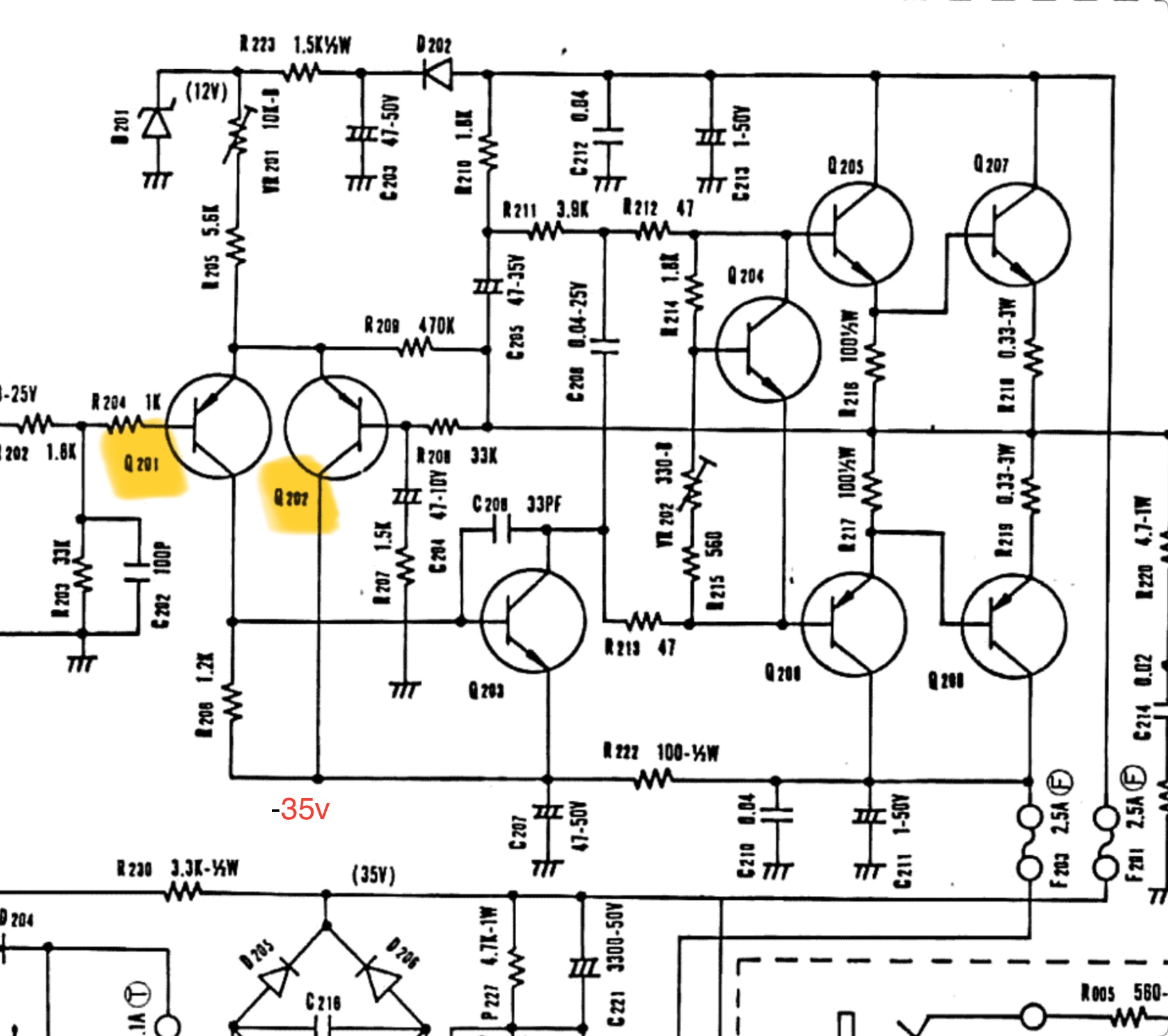

I’m currently working on a Luxman L-31 amplifier but doubting my choice on a transistor substitution. Lots of people replace the 2SA836 and 2SC1345 transistors with BC560 and BC550 transistors. But for Q201 and Q202 the VCE exceeds the maximum VCE the BC560 can safely handle.
Without checking the further specs I picked two KSA992 transistors out of my stock and used those. The amplifier works fine but I suddenly realized the KSA992 has a maximum current of 50mA while the 2SA836 has a maximum current of 100mA.
My transistor calculation skills are practically gone after 30 years so I tried simulating the circuit in Falstad circuit simulator. That resulted in a maximum emitter current of ~2.9mA in Q201 and ~1.9mA in Q202. Those values feel a bit low to my idea.
Can someone explain, or advise me a website with a decent explanation, how I can calculate the current in a differential pair like this?

Current to be split between Q201 and Q202 is apprx (Vzener-Vbe201)/(VR201+R205), depends on setting of VR201

You get vbe across R206 (I think that’s a 6) which is 1.2K. That’s around half a milliamp. Adjust VR201 to give a total current of twice that (somewhere around half rotation) to balance the diff pair. It will WORK if it’s out of balance but there are limits to how well. When properly balanced it will tend to have low offset voltage, but the best setting for most amplifiers is when the two emitter currents are EQUAL.
I recognized the differential pair so I matched the transistors and the DC offset was easy to adjust between +/-5mV. It’s the current flow calculations around transistors that get me. Had some in school back in the mid 90’s but electronics was a minor and mostly focused on digital logic.
