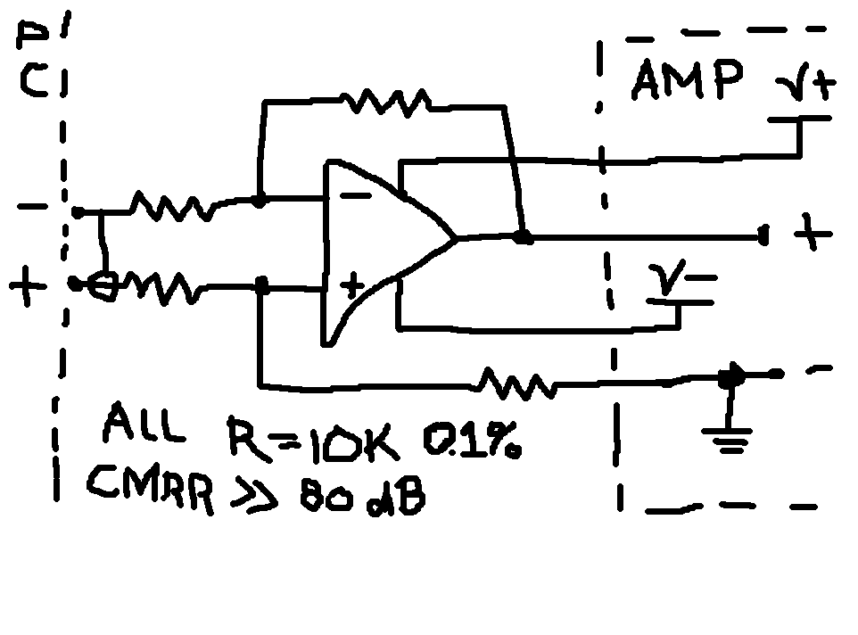

After more looking, I came across this helpful thread. A lot of people have similar problems - ground loops and other noises from their PC's...
Anyway, in this thread, poobah posted this schematic:
I threw one together on a bread board, and it seems to work, so my thinking is to modify the input of my power amp (which also has a differential input, but I'm not using it that way).

Did you try using balanced input amplifiers? Yes I know your PC is unbalanced. Tie the '-' inputs to the sleeve of the 3.5 mm connector. The '+' inputs go to the tip and sleeve. Do NOT connect the 'grounds' together directly. You can try a 100 ohm resistor just to keep the grounds loosely coupled. Do this for each of the 3.5 mm connectors on the outputs. The 'signal' lines have signal plus ground noise while ground has just noise. The differential amps will subtract the noise from 'signal plus noise' and leave you with signal. I've done this many times and it also works with analog video hum. Remember that the accuracy of the noise cancellation depends heavily on the match of the resistors but you can buy chips like this with precision trimmed resistors in the package.
I think you have got it slightly wrong there, for a start you are shorting the signal to ground. Cold (-) input goes to sleeve, hot (+) input goes to tip, and ground to sleeve through 100 ohms.
that is just what I was talking about in my previous post. I haven't tried converting my amp yet, but I will. I'm not too sure about the changes I need to make though.
