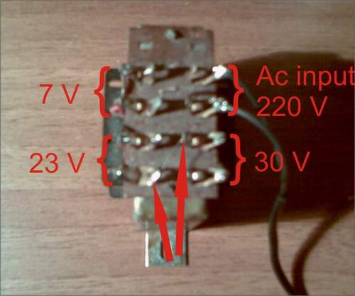

I need 2x15v supply for preamplifier. I have a transformer with two output. One is 23v and second is 30v. Two windings are connected together.
Can i connect it to a rectifier? Will this voltage difference bother?
If it is ok then i will also use zener, transistor to lover voltage at 15v dc.

It's working!
Now i have +-40,5V. How can i make +-15V for preamp?
