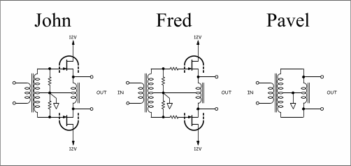

I just realized that Nelson published his Zen I/V converter and here is a slight modification to replace the two 10uf caps with a transformer.

completely logical ;
it's easier for you to make xformers than to make resistors
in any case - to keep things clean and safe - it's wise to decrease PS to +/-12V or - even better - to increase it slightly , and cascode Jfets
Since I make resistors all the time, don't you mean it is easier for me to make transformers than 10uf capacitors 🙂
In any event the low voltage drop of the transformer primary allows 15V supplies to be used which I guess could be spun as a green solution nearly halving the energy consumtion of the circuit.
I do want to say that outside of spice, this hasn't been tested yet so I'm just throwing it out there for discussion.

Nice. Ideas/suggestions for the x-former? - Pat
A line-level transformer intended for push-pull dive and sufficiently gapped to handle the JFET bias currents. Perhaps, one of the amorphous core Lundahls would serve quite nicely, if not inexpensively, I should think.

Drain resistors good.
You have to have the drain resistors so that you are not trying to drive the transformer only from the JFET drains, Their impedance is way too high and would cause both distortion and low-frequency roll-off with the transformer. Those resistors essentially present a 1k ohm source impedance for each primary winding.
Another huge advantage of transformer coupling this circuit is the dramatically increased PSRR. The cap coupled version has essentially a PSRR of zero, with respect to imbalanced power supply noise. This is due to the current-source like JFET drain nodes working against us. The transformer coupled version should have excellent PSRR due, again, to the current-source like drain nodes, but this time working in our favor.

You have to have the drain resistors so that you are not trying to drive the transformer only from the JFET drains,.......
agree with everything ( even if I didn't quote entire post) - but I meant on custom made xformer ,optimized for that .

Yes, I see what you would hope to do. The problem would be that I don't believe any custom audio transformer could be made with a high enough primary inductance. Such a configuration as you're thinking is possible with tubes because they have an internal plate resistance appearing in parallel with their transconductance element.
A grounded source FET has no such internally parallel drain resistance and so act only like transconductance elements (high impedance current-source like nodes) as seen from their drains. BTW, this is also true of bipolar transistors and tube pentodes.

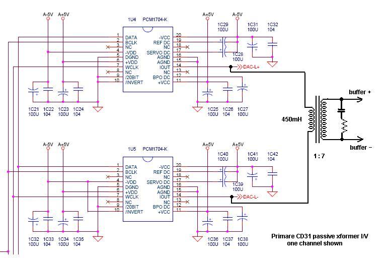

You can drive a transformer with a current-source if you put an appropriate load on the secondary. I've done it before. The reflected secondary loads the amplifying device. You can get flat output across the audio band as long as the secondary load is pure resistance.
I already does the same in more than few DACs ;
to my ears - loading DAC I output with reflected load is best - that way you're achieving linear transfer of entire combo .....
but wasn't in the mood for splitting the hair here .....
K&K use a Lundahl LL1674 transformer on their PCM1794 based RAKK DAC. An active or passive output is available. I still own the original version of the DAC with the passive output. Output impedance (off the top of my head) is 3k.
