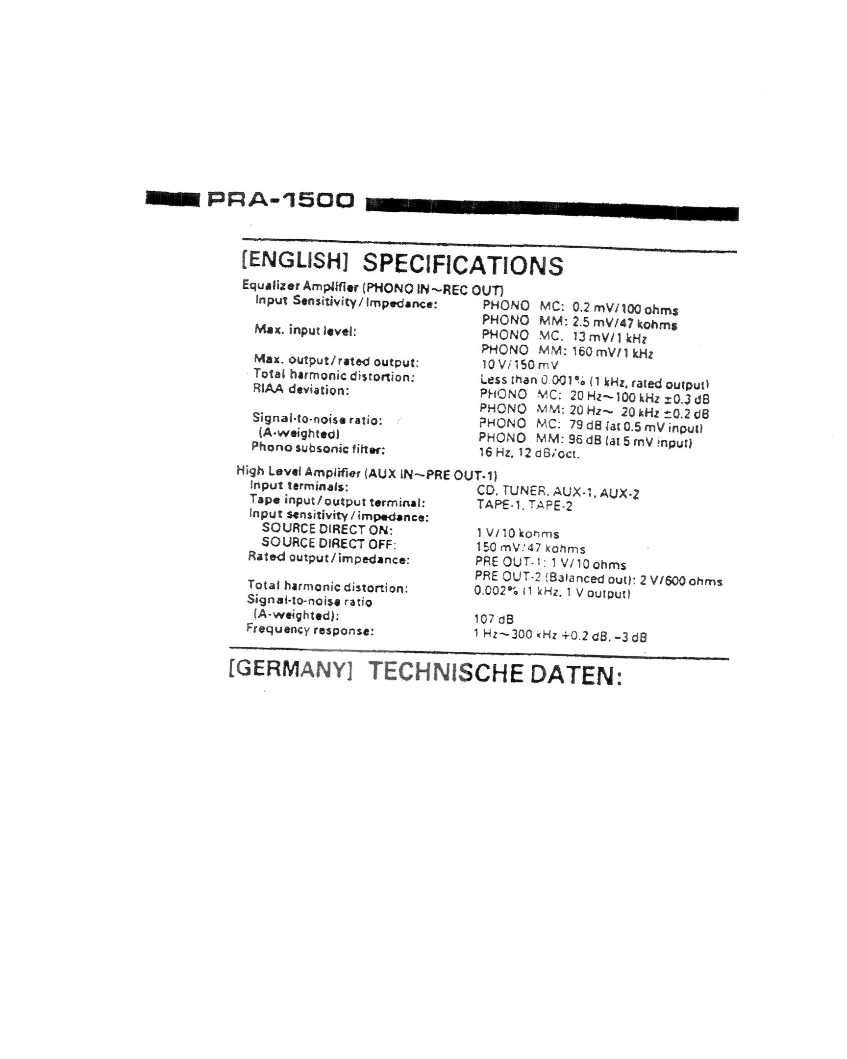

By the way, the input impedance of the amp is 22K and the output impedance of the preamp is 10K. Does this affect anything? I got the PRA-1500 specs from:
http://www.classic-audio.com/denon-pra1500-p-498.html
I notice that the preamps they normally sell to go with this amp are much lower output impedance (one 2K, the other 600), is it possible that the mismatch in impedance is a factor in the failures?

Well, I have subsequently replaced the blown fuse and installed the amp on a low output impedance tube preamp (MF x-pre) and I no longer get blown fuses! The manufacturer said his monoblock version of the amp was very sensitive to the output impedance of preamps and I'm now believing it. But what is the explanation for this?

BTW the output 10K impedance rating is most likely nominal, referring to the load as many people get confused, stubborn and refuse to buy things where impedances don't read as similar. Read some fairly recent posts in Bob Cordell's Book thread for confirmation.

Even better to have x100 impedance 'mismatch'.
The output impedance of a preamp cannot cause a power amp to blow fuses. Whoever told you that is either an idiot or he thinks you are an idiot.
Some preamps have a voltage spike at the output at or just after switch-on. How big and how long this spike is depends on all sorts of things. A main amp may or may not blow fuses if presented with this spike. Nothing whatsoever to do with the transformer. These spikes or transients can be worse in equipment which foolishly goes down much below 10Hz, in the belief that we need to hear down there. The quick solution is to switch on your main amp only after the preamp has had plenty of time to settle (say, 30 secs delay?). Switch off main amp first, then wait before switching off preamp.
I doubt if the Denon preamp has a 10K output impedance - this would be quite poor! More likely that it has a 10K 'minimum following power amp input impedance' - this means it will happily match anything from 10K up. Your 22K is a bit close but good enough. 100K would be better. Remember, you actually want a serious 'mismatch' here!
the RCA (unbalanced) output impedance is 10r. This will drive any load >=10k
The balanced output impedance is 600r. This too will drive any balanced load >=10k but better if it were >=500k to ground.
