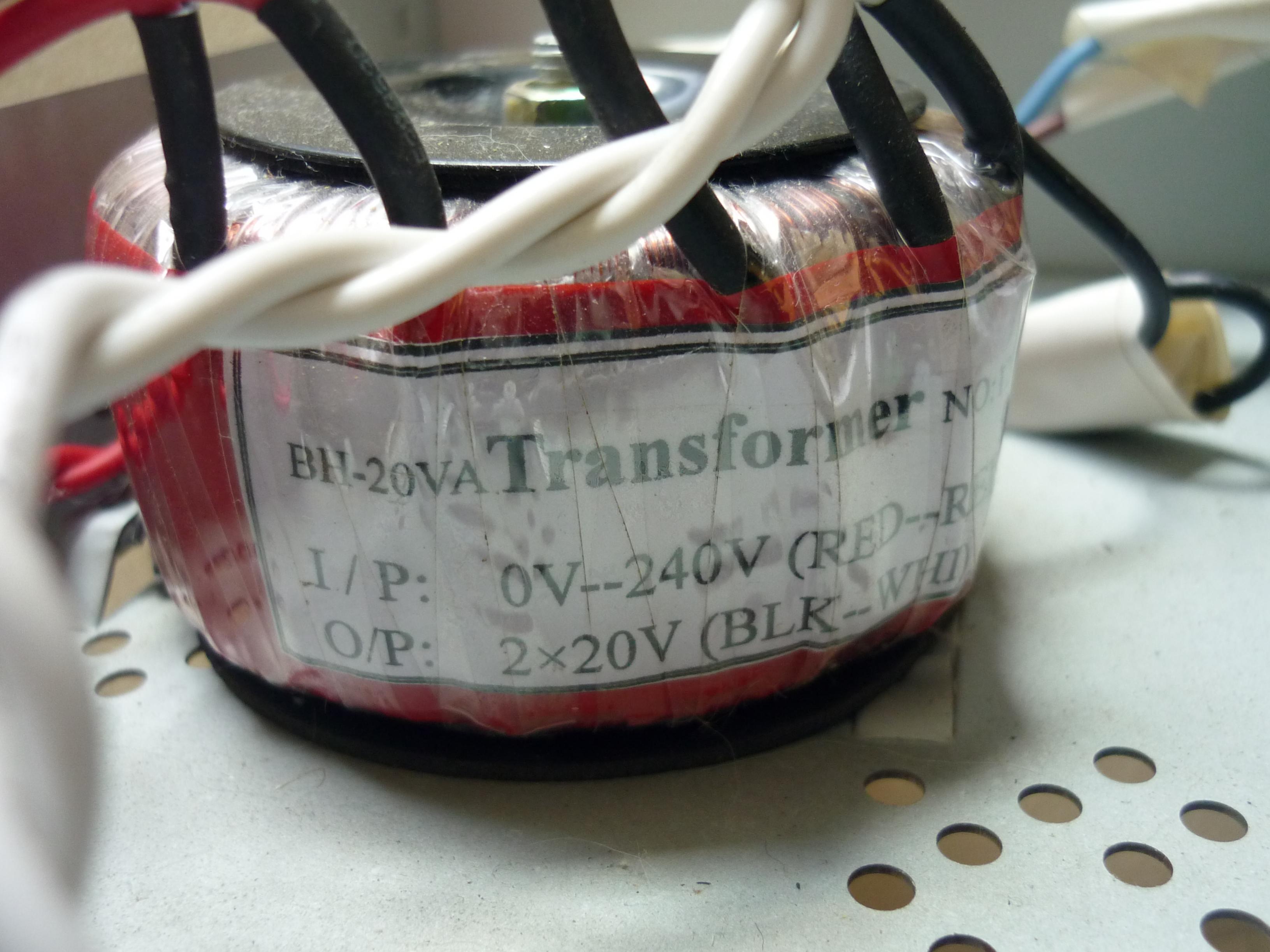

Hi all. I have toroid trans (230v in) with TWO RED wires which label indicates as " IN 230v ...RED-RED " ; then it has " OUT 2x 20v ...BLACK-WHITE " referring to TWO WHITE and just ONE BLACK.
I was advised to NOT CONNECT THE BLACK TO ANYTHING AT ALL....Just to connect the two whites to the pos and neg terminals on the phono preamp board's input.. After several months of trying to eliminate the HUM problems I put it all away ! Now I am going to try yet again to sort this out.

if the transformer has only 3 wires on the secondary (White , Black , White) then it can"t be 2 x 20v , it is probably a 20v 0v 20v ....
Can you fill us in on what the power requirements are for your preamp , like what voltage it runs on (a 20v 0v 20v transformer would a bit on the high side for most preamps) ?? Does it have 2 places to connect the Transformer or 3 places ?? Most higher end preamps run on a dual supply which uses 3 wires from the transformer ....

Well if you are using the two white wires and not the black one then you are feeding your preamp 40v AC (which is about 55v DC) which is probably too high for your preamp ....
And Katieanddad is right , your preamp boards probably runs off of DC not ac ... A transformer put out AC and batteries are DC , unless your Preamp has an onboard rectifier then you are not powering it correctly ....

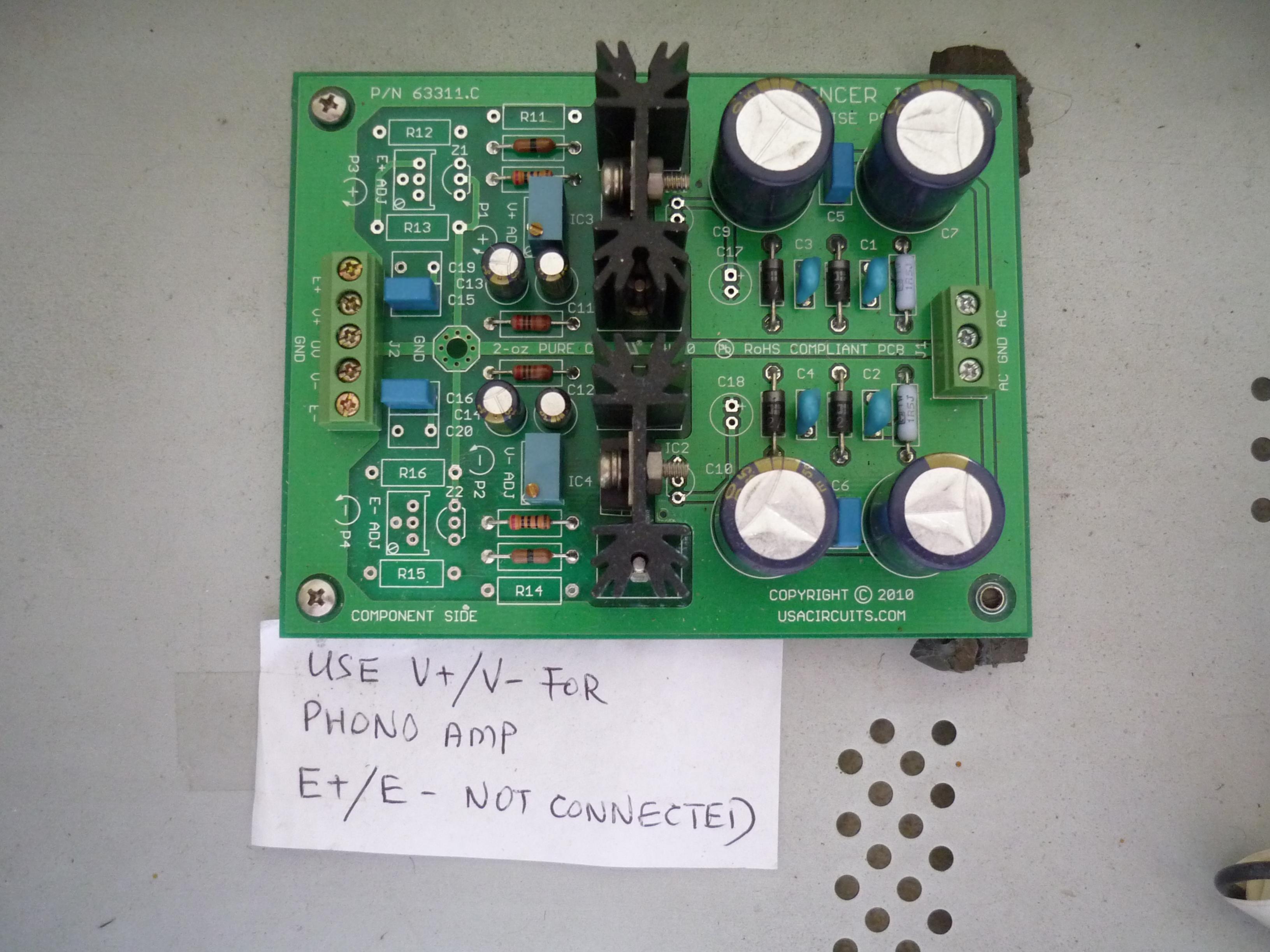

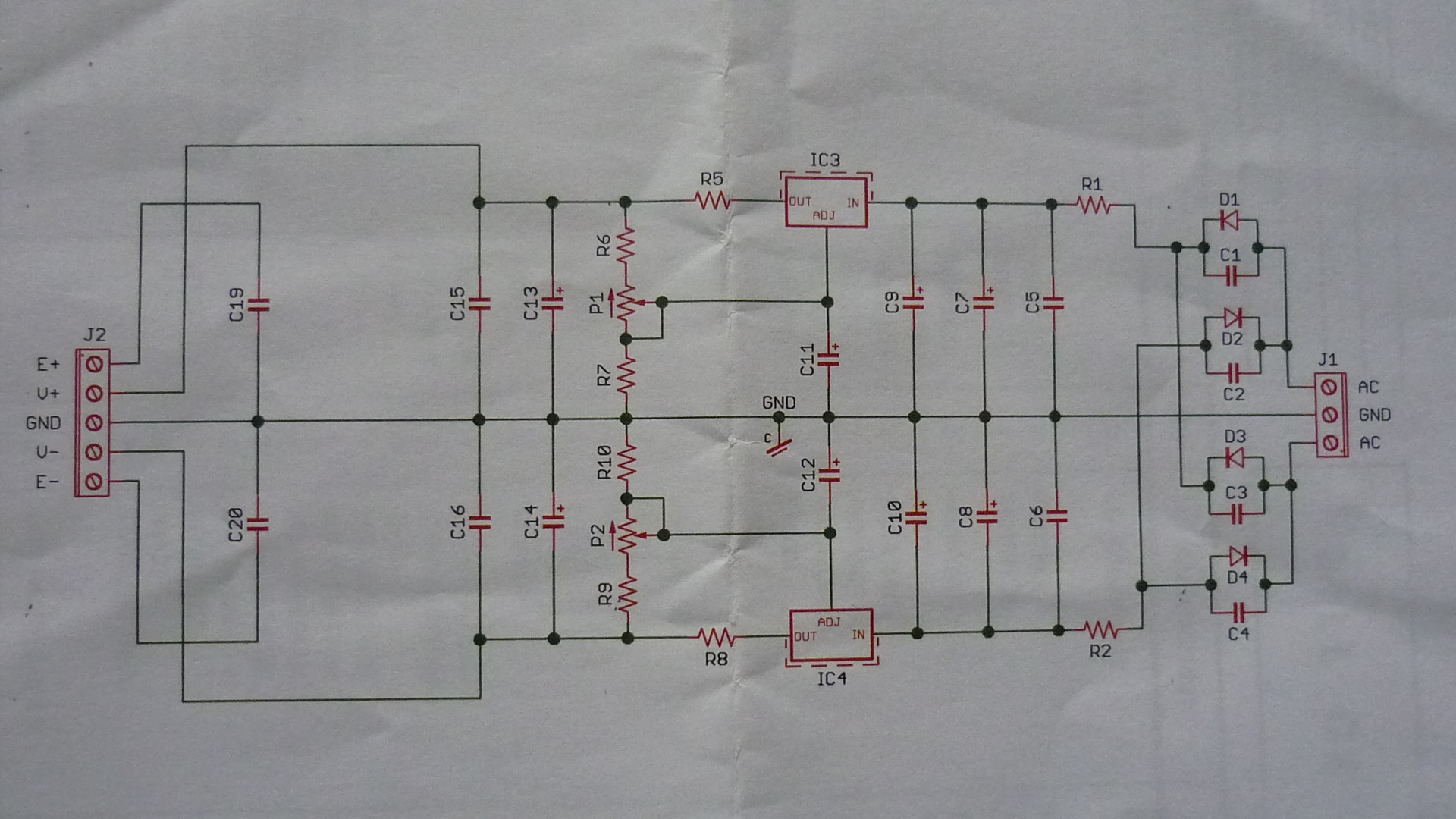

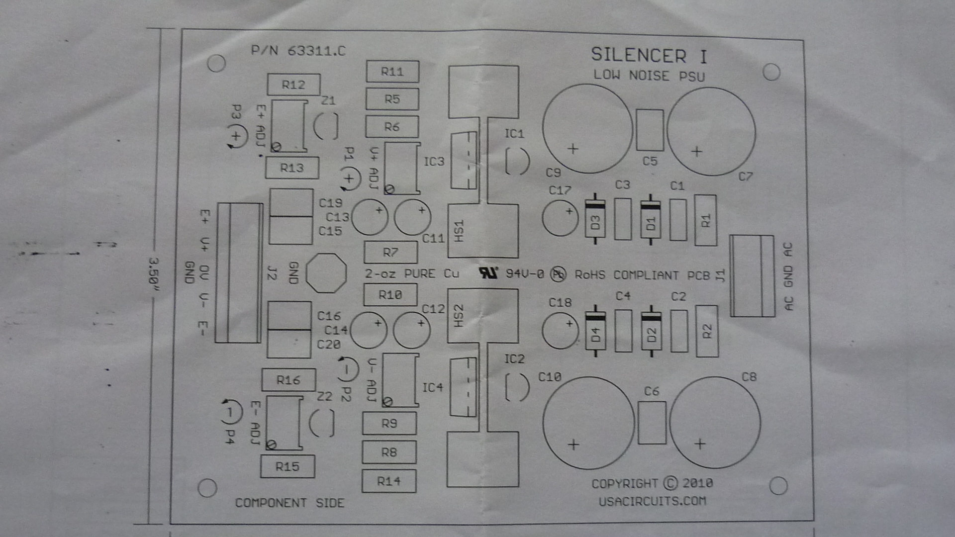

RE😛HOTOS -TRANSF & PSU CIRCUIT HELP PLEASE
Guys this is hopefully going to help obliterate my "hum" issue......
with that board you need to use all 3 wires from your transformer , so white on the 2 outer lugs and the black on the center .....
