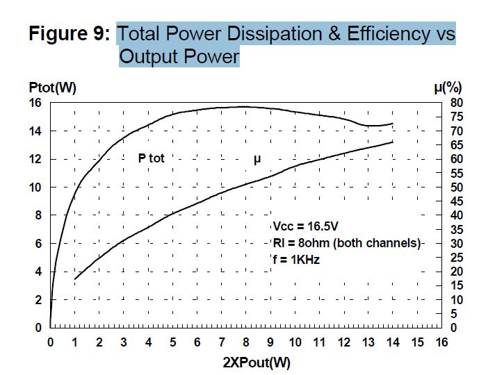

yes it gets hot - look at the figure 9 at the datasheet.

Hi Magnitude
Have a closer look to the data sheet at figure 9. at - look at e.g. 0,5Watt output - with correct heat sink - you get about with 6 Watt heat dissapation !!! note the graph shows 16,5Vcc - you´r using now 12V - the original heat sink is bad. --> so a 2,3K/W or bigger should do.
at the max ratings is written that the case temp is max. 70°C - so with a bid of margin you should n´t measure at the case about 60-65°C max!! during your power tests - be carefully here....

Hi Magnitude
