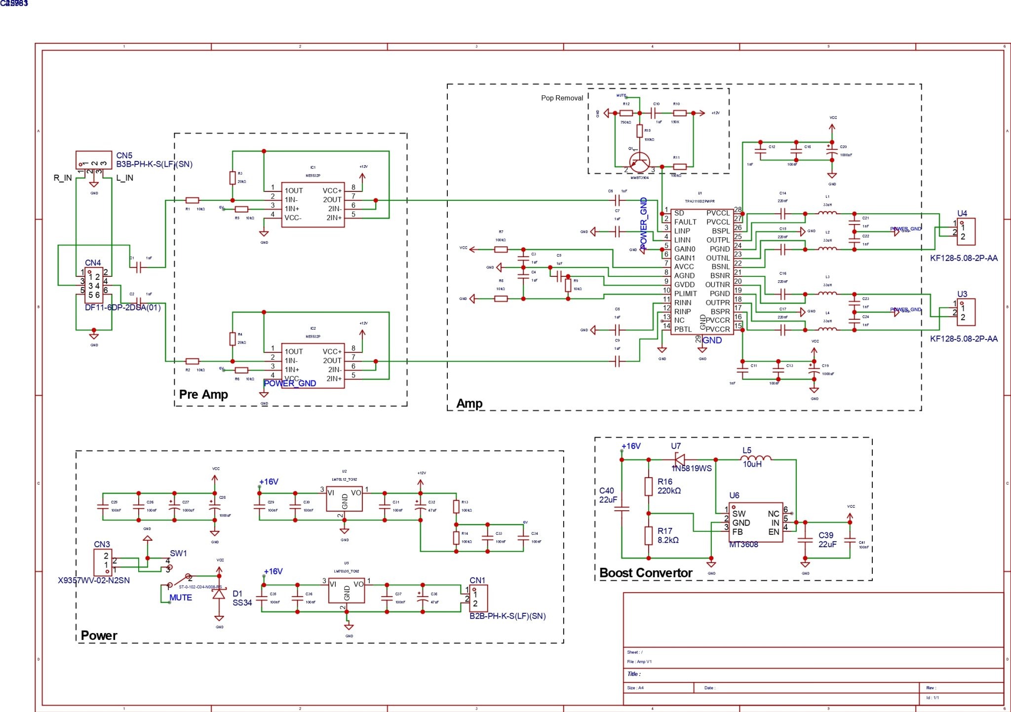

Edit: The issue is solved by replacing R7 with 10ohms
Hi there, I am currently designing a class D amplifier board. My ordered PCB has finally arrived, it took me a while to solder the rest of the tht components. After connecting the audio source and the speakers, no sound is produced.
The schematics of my design is attached to this thread. The board features with TPA3110, which is the amp itself, two preamplifiers for left and right channels, and a DC 5V external output. The pre-amps and the external output both powered by 16V from a DC-DC boost converter.
I wonder if what's going on and what am I missing. It would be wonderful if you could help me~ Thanks.

Instead of direct grounding C21,22 and C23,24, ground them by 100 OHM 2 W resistors, you get finer high frequencies

Gonna try that later, thanks for your advice!Instead of direct grounding C21,22 and C23,24, ground them by 100 OHM 2 W resistors, you get finer high frequencies
For the schematic, i used Kicad on most passive components. Then i realised I am going to order from jlcpcb anyway, so i switched to easy edaNice schematic by the way.
