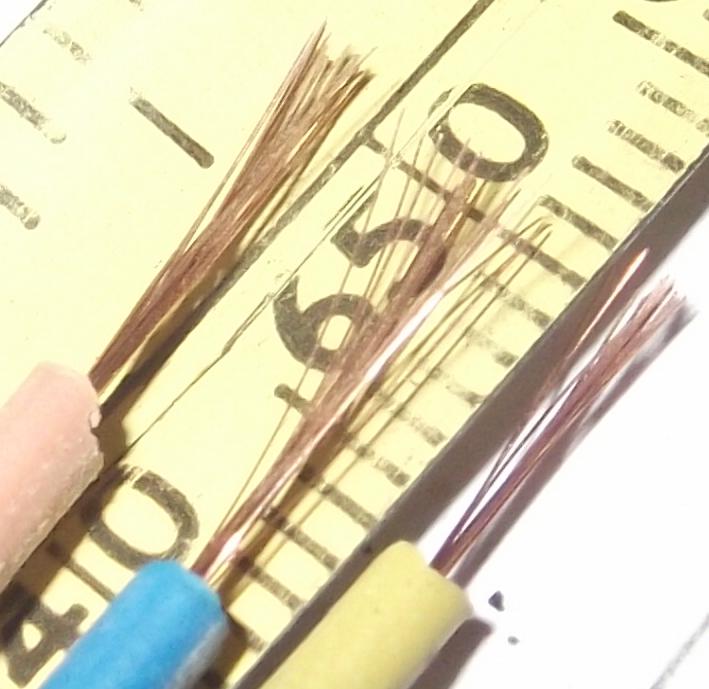

Recently I attempted to solder wires belonging to an air-pump manufactured in unsaid country of origin. Stripped, they looked like normal copper wire. Soldering, you better be quick and nail it the first try. With a lot of heat the wire resembles copper plated plastic - whatever it is, it becomes unsolderable after heating. Forget tinning first - ruins the wire completely. I've NEVER seen anything like it - what type of conductive material just turns black after heating and refuses to wick up any solder - copper plated aluminum?
This is the famous "aluminium bronze" or "anymetalmix" made in unsaid country of origin. When you twist the wires they will turn back 🙂 These are not solderable, you can only crimp the cables. Do not attempt to solder these cables as they WILL come loose and may cause unsafe situations. Probably soldering fumes are toxic.

This is the famous "aluminium bronze" or "anymetalmix" made in unsaid country of origin. When you twist the wires they will turn back 🙂 These are not solderable, you can only crimp the cables. Do not attempt to solder these cables as they WILL come loose and may cause unsafe situations. Probably soldering fumes are toxic...
Thank-you - I thought I was losing my mind over this wire. I was considering crimping them to a wire type I could solder to, when working with it. I'll be wary of these soldered connections I was barely able to make; they do have a cover of glue assisting the mechanical stability.

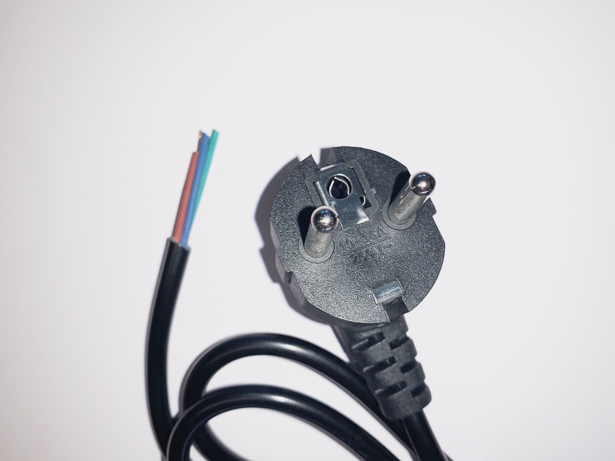

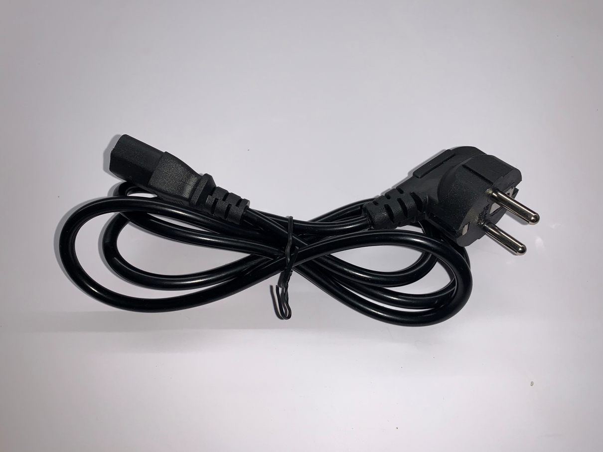

Those fake IEC cords are dangerous. I attach a picture of the power cord that is currently supplied with a device sold by a "marketplace" seller on a popular ecommerce web site. Most people are unaware that they are not purchasing from a domestic supplier, even if they pay to a commercial entity that is (fictiously?) based in EU. In US market this works in the same way, I believe. The end user is the importer; the seller does not bear any risk when it sells a item that is not compliant with safety regulations. And this is exactly what some unscrupoulous business is doing. The visible part of the wire does have a standard IEC identification code, with good data: 3x0.75mmq, the manufacturing date, the manufacturer name (YAOYOUE in this specimen), the wire classification and the insulation material (PVC). The moulded plug does not have any manufacturer or safety mark, the only marking is the 16A 250V number; this is a red flag already. The cable looks flimsy and does not feel like a regular 3x0.75 PVC, but this is not obvious to untrained people. Cutting the cable reveals that the external jacket is very thin, and the bulk of the insulation is some unspecified rubber-like plastic. Conductors color is wrong, the section is much smaller than 0.75mmq, and they are made of alluminium. If you use this cord for a bigger load, let's say a laser printer, it will overheat and melt without tripping the circuit breaker until the wires finally short out. This is a real fire and electrical hazard, because the naked conductor will poke trough the melted insulation. And the crimping inside the plug may go bad easily. I've found several cords of this type already; this is becoming a real issue. IEC power cords are quicky interchanged with other devices. As example, people may be tempted to use this aluminium cord for their portable devices (laptop computers, etc) because is lighter and more flexible.

The thin insulation often is also strange as you can strip it with your finger nails. Some are so low quality that even bending causes the insulation to break. It indeed is not PVC but a matte thin rubber like stuff and the colors are also somewhat unusual. It is clear quite fast that this is not a standard quality IEC cable.
My questions are: would the brand YAOYOUE exist in a fake and a real version or is it a plain shitty company producing ultra low quality stuff?
BTW the conductor of the cable in the picture seems also "aluminium bronze" as the Far East marketing name 😀 is. The color is copper like.

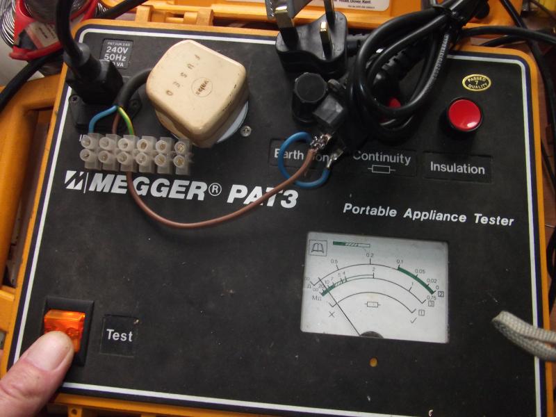

Those power cables read high resistance.
They are made of some kind of straightened out steel wool that has been dipped into some sort of copper solution.
I found one that was rated at 10 amps that claimed it was 0.5mm. It was nothing like that.
It read well over 1 ohm per conductor.
It would be toast if it was run at 10 amps.
The first calibration mark is at 0.5 ohms and the pointer struggled to move let alone get to that first calibration mark on the top scale.
