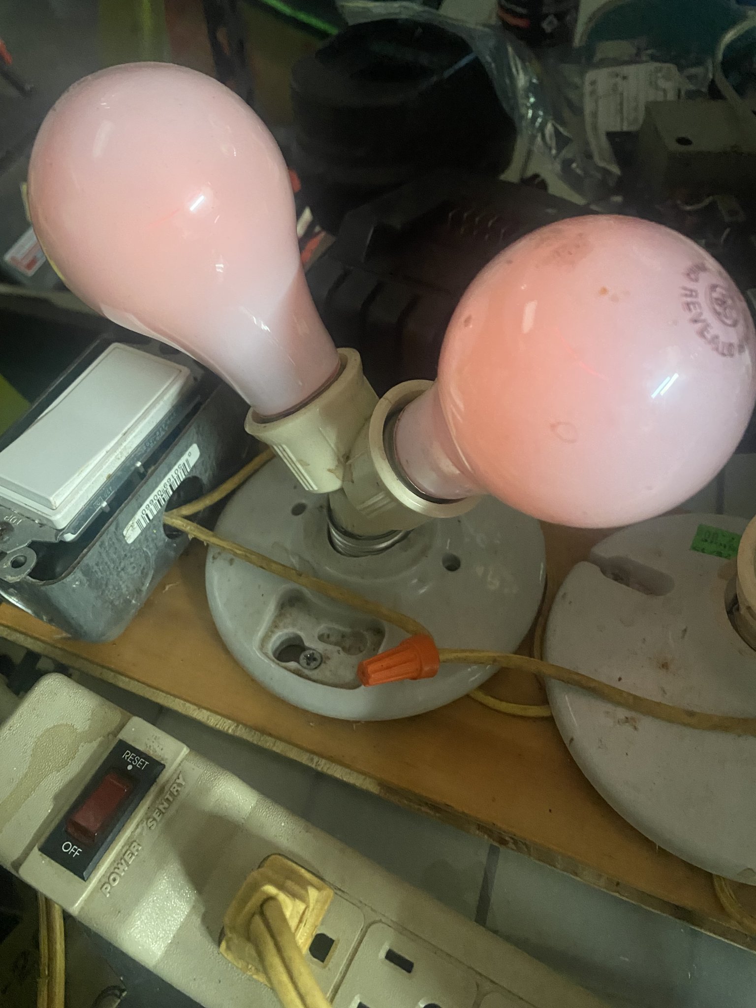

Hello all, so I finally got is playing however I getting only 42v on the supply rails. In addition the two 60watt builds in the DBT look like there is still a problem. Not sure where to troubleshoot. Any help will be much appreciated

Usually one uses the dim lamp as a quick go/no-go test. Usually at initial power up, the lamp is bright, as the power supply ecaps charge up, the lamp dims. If the load draws a normal current, output stages biased, the lamp will show dim and limit the supply so normal voltages will be reduced
try this
Turn the power amp output stage bias current to minimum, when power is off power back up the lamp glow will be very dim, the 42V you measured will rise a bit.
If these tests pass you can power up on regular supply
Hey thanks Rsavas, I bypassed the DBT and nothing bad happened 😢. However I don’t think the protection circuit is working properly as there is no pause before the relay opens. I’m looking at the schematic to see if I can determine where the problem is on this Toshiba SA7100.
