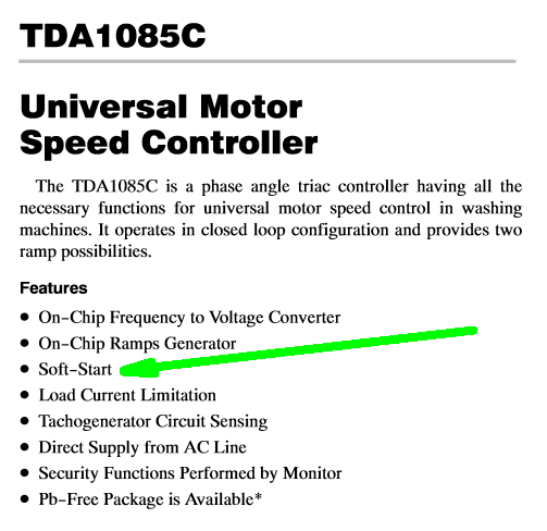

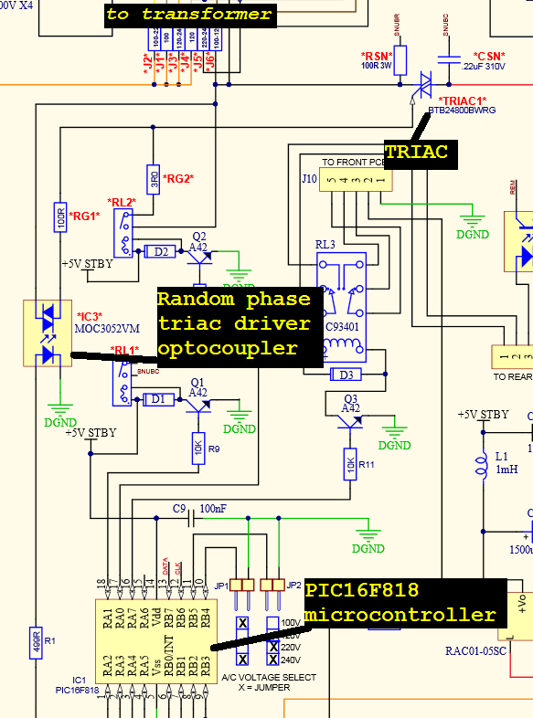

Yet lots of people do it exactly this way.That is not a nice way to start a transformer.
Sufficiently motivated readers will be able to find Bryston's web page where they present the circuit schematics of their amplifier products, just as I have. On that page you will find a PDF schematic of the Bryston 2BSST amplifier, which I have excerpted in Fig.1 below.
You'll see there is a PIC microcontroller chip, which controls the transformer soft start using a triac and a triac gate-driver + optocoupler. Previous generations of Bryston power amps used a TDA1085C chip + triac for soft start; later they dropped that chip and programmed their own soft start algorithm into an inexpensive uC. Saved themselves some money and got exactly the soft start they wanted, at the same time. Schematics for those older generation amps are also provided on Bryston's download page.

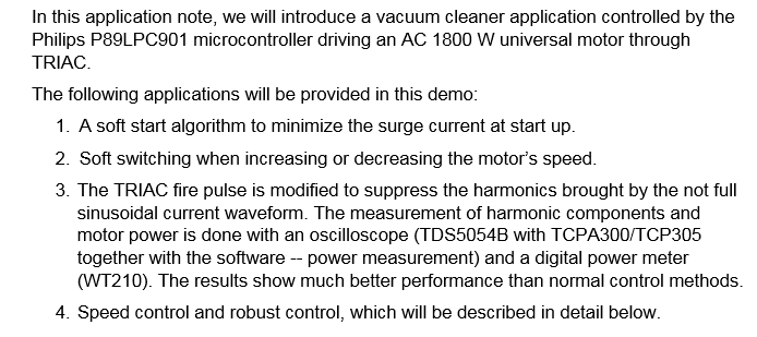

Yes the triac is a near-ideal switch, and obviously when you switch it "ON" you connect the mains directly to the transformer primary. This is not a deep insight.The first time the triac closes the mains is directly connected to the transformer.
The deep insight is, because the mains waveform is a leisurely 60 Hz, you can precisely control the exact instant when you close (and open) the switch.
The people who designed the TDA1085C integrated circuit in post#14 above, had this deep insight. They realized that the sinusoidal voltage across an ideal inductor, leads the sinusoidal current by pi/2 radians. They also measured lots of physical, non-ideal, inductive loads like motors, transformers, solenoids, etc., and found the range of E-vs-I phase relationships observed in practice.
Knowing this, the job is now to throw the switch (change the triac from Hi-Z to Lo-Z) at exactly the right sinusoidal voltage, such that the sinusoidal current is zero. Presto, there's no discontinuity in current.
This is all discussed very nicely in the Philips' (now NXP's) application note AN10496, which I have excerpted below. They manage to control exactly when their IC switches the triac, to achieve soft start of a 1800 Watt AC motor. Which makes our puny 750VA audio power supply transformers, appear feeble and impotent.
