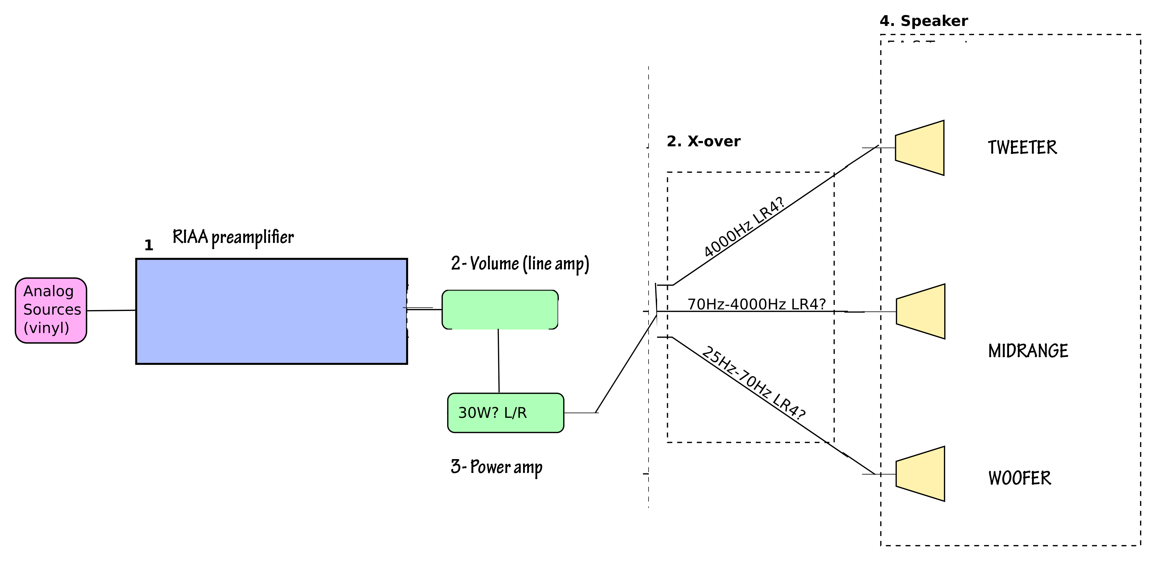

Projects that start poorly, end poorly, so I want to invest some time and study into building a home HiFi system.
I'd like your feedback on the plans I'm working on, including sources, processing/crossovers, amplification, speaker types and enclosures. I'll eventually do separate posts in the proper forum for the details of each sub-component, though this build process is likely to take a couple years (and I dare not begin until my current "honey-do" list is completed).
Here's a diagram of my concept, which is still at the brainstorming/spitballing stage. I've broken it down into 4 parts:

The only comment I'd make is be careful about railing yourself into a particular D/A converter. You must know how these elements all have their signature sound regardless of objective measurements - or there wouldnt be such a proliferation of product designs with various internal architectures.
Of course that consideration disturbs your choice of doing the DSP within the PC - and having 6 simultaneous outputs. I just read about the "JAB5" amp, which can be cascaded to 8 channels - each with it's own DSP xover filter. But even then, you'd have to like the sound of (I suspect) the ADAU1701's D/A converters. Since this chip is used all over the place, it's probably a safe bet. But still a one time, no going back bet on it sounding to your liking.
With line level analog Xovers you're free to swap out D/A's all your listening career long. That assumes they are faultless with all their passive components and op-amp choices.
The situation makes me wonder why nearly all amplifiers are flat 20-20k, versus deliberately building an amp for the best sound within a common, well known Xover range, such as 800 on down. With level, slope and cutoff controls, kinda like on a commercial sub. Just daisy chain the bass, mid and treble amp off your favorite line level DAC output and setup to taste / measurement.

jdubya,
You mentioned that you like the sound of wide-band (aka full-range) drivers, and are planning to build a BiB or Metronome that (both quite large cabinets). According to your diagram these speakers will take care of the frequency range between 70 Hz - 4000 Hz.
Below 70 Hz you are planning to subwoofers tuned to 25". These subwoofers would have a large radiating area - 12", 15" or 18" and you are ok with deploying a pair of these according to your requirement.
Over 4000 Hz you are planning to use a compression driver in horn.
Your design choices indicate that you are looking to build a speaker system that has good dynamic range?
Are you trying to fill up a large space?
One concern I have that the modestly sized wideband driver is entrusted to cover a quite a significant amount of the frequency where lot of the "power" of the music resides, especially up to 500 Hz. Not sure if you will get the desired oomph from deploying a low excursion single wide band driver through from 70 Hz onwards, albeit in a large cabinet like the BiB.

Thanks for replying zman01,
I am a novice when it comes to pairing speakers and enclosures to cover multiple octaves, so your feedback is appreciated. I would be glad to hear about any modifications/alternatives you would suggest.
I do want punch with this system. It's somewhat missing on the FR system I now have, and was the reason I was adding the subwoofer this time. Also, depending on the FR driver I select, I'm realizing that I may not need a super-tweeter. Though, again, the FR set I now have is a little soft in the last couple octaves. It's DIY but also inexpensive.
70Hz was chosen because I didn't want to cross-over in the human voice range, and it was low enough that the sub would only cover 2 octaves.
The room I'm in is not large. 14' wide with 8' ceilings. I'm looking for a fast, clean, open sound (like everyone else).

jdubya,
Speakers are all about compromises. One of the forum members who has contributed many designs to the community likes to use the expression "you pick your poison". 🙂
Having no cross-over within the "voice frequency" band (300 Hz - 3000 Hz) has it's benefits, but some compromises might occur also. In my experience it is relatively easier to enjoy very good imaging and a deeper 3D sound stage with a single wide-band speaker (in a well designed cabinet) being driven by a single-ended tube amplifier; with a 2 way / multi-way speaker system, this is more difficult to achieve.
On the other hand, with a multi-way speaker, it is relatively easier to get more slam and end extension as it is using dedicated mid-bass/ woofers; for bass output there is a saying "there is no replacement for displacement"... 🙂 Greater high frequency extension is possible from a high quality tweeter. These speakers are often lower in sensitivity, requiring higher power amps, often solid state. These amps have higher output power and far better measurements, but lack the euphonic presentation (often termed as "musical") that many single-ended tube amps are associated with. So tradeoffs, tradeoffs....
Those who are looking for the full-range sound coupled with decent bass performance can look into "FAST" (Full-range Assisted with woofer) or WAW (Woofer Assisted Wide-band) speakers; these are typically wide-band drivers crossed anywhere from 250Hz to 1000 Hz to the mid-bass drivers / woofers that carry the frequencies below the XO point. For starters, 3 such systems come to mind:
