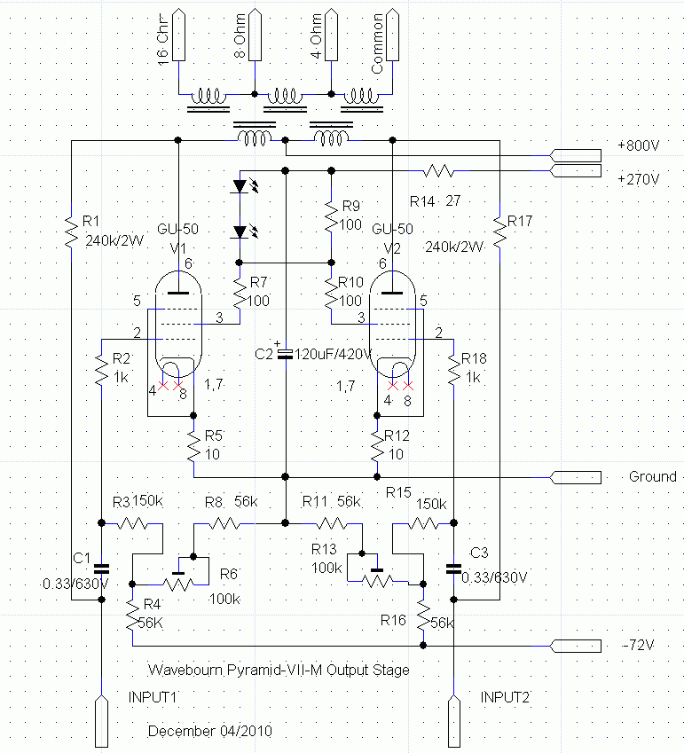

On the idea of keeping the Concertina in place, both Schade feedbacks (from output plates) could be implemented, I think. One S fdbk would be sent to the Concertina input (grid), and the other sent to the bottom of the Concertina cathode load resistor. Ie, that Schade feedback divider would have its low value resistor inserted under the Concertina cathode resistor to ground. The other Schade feedback (to the Concertina grid) would depend on the previous input tube's plate resistor for dividing down feedback. The Concertina plate resistor might need a little tweek to get the two Concertina output levels matched then. The Schade feedback resistors will have an apparent assymetry, due to the low resistance needed in the Concertina cathode circuit, versus the high resistance needed in the C grid circuit. But functionally, they both provide the same attenuation ratio of the two feedbacks.
This would have the advantage of using both Schade feedbacks from the output tube plates equally, no feedback having to pass through the OT then (as for the single fdbk to the Concertina grid case), so OT xfmr frequency anomalies would be kept out of the loops. Seems workable, anyone see problems?
Edit: I think I see a minor issue that can be fixed. The small value feedback divider resistor placed below the Concertina cathode load is effectively adding in additional neg. feedback to that output side due to its series connection. (beside the required neg. fdbk to the Concertina grid-cathode V diff.). This can be fixed by increasing the Schade fdbk attenuation a little (ie, raising the Schade feedback resistor value on that side) so the net neg. fdbk is equal for both Concertina outputs. Experiments probably required. (or Sim. it)

The approach I suggested in posts #8 and #9 above does not appear to be workable to get equal neg. fdbk on both outputs using the Concertina splitter with the 2nd Schade network inserted under the Concertina cathode load resistor. (1st Schade to the Concertina grid)
Just putting in some numbers illustrates the problem. Say 25% signal is negatively fedback to the Concertina grid via Schading, so the input signal is reduced by 25%. So the Concertina current is reduced by 25% on both legs (75% remaining). Then adding an additional 25% Schade feedback to the bottom of the Concertina cathode load R reduces the Concertina current by another 25% (50% remaining). So the Concertina top load R has 50% signal remaining. The Concertina cathode just follows the grid input (being a follower) at 75% signal remaining.
The top Concertina load R could be increased by 1.5x to equalize the output signals, but that effectively increases the loop gain for the top. So one output will have more neg. feedback than the other. This might still sound OK, putting a little SE sound signature into the amplifier, but it is not going to give bog standard P-P results.
I tried some other configurations with the Concertina and Schading but could not get any others to work even this well. Only the single Schade feedback to the Concertina grid gives equal feedbacks to both splitter outputs.
Well, one could put the current mirror into the top of the Concertina to get equal feedbacks using the Schades to the Concertina grid and it's bottom load R as above. But it's the mirror that is doing the copying/inverting then, the Concertina just serving to combine the Schades with no gain. A bit silly.

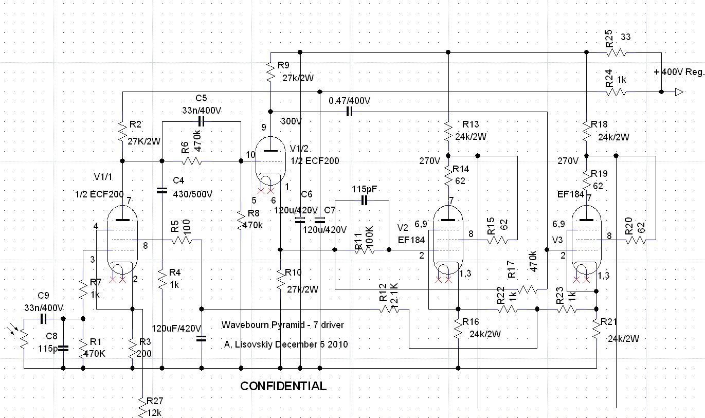

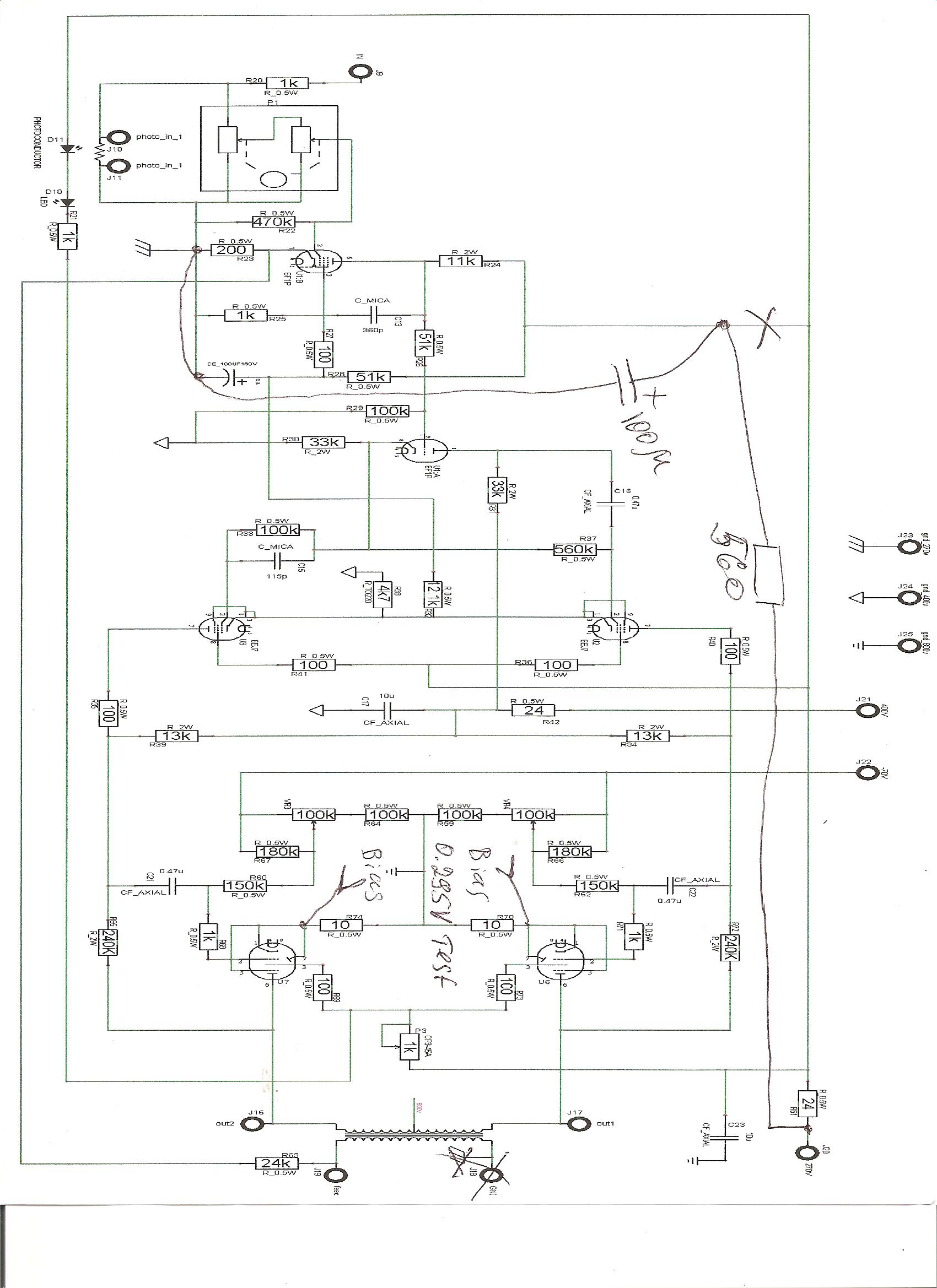

As you can see from my previous post, putting LTP after Concertina solves the problem.
Hmm.. I puzzled this out about a year ago and came to the conclusion that the plate feedback connection to the cathode resistor of the concertina doesn't provide any I/V feedback, i.e. it loads a cathode follower. It still provides I/V feedback to the top output of the concertina though. So the topology could be used with a single feedback connection in class A, but won't work for class B.
A resistive loaded concertina with followers doesn't have any feedback either. The followers need to be V/I converters (LTP idea...). After much tail chasing I put it away as not useful in the current context.
Anatoliy, your schematic is scaled down to small to read. Maybe I can download it or something.

Schade IMHO: is the transformation of high impedance Pentode
curves to lower impedance Triode curves, by local nfeedback.
I believe that is the perfect definition.
Hi Michael;
it is a thumbnail picture. Just click on it and get a big image that you can save.
A made a better drawing (attached)
