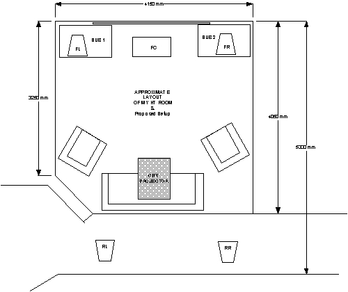

Below is the rough layout of my HT and dimensions etc.
(The speaker layout this hypothetical)
Unfortunately room shape is a PIA…..

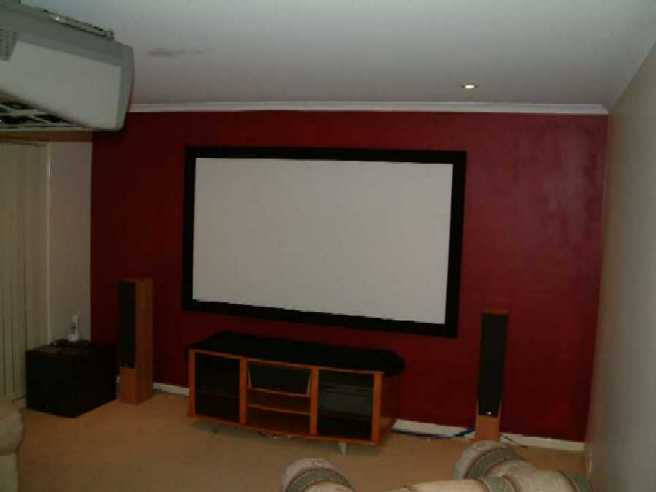

This is an old pic but this it is in real life
The current setup is ok but always leaves me wanting more

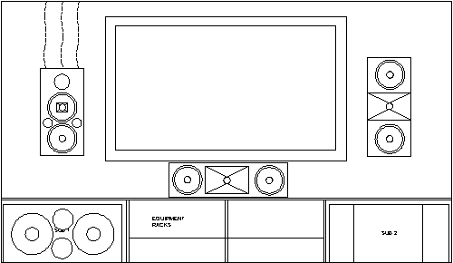

I’m thinking of a FOH layout something like the following:

TOP BOXES (5 off)
My surround decoder/processor (Technics SH-AC500D) has a function that selects if I have large or small speakers for each Front RFC and LR surround. Large is defined as capable of reproducing <100Hz small is not thus material <100Hz is sent to the Sub output
- Should I consider cabinets that will operate well at <100Hz or should I allow for my sub to carry the LF material from all the top boxes?
I’m considering a 2-ways passive system with HF horn and probably 2x 10” drivers.
-Any recommendations for top boxes, designs etc?
-2x10” drivers too big?

I would like to run 2 subs one either side of the screen.
