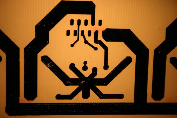

I used a plotter for plotting pcb's. I even made a web page for it some time ago here
Disadvantages are: sometimes the etched pcb came out with jagged edges, when covering larger area's the ink would sometimes etch away a little but that was probably due to the etch-resist pen i used.
All in all a not very satisfactory system. I switched to laser-toner-transfer but that gave more problems due to paper choice. And the jagged edges remained.
The accompanying foto shows the faults in larger ink-area's (pcb backlit with a lamp)

Audiowizard: all the light spots in the black (copper) bands are etched away right down to the epoxy, around those spots the copper is pretty thin so I discarded them.
