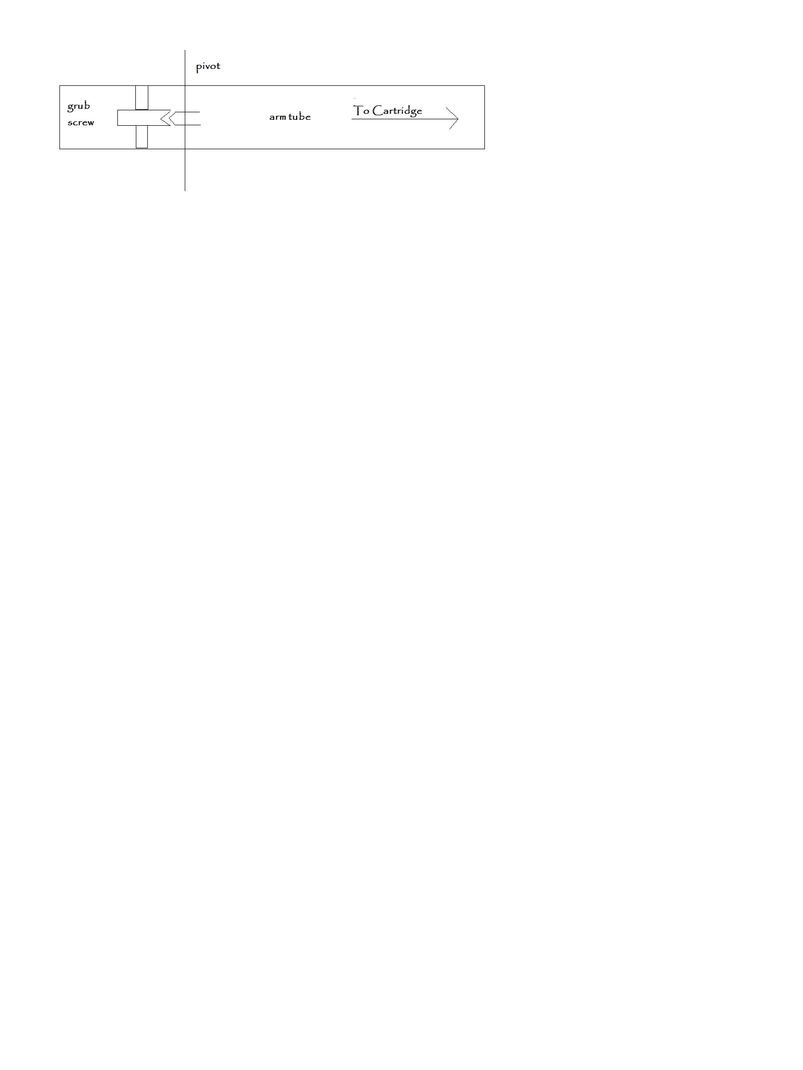

However when trying to remove the arm tube when the wires snapped I found a grub screw inside the rear of the arm tube, it was right back where the pivot point is, I fed an allen key up the inside of the arm tube and removed it thinking it would separate the arm tube at the pivot point , it didnt.
It didnt seem tight when I removed it and on closer inspection the end of the screw has a conical section milled into the end of it that a spigot type thing (pointy, conical) fits into, I have no idea what this was for but I assumed it was to locate the pivot bearings centrally in the arm tube, but I may be wrong.
Any idea what this might be for and how tight it needs to be? I dont want to over do it or even touch it until I know what it is for.

This is where the grub screw is located, anything beyond that I cannot see except the spike it locates onto.
The bearing through the pivot point only fixes to the arm on one side, with this taken out I still could not remove the arm tube so I left it there and decided to feed the wires through the whole thing instead.
No idea I'm afraid. Could it be for pre-loading the bearings in some way? This sounds unusual to me, and I think some "local knowledge" is in order.
