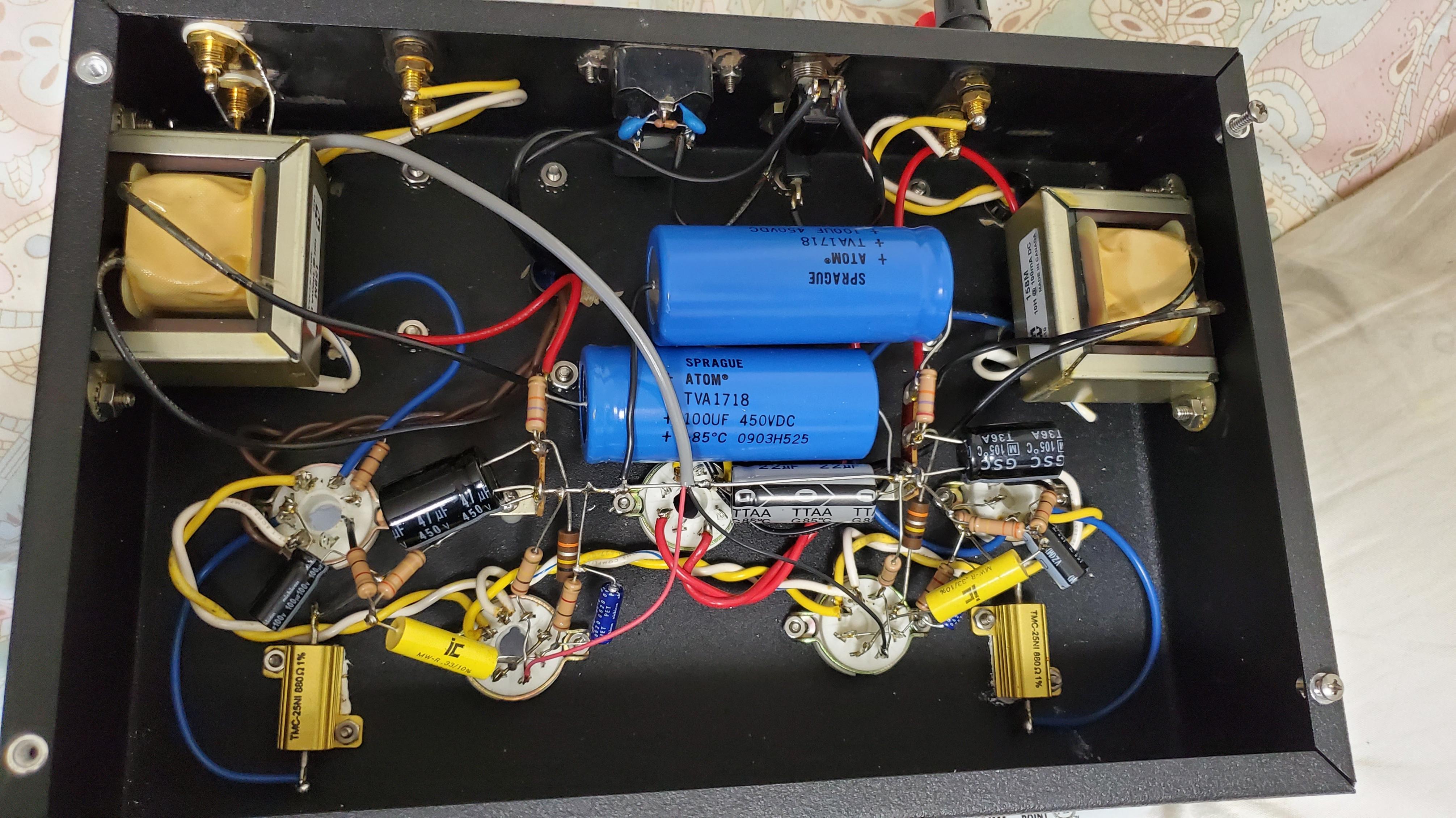

Thanks so much folks for the replies! I will try with that link. I did pop off the bottom to inspect for anything obvious (like a broken solder joint..etc) but everything appeared good to my Totally untrained eye. I guess the heater wire would be one of them on that socket? Is there a way I would know which one? THANKS again!

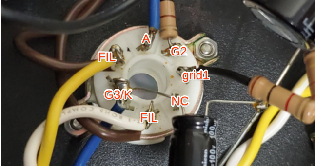

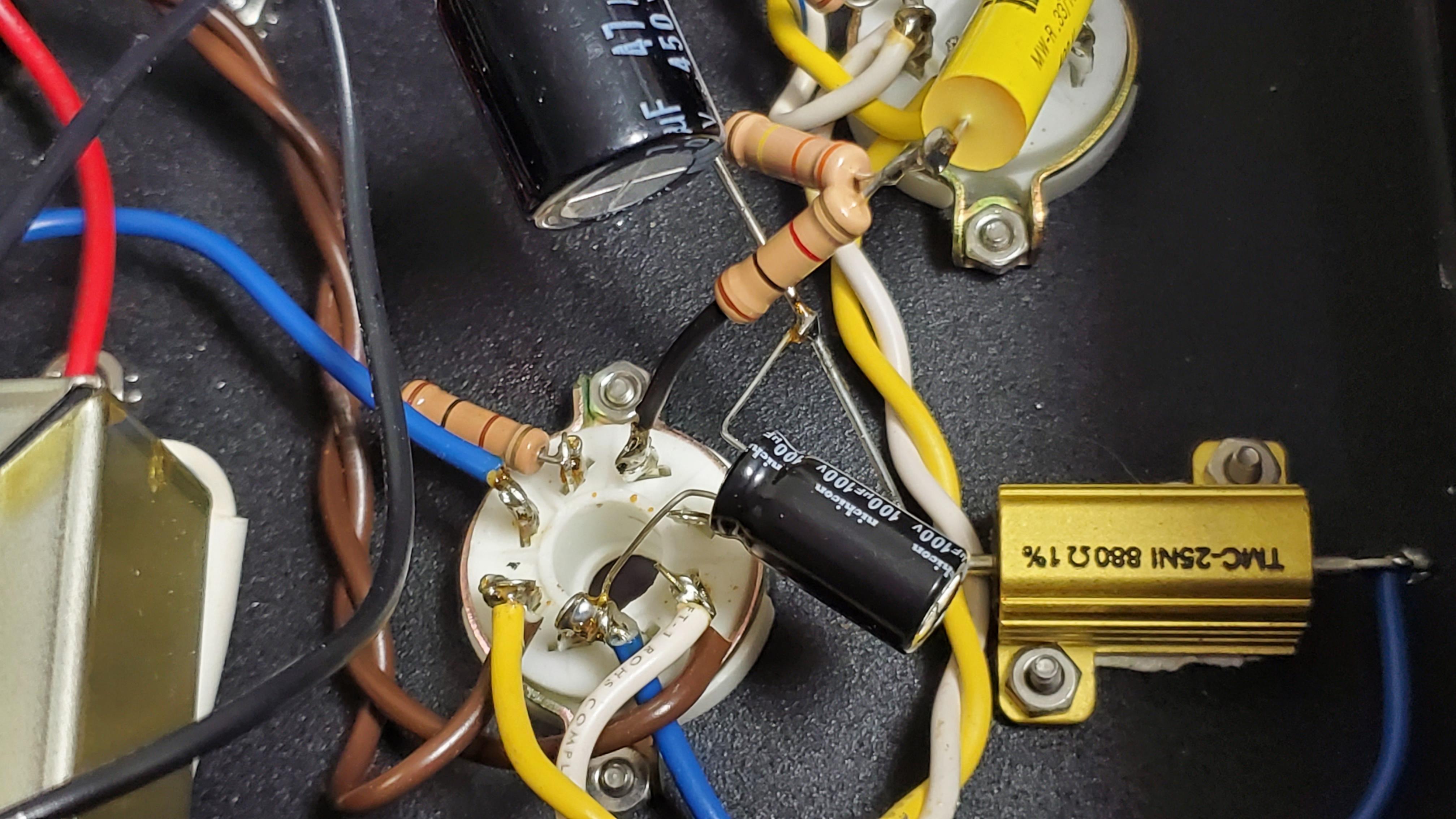

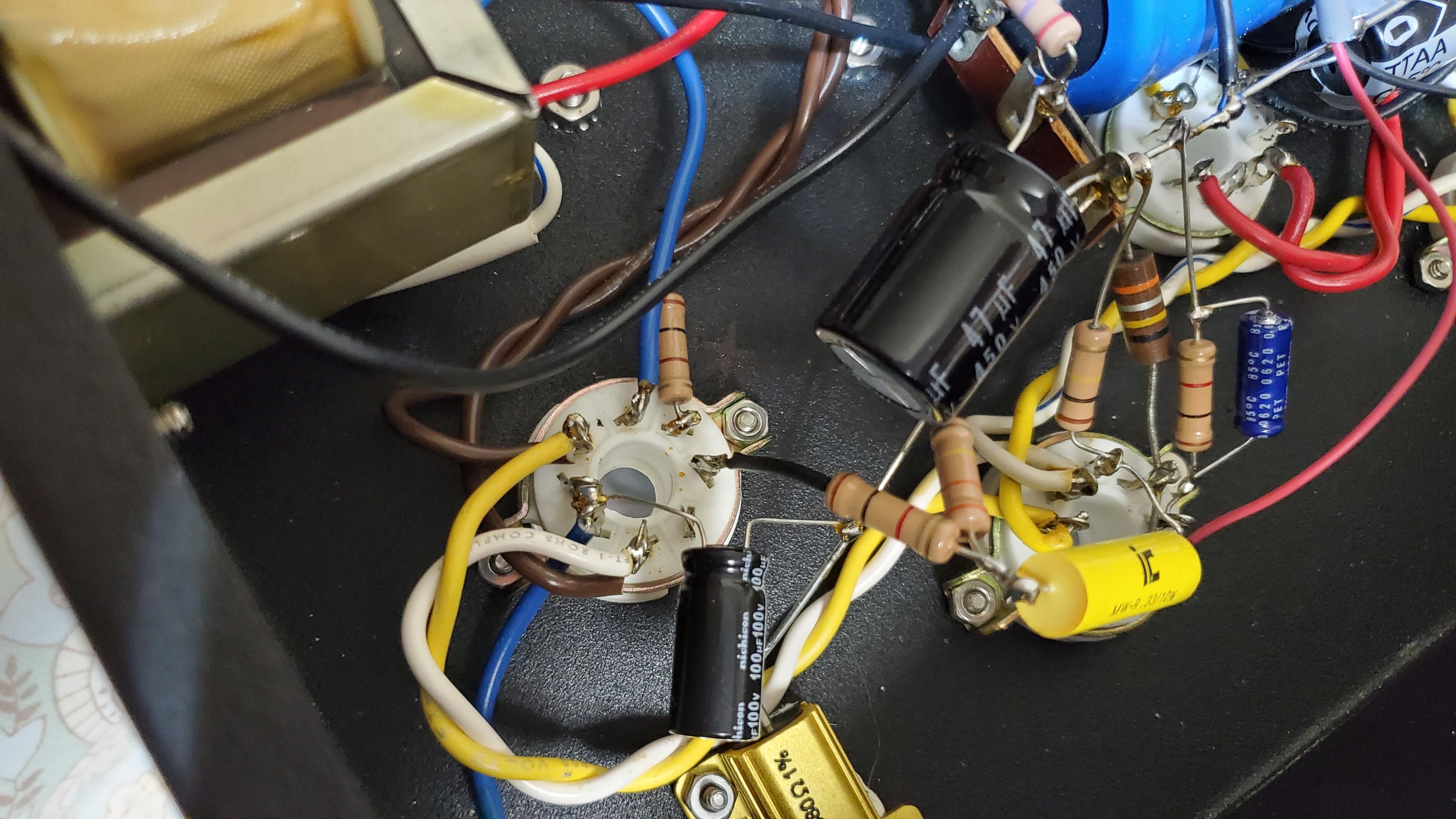

Hi Folks, I've been traveling and will try to get some pics up asap. The first thing I did was swap valves to no avail. In looking more closely there is one pin area with two heavy wires brown/yellow that looks like it may be the problem.? It is a little hard to know as some areas get discolored on the wires jacket from the heat soldering. Thanks so very much! Rob I'm having troubles getting the photo I wanted added 3, only one took the others that showed the most likely bad spot won't load...says invalid path. Working with Google photos
Hi, Does that socket look suspect in the second picture showing on Lingwendil's post? I guess I could try to find out how to get the proper socket (I guess it's called?) and practice soldering before hand and see how I fare...? The joint with the large brown and yellow wire looks kind of toasted? Thanks so much for any help! Rob
Honestly that just looks like rosin/flux residue. Nothing seems out of the ordinary. Maybe reflow each joint just to be safe, then scrub with alcohol to clean off any flux residue.
Where does the negative lead of that capacitor go? Too blurry to tell.

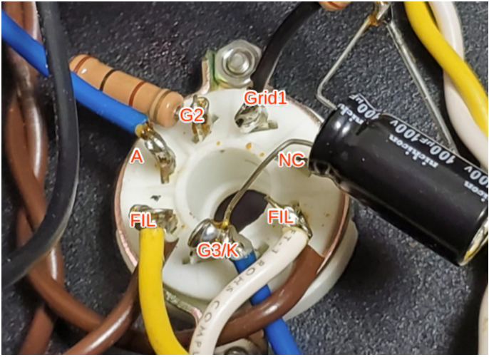

Alright, see if this helps you to tell what's going on.
"NC" means not connected in the picture.

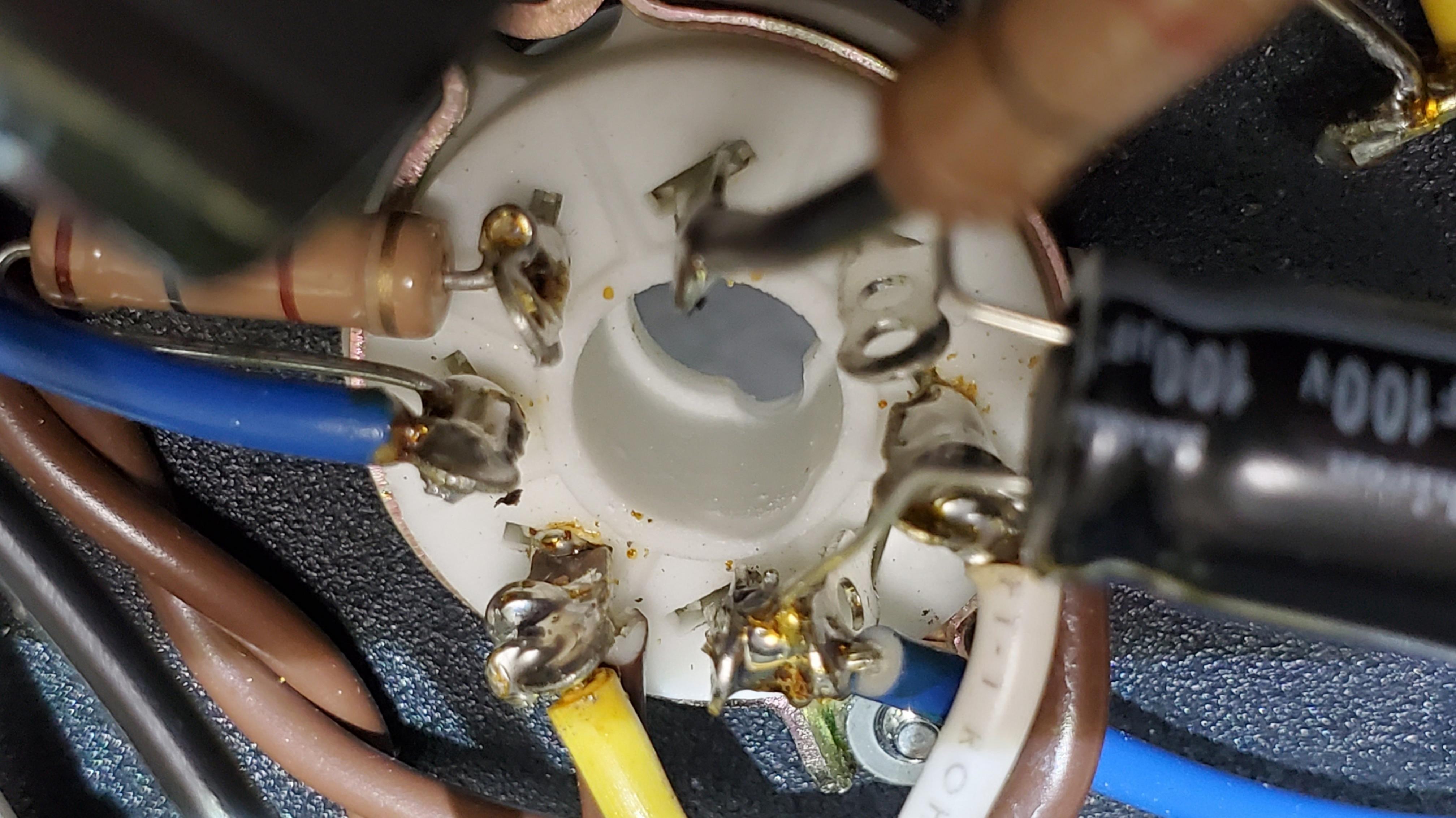

Verify that each of the connections is tight. Check that none of the wire insulation has receded from the end of the wire, leaving exposed sections that can short against anything, such as the socket frame, or chassis. Check the top of the sockets, and loo into the holes where each pin goes- verify there isn't any debris, loose or broken contacts, or broken metal.
Do you have a multimeter? If you can measure the voltage at each socket pin with the amplifier powered up this would be a huge help for troubleshooting. Jiggle the tube in it's socket between powerups to see if it loses connection, which could be from a faulty socket. Also measure voltage without the tubes inserted.
Does the problem follow the tube, or is it only with that socket?

Hi, Yes that is the only socket messing up all seems just fine otherwise. I so appreciate your trying to be so helpful, but since I have about no soldering skills yet, I just feel this needs to get to a tech to diagnose and repair as I am so limited on ability physically right now and time to pursue and practice up on soldering skills, and moreover I'm afraid I may cause more trouble than not... If anyone has someone you could point me towards that would be great! I am in SW Oregon. Have a wonderful holiday season, new year....and Happy Listening!
