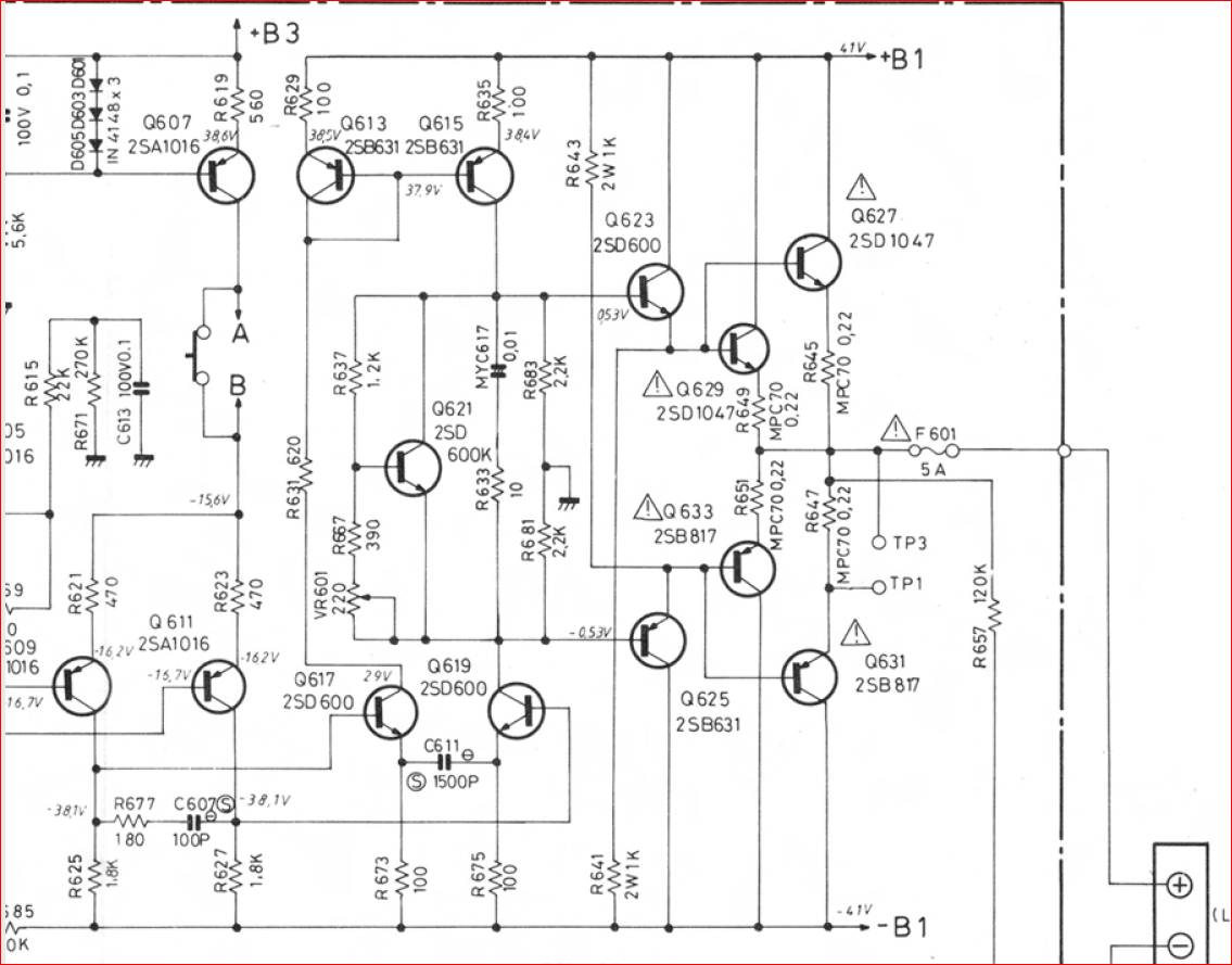

Just got this amp, noticed one of the power resistors on the output stage was toast. In the schematic it suggests 2W, so to make sure it didn't happen again, I ordered some 5W replacements, installed them, recalibrated as per service manual, but after about an hour of use, I noticed the amp could fry an egg on itself, I have nothing above the amp, so it has free airflow all around it, yet it is ridiculously hot.
Service manual suggests I should wait 5 minutes, then calibrate for 2.5mV between TP3&1 / TP4&2 and 0V between 1&E1 / 2&E2. I followed this, but the voltage continued to increase between test points, so I left it warming for about 30 minutes until it stabilised, then calibrated. Now after an hour of use it is working more like a heat generator than an amplifier. Sound doesn't appear to be affected in any way.

Here's a snip of the output stage. There are no relays, just 5A fuses.

It's simply a poor design choice for the output stage. Instead of those resistors, remove them and connect the emitters of the driver transistors (Q623, Q625 in the shown diagram) together with a 330 ohm 2W resistor. Re-set the bias accordingly. Bypass the resistor with a 470nF film capacitor if you're feeling fancy.

While I was recalibrating, my probe managed to push and short one of the pins of R647 against the exposed brass fin next to it carrying -41V (another poor design choice). A pop, a spark and a small amount of magic smoke escaped. There is no visible damage, but Q627 and Q631 directly in the path are likely to have had a load of negative voltage thrown at them. I've sourced replacements on ebay, hopefully they popped and opened circuit before anything else was damaged.

Hi Jaycee,It's simply a poor design choice for the output stage. Instead of those resistors, remove them and connect the emitters of the driver transistors (Q623, Q625 in the shown diagram) together with a 330 ohm 2W resistor. Re-set the bias accordingly. Bypass the resistor with a 470nF film capacitor if you're feeling fancy.
Would it be something like this (green circled)? And maybe the stock 2SB631/2SD600 (Ic 1A) drivers could be replaced with Toshiba's TTA/TTC004B (Ic 1.5A)?
That looks about right. I'm not sure about the TTA/TTC replacements, but if your original drivers have blown they would certainly seem to be a good choice.Hi Jaycee,
