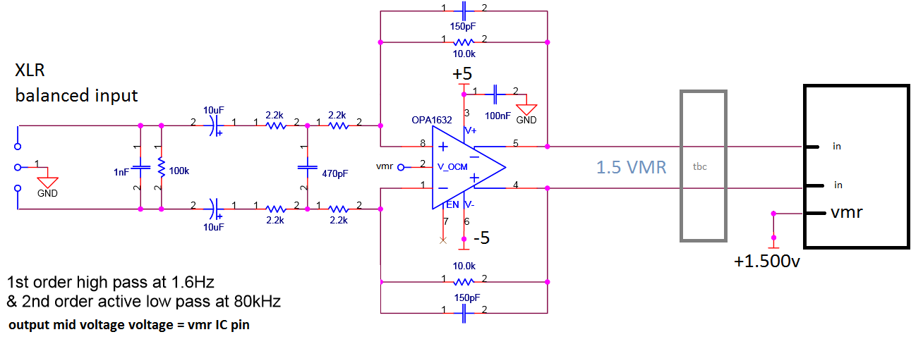

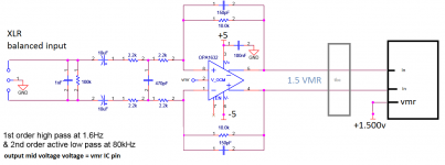

May I chime in. I have a design I'm working on. My XLR input choices are THA1200 or OPA1632. The output signal should be differential at 1.5v VMR to introduce into an IC amp. I'm also limited to a +/-5v supply. I noticed many re designs seem to use +/-15v. Is there any reason for this?
I have found some guidance in the TI EVM for the PCM4204, page 17. I'm not using the PCM, just spotted 1632 schematics.

reason for +/15V rails is the THAT chip will work at +20dBu pro levels, which is 22Vp-p
For a single ended CD player of 2V RMS you will get 5.6V p-p so if its to spec your rails should be ok. But depends on the source.
Thanks Bill. For example, my Meridian 568.2MM has analogue balanced outputs on the front three speakers. The specs say
3 x balanced outputs for left, right and center.
Outputs variable between 0 and 3.5Vrms, output impedance 47Ω
I don't really need to much higher, nor do I want to build a +/-15v supply as am using LP2985-50 for +5 from a 12v rail. Feed the output from the LM2985 into and LM2663 for -5v

With the THA1200 how do you get to 0 to 3 v (centered around VMR 1.5v) suitable for going into into a differential ADC chip? The datasheet talks about traditional vout but I can't figure out how that applies to an ADC front end for shifting level. Google didn't return any diy kits using THA1200 to ADC or similar. The OP1632 is looking more appealing at the moment.
3.5V RMS is nudging 5Vp-p so your rails are too low. Also needs some checking onto exactly how the meridian output is done.
For a differential DAC a differential op-amp might be a better option for you.
