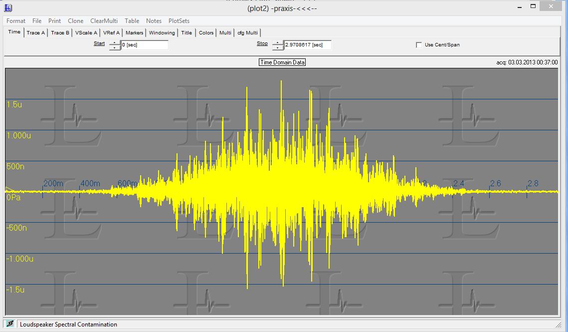

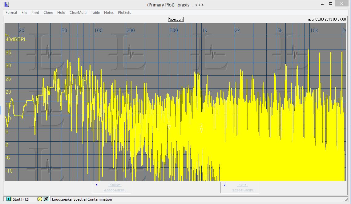

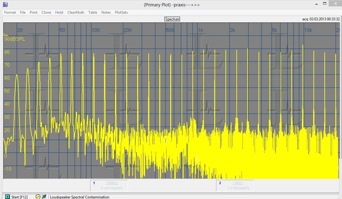

Here are the measurements of a good quality wideband driver and the distortion risidual to multitone stimulation as WAV.

Steven, no. As far as i can tell i am the only one that uses that method. I also helped Bill Waslo with his Distortion Isolation method. Actually i had the idea and Bill did the implementation. I also did the trouble shooting. Maybe this is something to wright up in Jans Linear Audio.
The scale is in Micro Pascal so the distortion is miniscule in absolute terms but quite anoying when you here the WAV. This is a very high quality speaker. Other distort more.
