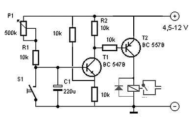

meanman1964 Member Joined 2006 2007-12-09 9:12 pm #1 2007-12-09 9:12 pm #1 Need a simple schematic of a time delay for a 12Volt relais Can I use this one for 12Volts? Attachments simpelerelaisvertraging.png 5.8 KB · Views: 107 ••• More options Share I_Forgot Member Joined 2005 2007-12-10 6:29 am #2 2007-12-10 6:29 am #2 That won't work. How do you want it to work- delay relay closure or opening or both? Delay starting when switch closes, opens, or when 12V supply is applied? How long do you want the delay to be? I_F ••• More options Share meanman1964 Member Joined 2006 2007-12-10 6:40 am #3 2007-12-10 6:40 am #3 When I'm applying power it need to close between 5 and 10 sec. What about this one or do you've one yourself? Attachments relais.gif 8.4 KB · Views: 86 ••• More options Share Nordic Member Joined 2005 users.tpg.com.au/users/gerskine/dxamp/ 2007-12-10 8:07 am #4 2007-12-10 8:07 am #4 http://www.diyaudio.com/forums/showthread.php?postid=1071625#post1071625 ••• More options Share G gmphadte Member Joined 2003 2007-12-11 4:51 am #5 2007-12-11 4:51 am #5 CD 4541 Download the datasheet and design one. It's very easy. Just add a power supply and a transistor to drive the relay. Difficult, then google for it. Gajanan Phadte ••• More options Share Show hidden low quality content Status This old topic is closed. If you want to reopen this topic, contact a moderator using the "Report Post" button. Share: Facebook Twitter Reddit Pinterest Tumblr WhatsApp Email Share Link
