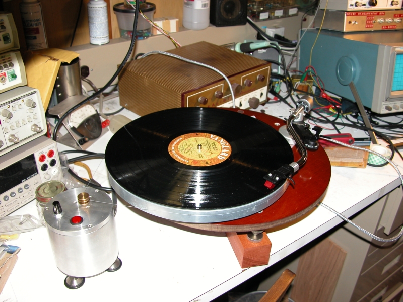

I have attached a couple of early pix of the TT I am using this to power which clearly show the unit in question and how I am using it..

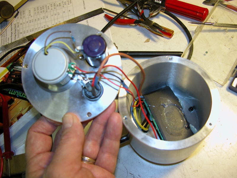

The motor is a DC affair with some simplistic internal servo. There is an external 450 ohm 10 T pot to adjust speed. There are two 100 ohm resistors soldered in series with the pot to restrict maximum speed - as I needed a higher top speed since I use a 12" platter I removed one of the two, and have confirmed that it now runs fast enough to attain the proper speeds at both 33 1/3 and 45 rpm. (by changing pulley step)
I would recommend changing the other resistor to 47 ohms were I to do this again, but since it does run slightly faster than the target speed it is good enough for this application.
Stupidly I did not really investigate much further.. There is a label on the motor which I only noticed in the photograph, and I did not measure the supply voltage either.
The supply is mounted in the bottom of the housing, and is covered by fish paper.. I believe this is nothing more than a line operated switcher, and there is a ground wire prominently visible bolted to the case. (Which given the general level of assembly quality is a good thing - use at your own risk!)
I would say most of the value in this unit is probably in the housing and pulley. I doubt the motor was very expensive, and the PSU is probably some OTS thing you can pick up for a few $..
No idea how durable this motor pod will turn out to be, it is certainly unsophisticated, but as I indicated works quite well. I use it casually though and it will get infrequent use so I expect it will last a while.

I just used my TimAudio motor attached to a VPI TNT super platter, the lead/delrin one that weights over 20 lbs, and the speed using the smaller pulley point was steady around 33.33 rpm overnight. I measured the speed with a strobe tachometer. I was actually surprised to see that first, it could turn the platter and second, that once the speed was adjusted, it stayed pretty true for a long time. Speed ranged from 33.32 to 33.4 which is only a .2% variance. Checked the speed variation over about a 10 minute time frame after being left on overnight.
not bad for $99.
I did find that there has to be minimal tension on the belt for this performance. If the belt tension is too tight, there is motor noise, a slow down in speed and more fluctuation. In fact, if it is too tight, the platter wont start turning at all without a push.
