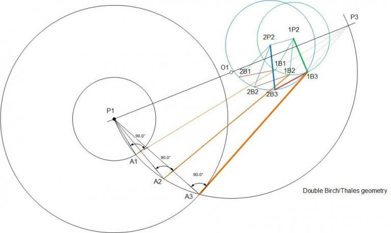

The twin arm geometry is from several years ago and is posted in the "Angling for 90 degrees" thread. All of the pivot points are string - there are no bearings anywhere. The rear control arm is string/magnet/attractor.

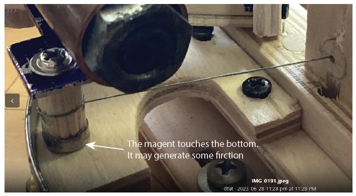

Ahem. Upon further inspection of the photos, I am increasingly sure that I didn't get the full impact of the design, and the idea of torsion being any issue, would likely be irrelevant given the limited amount of movement of any given string. But I want to understand another aspect more clearly. Can you explain string/magnet/attractor as used for the rear control arm? Thanks.
Further examining the back control mechanism, I have a suggestion for the construction of the magnet. From the picture, it seems that the bottom of the magnet touches the wooden plate under the magnet. The contact between the wooden plate and the magnet may produce unwanted friction.
It looks like the magnet is a pretty strong one. The friction between the magnet and the wooden plate may be neglectable. I would still suggest cutting a piece of half-moon-shaped plastic or metal to glue under the path of the magnet to reduce friction. Another option is to make the magnet suspend 3 mm or even higher above the wooden plate while the side of the magnet is lined up with the curved steel rail. There will be no friction between the magnet and the wooden plate.

The magnet just clears both the metal attractor and the wood but not by much. There are lots of moving parts in a small space so there isn’t much room for adjustments. For instance, if the attractor was raised, it would foul the bottom of the swing arm. I used a lot of parts that were around my shop or appropriated from other uses. The magnet was available and the attractor is the lip of a coffee can that just happened to have about the right radius. There are better magnet arrangements, I’m not particularly proud of this one, but mounted the way it is means it doesn’t pull too hard and it aligns easily.
The string and magnet idea came from Frank Schroeder and I’m pleased that it works well. As the arm crosses a record, the forces on the string and magnet are a combination of outward and tangent to the attractor arc so the string is tensioned. When the arm is lifted and returned to it’s rest position, the outward force reverses, turns inward, so care is needed.

I really don’t want to wade into the skating swamp, but I did Ray’s string skating test and the arm moved inward which I expected because that was true of other PLTs I’ve built. Jim, I argued with Ray for years based on the Birch virtual pivot, but then I tried a different approach: I drew lines from the inner and outer bearings of the swing arm through the stylus point. The resulting angle is the offset, which gets smaller across the record, and the skating force follows Alighiszem’s blue line. Carlo did a more complete analysis and came to the same conclusion.

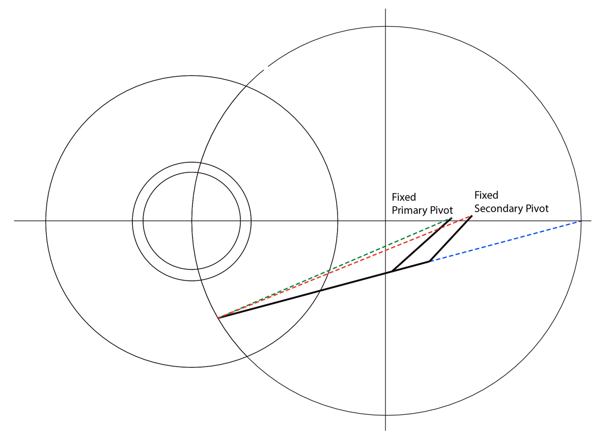

Speaking of Alighiszem’s calculation of skating force, I have asked him which pivot he used to do such a calculation. But I get no answer. For a Birch-style arm, there is the primary pivot, 2P2, secondary pivot 1P2, and virtual pivot P3, as I named it.
Which pivot did he use to calculate the skating force of a Birch-style arm? I get no answer. I don't believe his calculation is valid since he doesn't have enough understanding about Birch-style arms.

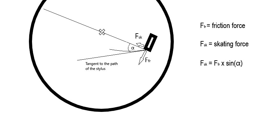

I wrote for instance that the Birch tonearm rotates around the center of the Thales circle. Do you understand that? You got your answer!
The stylus is moving on the Thales circle.
The stylus of a traditional toenarm is moving on a circle too. Same rules apply.

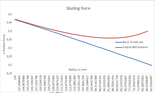

Your "virtual pivot" is so virtual that nothing rotates around it. It is significant in only one sense: the centerline of the catridge must go through it.
The auxiliary arms with "primary" and "secondary" pivots provide just that, but they do not have any role in the play of forces on the stylus.
The forces acting on the stylus are determined only by the friction force and the fact that the stylus moves on a Thales circle. The formula for the skating force is the same as for a traditional tonearm:

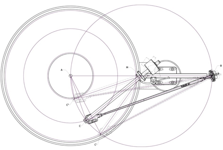

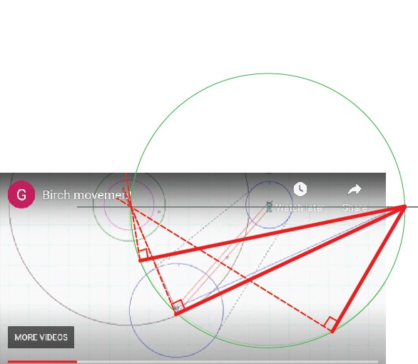

The video is not showing Birch-style arm movements at all. It merely shows the characters of Thales circle.
If I use the regular term, the thick red lines are the effective length of a tonearm. Its length changes. It is NOT a Birch-style tonearm. If you insist to find a tonearm based on such movements, it is an early Thales tonearm.
A Birch-style tonearm is different although Birch-style tonearm utilities Thales circle as well.
