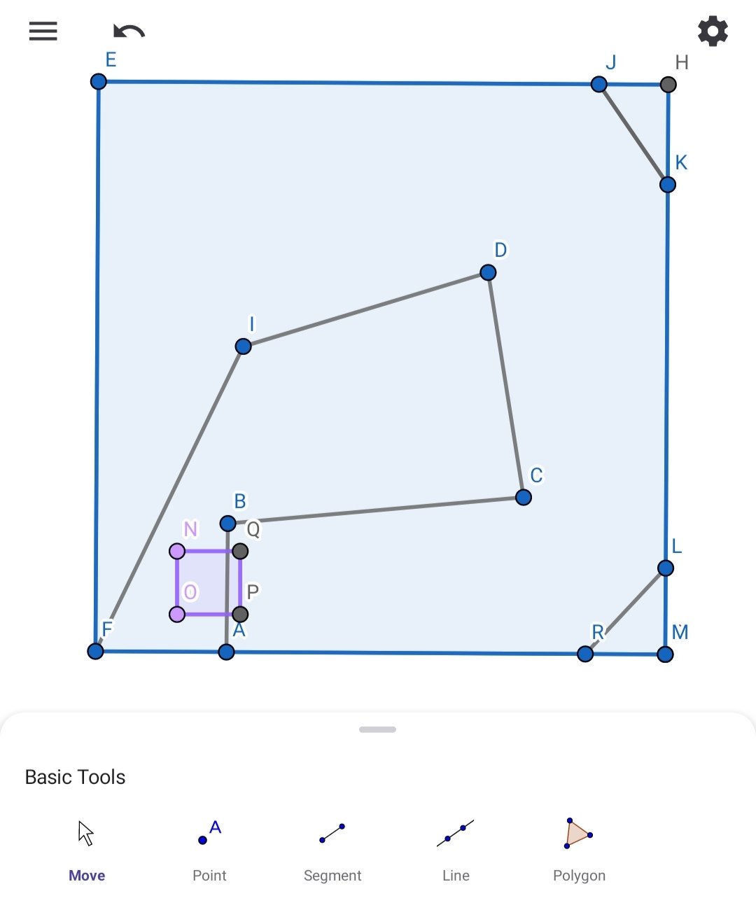

Depending on the box size, using drivers in a row and situated in this topology, is quite a bad idea. If we were after tight bass the fastest way, I'd start with larger driver in a closed box.
I like the idea of the back chamber that goes ahead of the speaker.
Indeed I 'd keep only the first segment of the horn. You've already reached the double gain from pi reduction ( the power sphere...) so why go further...?;
A slob-tunnel-horn, most a 6th order bandpass if you put some vents, a turbo mega-cylindro- vent.

Thank you all for your elucidations. Yes, of course I don't expect 20 Hz to kick hehe, but I was exaggerating a bit to get my point across of what I'm aiming for. Yes, lets discuss amps later, but a relatively inexpensive crown amp will drive excellently just about anything and for low volumes I can experiment with whatever else I have currently. But there's more to the story than distortion and damping factor, but that's irrelevant right now. And I don't want to rock the boat too much, so that those who could actually help don't get mad at me haha.
As for the length I will have to be satisfied with nothing longer than 1/4 of 30 or 40Hz probably. Even that sounds pretty damn long. I just want to reasonably experiment as close to what I want as possible, not just build the most perfect thing without any compromises or corners cut at the very first try. 30 to 120 Hz frequencies would be the most important for this project.
30Hz is ugly big, indeed. You can get there if you cut some corners and make it into hybrid, but no free lunch. Less efficiency, risk of chuffing and air compression. Been there, done that. If you want to go compact though, then arguably good BR with oversized driver in small box can give you most SPL density with very good parameters. Undertuned, overdamped. Been there. Actually, still being there because for compact designs it worked really nice for me.
You could use the classic Karlson 15 inch cabinet developed in the summer of 1951 for "kick" then a 1/4 wave tapped pipe down to say 30Hz which would add weight to theatre organ and synth recordings. Also - ask some of the PA guys including BFM and CUBO what they would do. How large is your room?
2--4 good 15" per side in a proper reflex box would not be shabby and since you intend to use some power, run them ~ 6th order with Q=2/6dB boost at tuning with an underdamped 2nd order highpass filter to keep the LF crap from wasting excursion.

I would rather have a huge unmanageable box than a tapped horn I think.
Instead of your solution freddi, I'd rather build a BR box like crashpc suggested and shelve the idea until insane huge boxes and substantial expenditures are neither of consequence. However if it can still be put into something like a Forester... I don't know, maybe I don't need super low frequency for the first pancake, but it's the horny sound that I wanted, so if something more compact can deliver the desired speed and tightness, only a bit higher in frequency, I'd like to experiment with that.
Intended space is an open area outdoors.
It seems due to gargantuan size, I will not be going for the folded horn bass solution this summer or spring, because mainly for the size, but I would have to cut too many corners and would eventually be getting only halfway where I actually want to go, so it wouldn't necessarily be worth the money, time and mental bandwidth to experiment and create everything under those circumstances. I am not abandoning the idea, but I would like to get as close to what's theoretically possible when I do decide to do it.
