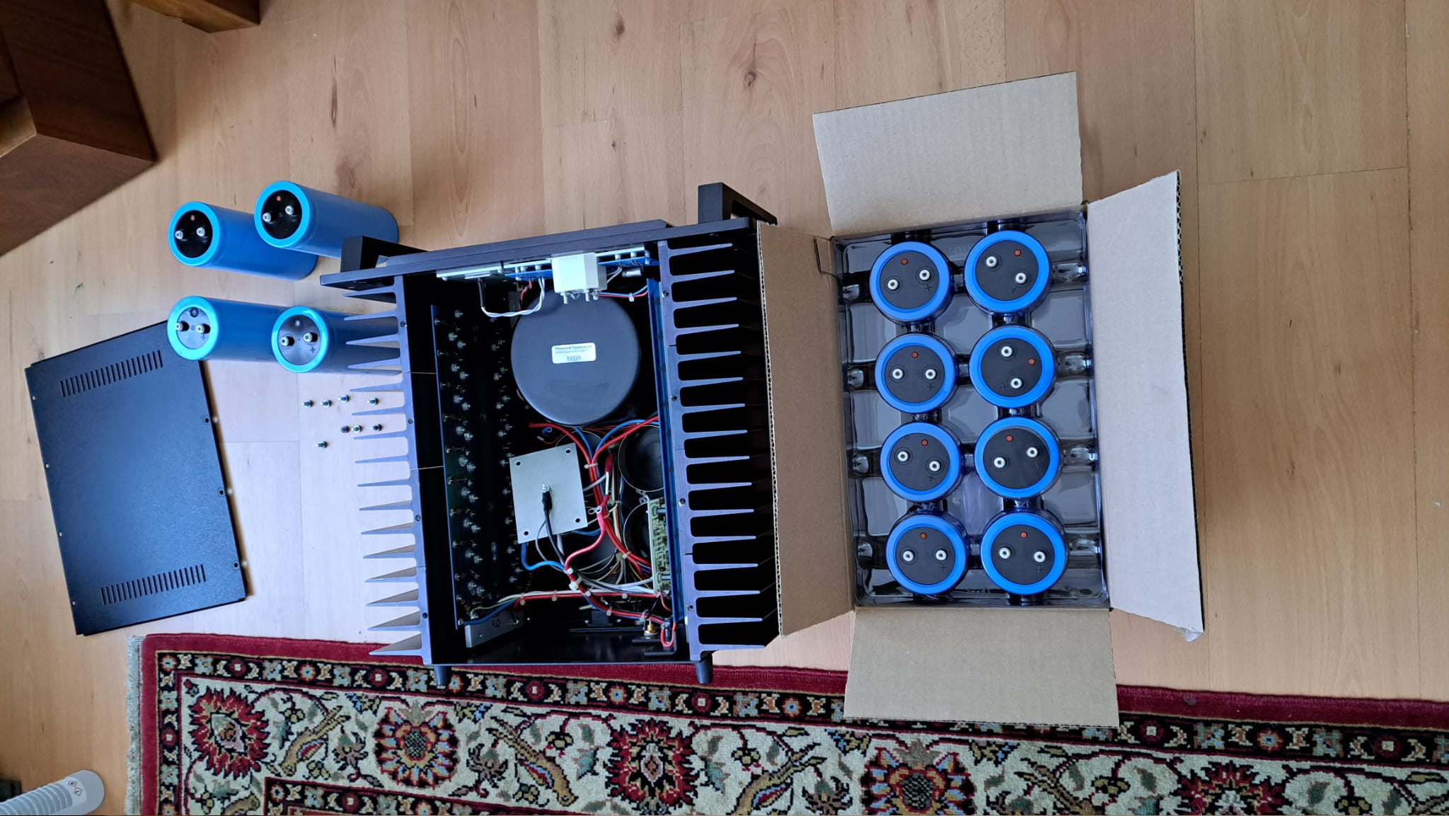

Just finished recapping my SA/1's with four CDE DCMC104M100DF2B 100,000uF, 100V from Digikey per chassis to replace the 39 year old Mallory's 29,000uF 80V.
They still have an inventory of those so all Threshold SA/1 - SA/2 - SA/3, S/200, S/300, S/500 and S/1000 owners can order fresh ones.
These were even lower in height than the old ones but fitted perfectly in the 3" clamps and the groundplate drilled holes.
Would the 100,000uF per can be a problem?
Although they were manufactured/shipped from the CDE factory this year to Digikey I still softstarted them within three hours from zero to 220 volts with a variac. I start the Thresholds always with a variac (but than in a few seconds ;-)) for minimal stress especially for the on/off Airpax circuitbreaker.

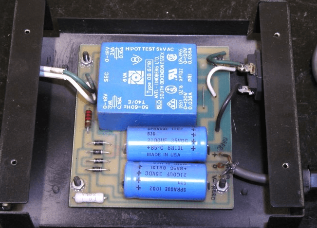

This is the original PSU for the First FET Ten HL
It has apparently a 6VA Toroid by Avel Lindberg and 2100uF for every rail.
The 'e' series, allegedly instigated by John Curl, has a 80VA toroid and 15000uF capacitance per rail.
I can get 10000uf 50Volts Vishay/Sprague 53D's that are 5000uF less than the original 'e' series per rail but still 7900uF more than the original PSU for the FET TEN HL. I'm reckoning 10,000uF is still more than enough but I could be wrong.

Hi Robert,
I updated a set of SA/1's to 4x 100mF back in late '21. They are running very well with that, but I also did include a soft start / inrush limit in each.
I was not completely happy with the hum/noise though - and this later turned out to be the GND lift resistors fitted on each input of the amps. These were two std. 1/4w resistors in parallel, and one set of these had increased to 1.5k - from 10ohm
Whether these were installed originally or added later in the life of the amp we do not know.
After that correction it is now dead quiet 😊
For the Spragues, consider the mains voltage tolerance of up to +/-10% ? this would be borderline and voltage actually has a high impact on capacitor life.
