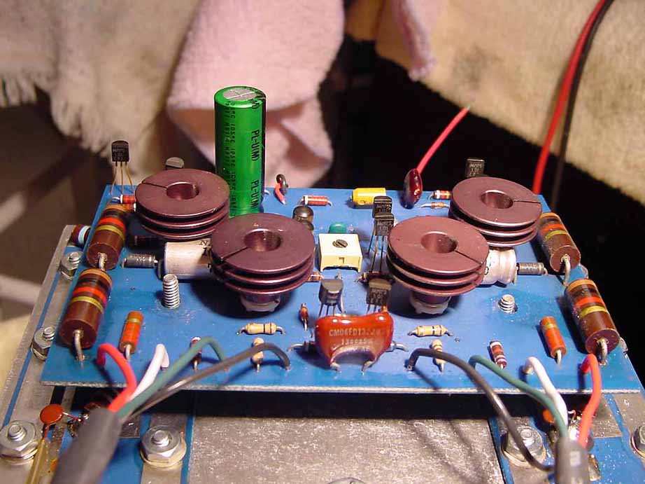

Greetings,
I am in the process of restoring a 400a which has an input board (pc400A 11-77) with the following transistors:
7 - MPS-L01 - hfe @ 100
1 - MPS-L51 - hfe=100
2 - 2N4250 - hfe=@100
2 - 2N5415 (with Heat Sink) - hfe= @75
2 - 2N3440 (with Heat Sink) - hfe= @75
The outputs are Class A8 and Class A6 and are fairly close in gain
(@150) except for a few with gains of only @50. Should I replace the ones with "low" gain?
I have read the posts about upgrade replacement devices, but would like to try to avoid that at least for the near term.
The schematic available here on this forum is quite different from the board I have and I would really appreciate any thoughts (or by some miracle - a schematic that's closer to what I have) on
how to proceed.
I have included a photo of the board here for those who are interested and will post a "foil-side" photo soon.
I also would like to replace the Bridge Rectifier with Fast Recovery Diodes (like FR405 series). Can someone tell me the best "Safe" parameters (current/voltage) for these?
As a certified Electronics Technician with 30 years of experience, I would like to put this back into service (in my own home) since I have heard many great comments on this design and it is my first encounter with a CLASS A Power amplifier.
Kind Regards,
Terry Keith
Columbus, OH

Re: Threshold 400A Repair
I don't know how you are getting your hfe figures, but if it's
with a portable in-circuit meter you should probably forget it.
The 4250's beta is usually around 300-500, and you want outputs
in the area of 100 at 1 amp, but it's not a big deal. In production
they were selected for higher than the 50 you're measuring,
and I would be surprised if they're that low. The devices were
2n5878 and 2n5876, and similar 4 mhz to3-s will work pretty
well.
In the version you show versus the schematics I have posted
the difference is mostly the a92's and a42's used in parallel
instead of the heftier 5415's and 3440's. Yours is the earlier
version. I recall that yours does not have the cascode input
diff pair as shown on the later schematic. The cascoding itself
was not a big deal, but it did allow the use of MPS6571's which
have very high gain (~500), but can't take the voltage.
Nowadays, you might be able to find a high gain 50V device to
use instead of the a42's.

Re: Re: Threshold 400A Repair
First of all, Thank You Mr. Pass for your response!
My gain checker is a Sencore TF46 Super Cricket Transistor/FET Tester. I have been doing out-of-circuit checks to get the gain figures I posted. I don't have a REAL curve tracer/hfe test rig, so I can't get actual beta readings under the operating conditions you mentioned.
I neglected to include the RCA1A15's and 1A16's (one each per input board) in my initial post, which tested OK with gains like the 2n3440 and 2n5415 pair.
I went through both input boards and replaced the MPS-L01/51's with matched MPS-L01/51's of similar gains.
The only difference between the Left and Right channel assemblies now is R48, 49, 50 and 51 (R48 in Parallel with R50, R49 in Parallel with R51). Left channel has 3-ohm, 1-watt Carbon Comp resistors, Right channel has 1-ohm, 1-watt Metal Oxides.
Which is best?
I was able to download a schematic and components list that Sulky had posted some time ago that pretty closely matches what I have (thanks Sulky!!), so I'm good on that front.
I only have a few questions left now:
Biasing -
1. I know you mentioned the 5-second touch rule for setting the proper bias, but is there a measurement I can make to set it a bit more accurately?
2. Should I set the pot to mid-range and go from there?
Power Supply -
1. What voltage/current ratings should I use if I replace the Bridge Rectifier with Fast Recovery Diodes?
2. I want to replace the 7800uF 75VDC Caps with 35,000uF 80VDC caps of the same physical size. If I add an inrush current limiting device in line with the mains fuse, could it cause problems?
Input Coupling Capacitor -
1. Current cap is 4.7 uF 25V Tantalum. Is there a better choice?
Thanks again for your help!
Terry Keith
Columbus, OHIO
Just spent the weekend listening to the 400A this forum helped me to restore. AWESOME.
This is my first CLASS A power amp and it is a TOTAL PLEASURE to listen to.
This unit was rescued from a mixed-metal recycling dumpster in California and suffered severe exterior physical abuse (See photos below).
As a tribute to Mr. Pass's heavy duty construction, the INTERNAL components were in GREAT shape!
With the information and schematics posted here and kind assistance from Mr. Pass, this Phoenix rose again!
I will post pictures of the restored amp later.

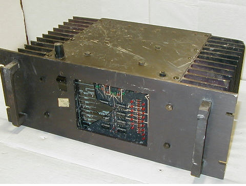

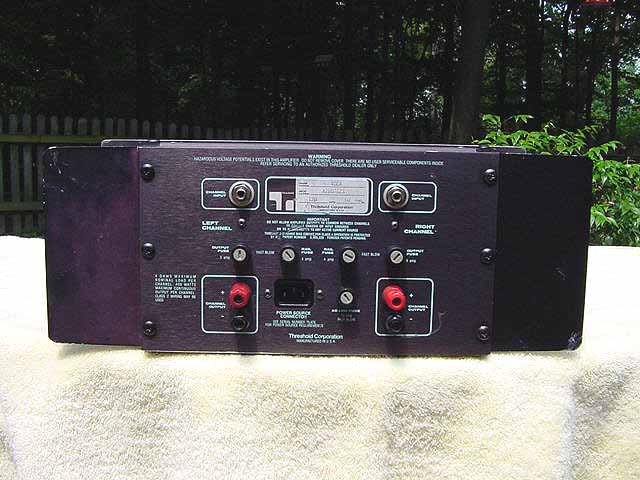

Mangled 400A

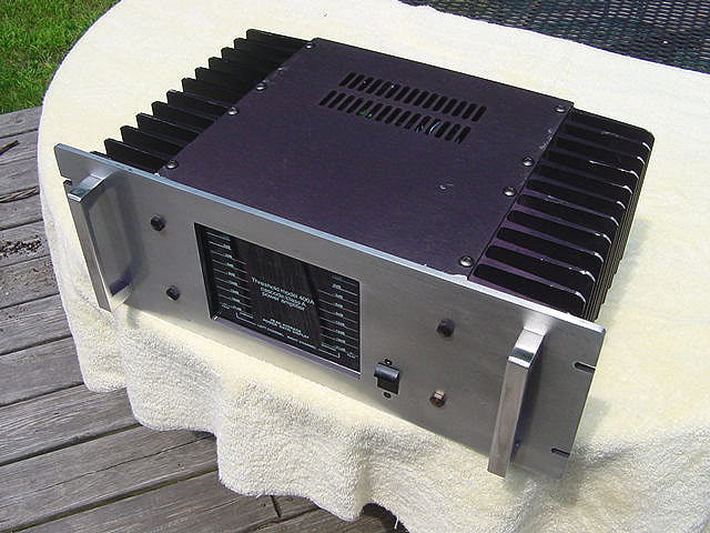

For those who are interested, here is an external photo of the restored Threshold 400A unit I previously mentioned.
First of all, this amp was nasty inside and out. I completely disassembled the amp modules (the entire amplifier, actually) and checked every component, replacing those which were out of tolerance or likely to fail over time. All cabinet metal surfaces were washed and cleaned and buffed up and all of the hardware was too.
I did a lot of work on the front panel and handles and miraculously found a brand new replacement plexiglass front window (for the LED meters) from Threshold in Texas
(it was the last one they had).
I replaced the speaker binding posts and straightened
(as much as possible) the heat sink fins.
Internally, I ran new copper hookup and input wiring and upgraded the 9800uF 75V power supply caps to 35,000uF 80V units of the same physical size.
I'm still interested in upgrading the Bridge Rectifier to a discrete or Modular FRED bridge, so if anyone knows the current and voltage ratings I should use, that information would be appreciated.
Thanks again to those (especially Mr. Pass) who provided the
information I needed to be able to enjoy this unit's power and grace as I have over the past few weeks!
Best regards,
Terry Keith
"Pass A" convert
