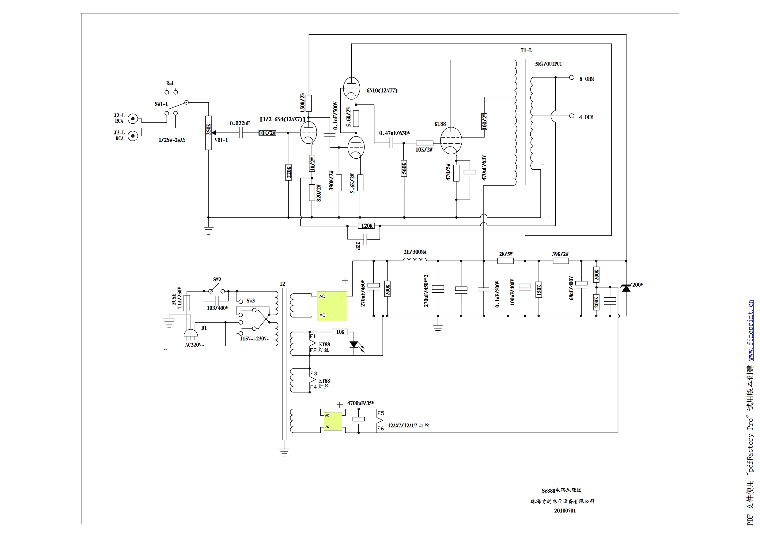

For now I have parked my scratch build project as it really seems the bits I have are not going to play nice together. In the mean time I bought a Sepparo SE88I single ended KT88 amp that had been "improved" by the previous owner. It was not a happy amp when it arrived it took a while to get working as it had taken a bash in the post. The improvements consisted of removing the feedback connections, an attempt to make it triode mode by cutting off the connection from the transformer and linking the plate to the ultralinear tap via a 100 ohm resistor. The coupling caps had also been replaced with some indeterminate value Russian PIO for the first stage and output and a posh looking silver in oil between first stage and driver. when I got it running it was loud and harsh. I replaced the feedback link and that made it quieter but more obviously distorted in the vocal range particularly. So I decided to go back to the original scheme and replaced the Russian caps with some commercial grade polyester and put the silver in oil between drivers and KT88. Now it sounds OK if unexciting and a little lacking in fine detail. My thoughts are to see if I can turn this into a test bed amp. I could provide switched alternative values for the feedback, switch between ultralinear and triode and possibly (with some help!) a switched bias so I could swap the power valves for EL34 which I have a few of. Apart from that I am open to suggestions as to what could be usefully changed in the original schematic that might make interesting changes to the sound characteristics.

If that is the circuit, I am not impressed. Surely the drive to the output stage should be from the anode of the driver, not from the other end of the bias resistor? Why is the cathode resistor such a high value? Is it biased as class B? A 2Watt resistor in the grid to ground of the driver valve ... is there that much grid current to lose? Looks like a first year apprentice designed it.
The output valve should be biased, in single ended, at 70% of load. Possibly a 220R resistor in the cathode would be useful.

Thanks for the helpful comments. Should I replace the 470 ohm resistor or just parallel another resistor to get to 220 ohm ? Is the cap value still OK or does that need changing too? How about the coupling between drive and output. Should I move that to the anode of that side of the driver valve?
Is the capacitor on the input to the first stage necessary? Is the value of 0.022uF OK to make sure I don't lose any Frequency response in the audio range?

Should I move that to the anode of that side of the driver valve?.......It appears to be an SRPP.
It is a standard SRPP circuit and is correct as shown. Moving the resistor will nullify the "advantages" of the circuit. The SRPP was in vogue among the "audio illuminati" about 10 years ago. It has fallen out of favor now that better designs exist, but it can still deliver respectable performance. An SRPP with a 12AU7......wouldn't be my favorite choice, but I have never tried it.
The SRPP is a compound circuit. The bottom tube is a typical common cathode voltage amp, while the top tube bootstraps the plate load to improve distortion and gain. The top tube also acts as a cathode follower to buffer the load. For the circuit to work "right" the cathode resistors for each tube should be the same value. "Experts" disagree on whether the bottom resistor should be bypassed. It is usually not bypassed.....as in this design.
Yep, no electrical reason for that....but maybe the original designer had a large pile of them, or maybe that's the only non inductive resistor he could get.
560K for the grid resistor is way over spec for a KT88. The original Genalex spec calls for 220K in cathode bias. Modern new production usually benefits from an even lower value to prevent runaway, but this sacrifices gain, so it is commonly ignored. Tube runaway near end of tube life is the common result.
Possibly a 220R resistor in the cathode would be useful. Should I replace the 470 ohm resistor or just parallel another resistor to get to 220 ohm ?
There is no way to know what size cathode resistor to use in this circuit without knowing the B+ voltage. It would also be prudent to measure the voltage across the existing resistor to determine the current before blindly swapping parts.
The SSE runs a 560 ohm resistor and that puts the KT88 near the upper limit on a 430 volt supply. I have a 470 ohm resistor in mine and I am running 100mA on 430 volts. That puts the dissipation in the KT88 at 38 watts. A 220 ohm would melt the tube in an amp with 430 volts of B+, but may be OK if the B+ was really low.
Raising the current through the tube could increase distortion due to saturation, or even damage the OPT if it is undersized. I don't know this amp, but many Chinese designs skimp on the OPT.
The cap is not necessary, but may help reduce noise with cheap pots and input tubes that draw some grid current due to internal gas. It can probably be eliminated here.

Thanks for the replies folks. Here are some values from the amp.
B+ to output transformer 388V
supply to 12AU7 204V
supply to12AX7 204V
drop across 470R cathode bias resistor for KT88 34.5V current =73ma =26W
If I have that right I should be able to reduce the 470R
Am I right:)
Yes. Depending on the KT88 you can go up to 32 watts, maybe higher. I have Electro Harmonix KT88's in my amp. They are about 6 years old and have been running at 38 watts for most of that time.
Increasing the current will not usually result in a significant power increase, but will boost the damping factor and possibly lower the distortion. The added damping factor can improve the bass quality on some speakers.
You can increase the current by adding a resistor in parallel with the 470 ohm that is already there. I put some alligator clips on the wires of some 1.5K and 2.2K 2 watt resistors. I just clip one or both across the 470 ohm when I want the increased current.
