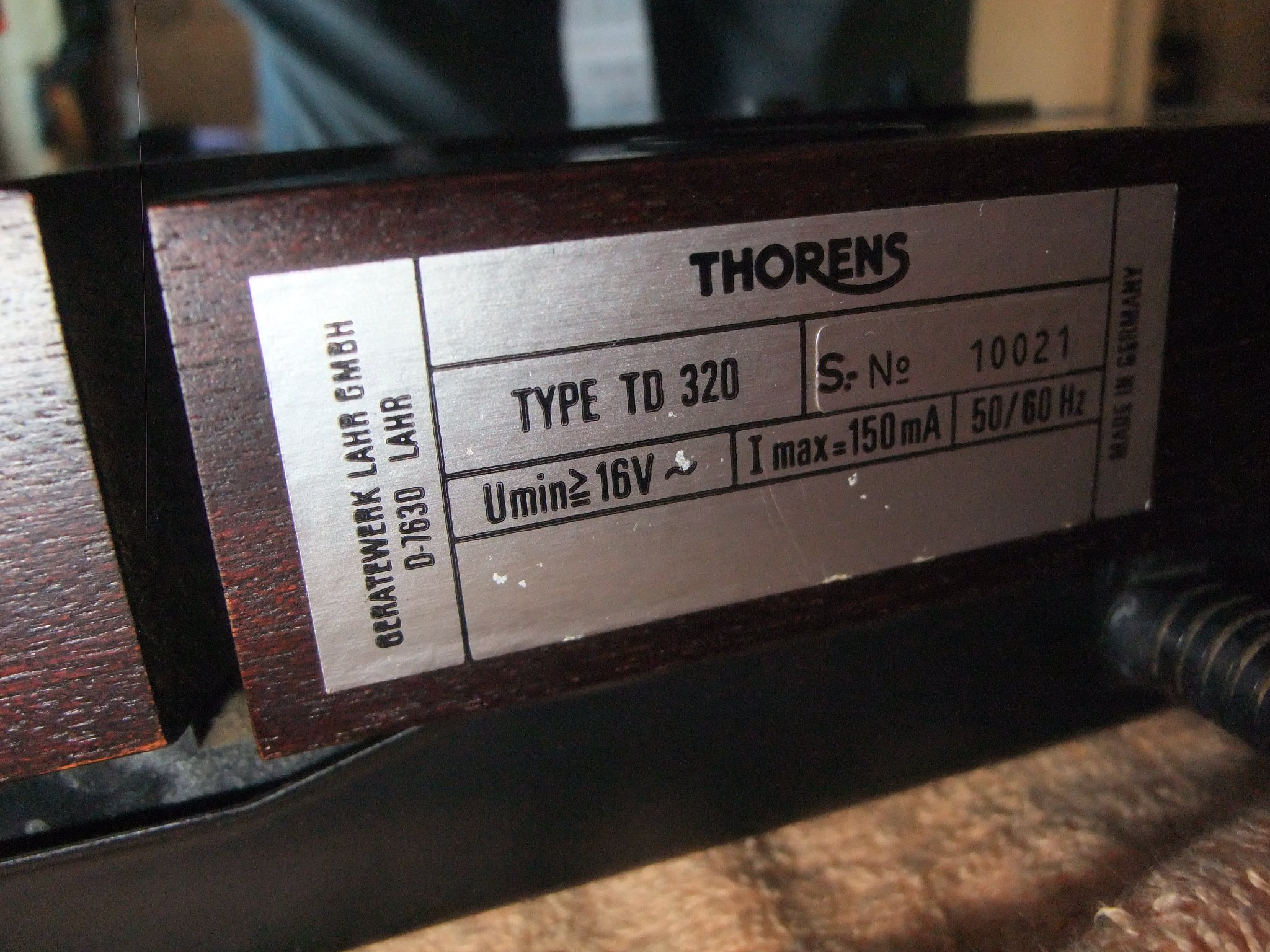

I just got a TD 320 with no wall wart. I have been unable to find a stick replacement on the internet. I was wondering if anyone knows the specs on this item. AC or DC, Voltage, amperage?
The wall wart (ac adaptor) looks like this from follow URL:
http://i.ebayimg.com/00/s/MTIwMFgxNjAw/z/2lEAAOSwBLlVewz1/$_3.JPG

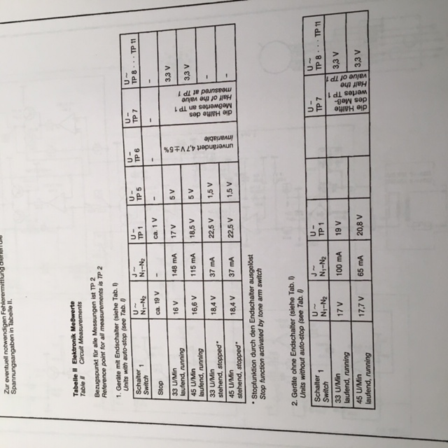

I have measured all voltages under the different modes (wall voltage was 233VAC).
1) off-mode: 18V6AC (same value also at disconnect AC plug)
2) ON, stop-mode: 18V0AC and 22V8DC behind rectifier
3) ON, play-mode: 16V5AC and 19V2DC behind rectifier (across the main capacitor 1000uF, 35V).

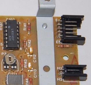

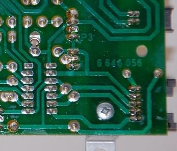

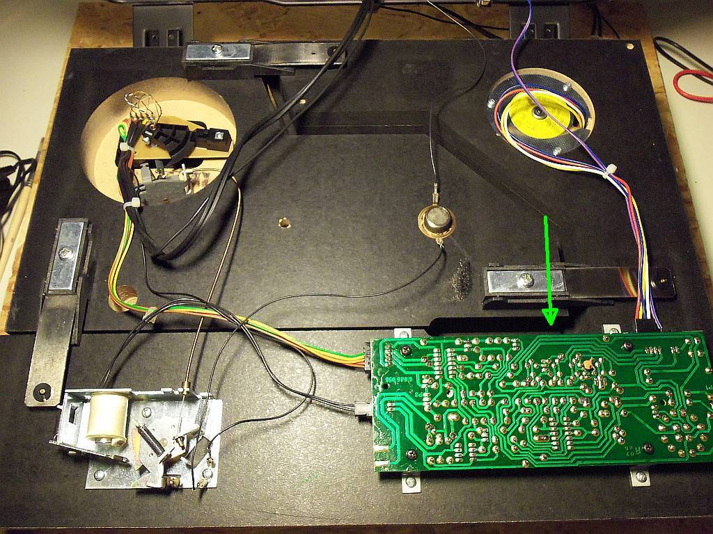

Now a question: For the motor control Unit No 214753 (PCB No 6 646 056) of the second version (Thorens TD320 MKII) I am looking for the schematic. This is different from the schematic of the first version - go to

I need it to find out the reason for a burnt resistor, which is connected between the GND for motor control and the signal GND - go to
http://new-hifi-classic.de/Gallery/albums/userpics/normal_img_5401.jpg
and
http://new-hifi-classic.de/Gallery/albums/userpics/normal_img_5402.jpg
Who can upload the wanted schematic diagram ?
And what ist the actually aim of this resistor, which is not present at TD320' first version
Thank you very much.

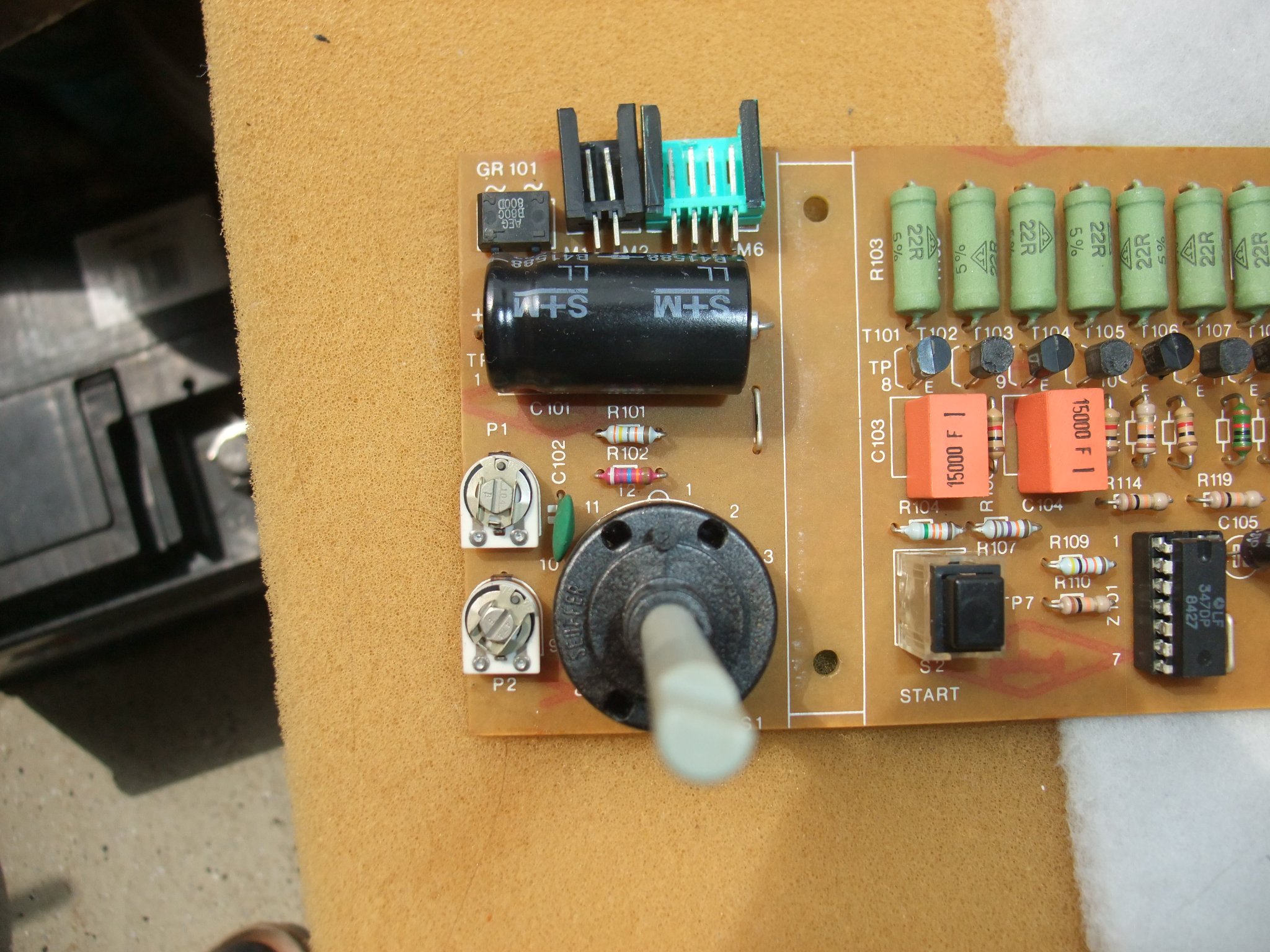

I’m curious if you ever figured out anything about this burnt resistor. I have the same pcb on my Thorens TD320 with the same burnt out resistor. I’m hoping I can replace it but I can’t find any information. I picked up this TT at a garage sale very cheap and in poor shape, but I like a challenge. Any help would be appreciated.
The resistor looks to be 100R.

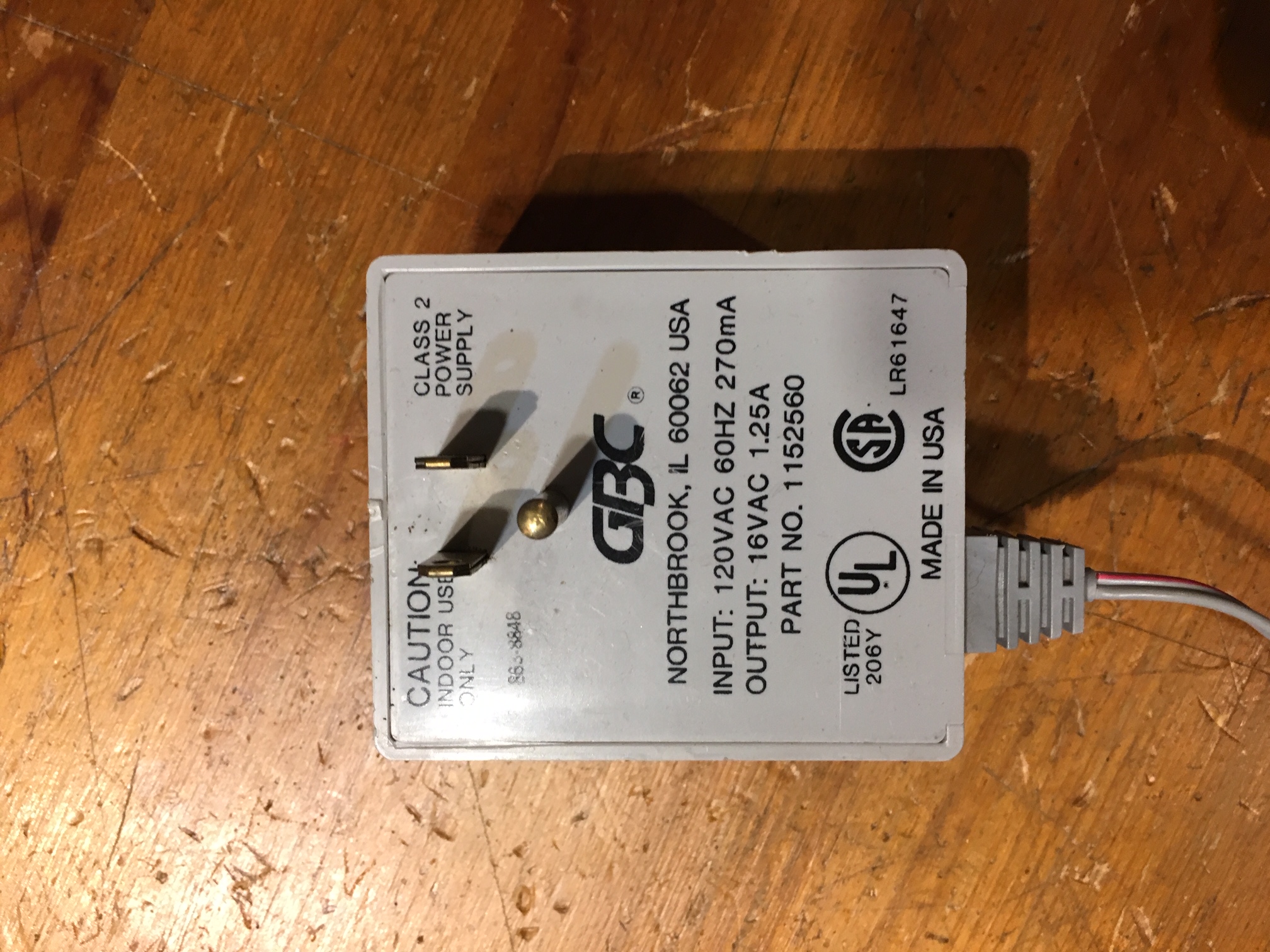

I have owned a Thorens TD-321 since I bought it new in 1984. The 321 is the version without a tonearm. I also have a TD-320 MK3 for the past 5 years. They use a 16vac wall wart. I upgraded to a GBC rated at 1.25A instead of the original 100mA version with no problems. I bought them at American Science and Surplus in Geneva, IL. They cost $4.50 each, they have 1A and 1.25A versions.
It sounds like the resistor issue is caused by to high of voltage for the wall wart.

Thanks for answering elwood, but I have the same problem than tiefbassuebertr in this post.
I have the same burnt resistor in my board and the TT doesn't work. I changed it but nothing happens.
Actually it improved the speed variations that the speed control could not handle on my TD -321 MK2. I did need to readjust the 33 and 45 rpm speeds using the two pots on the speed control board. Now both 33 and 45 rpm are dead stable.
The TD-320 MK3 uses a 24 pole motor with improved speed control, the updated wall wart was only helpful when the local mains were fluctuating. I live a mile away from Fermi Lab, when they fire up the light dim.

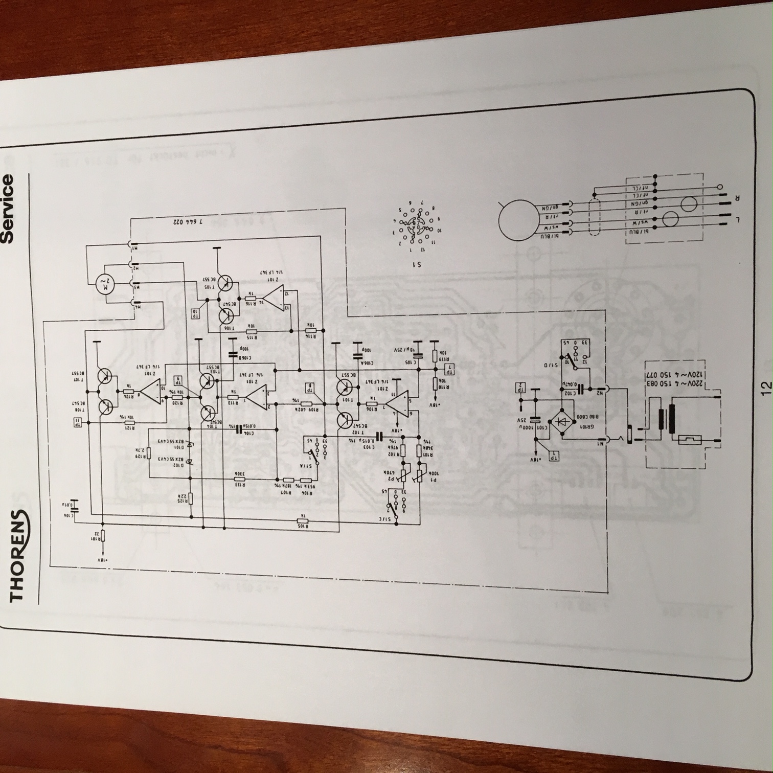

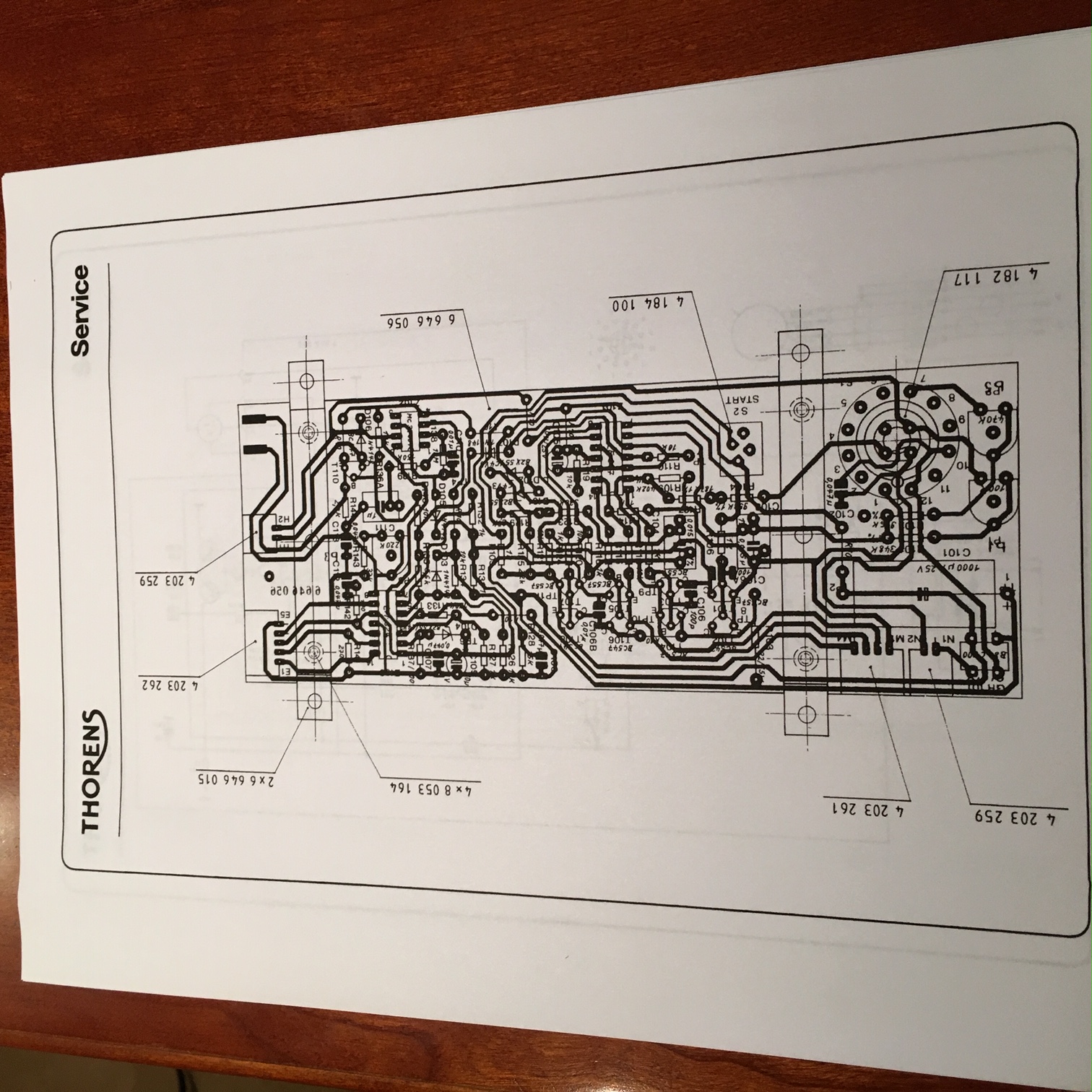

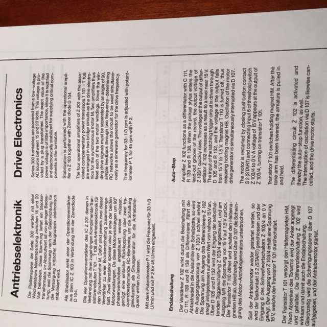

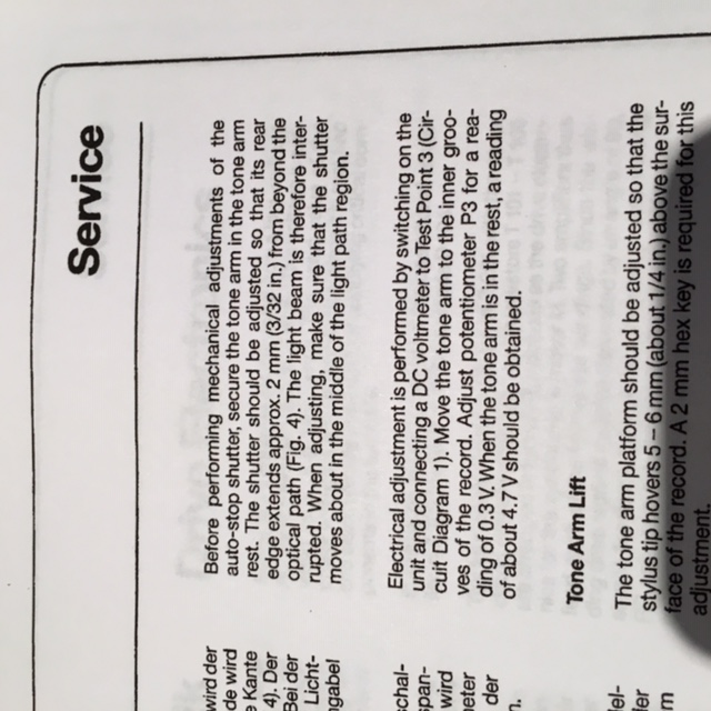

adelcura - Here is info from my TD-320 Service manual. If your turntable has the Thorens arm, it has an auto shut off feature, this is the first page, the other two pages give electrical info and test point values.

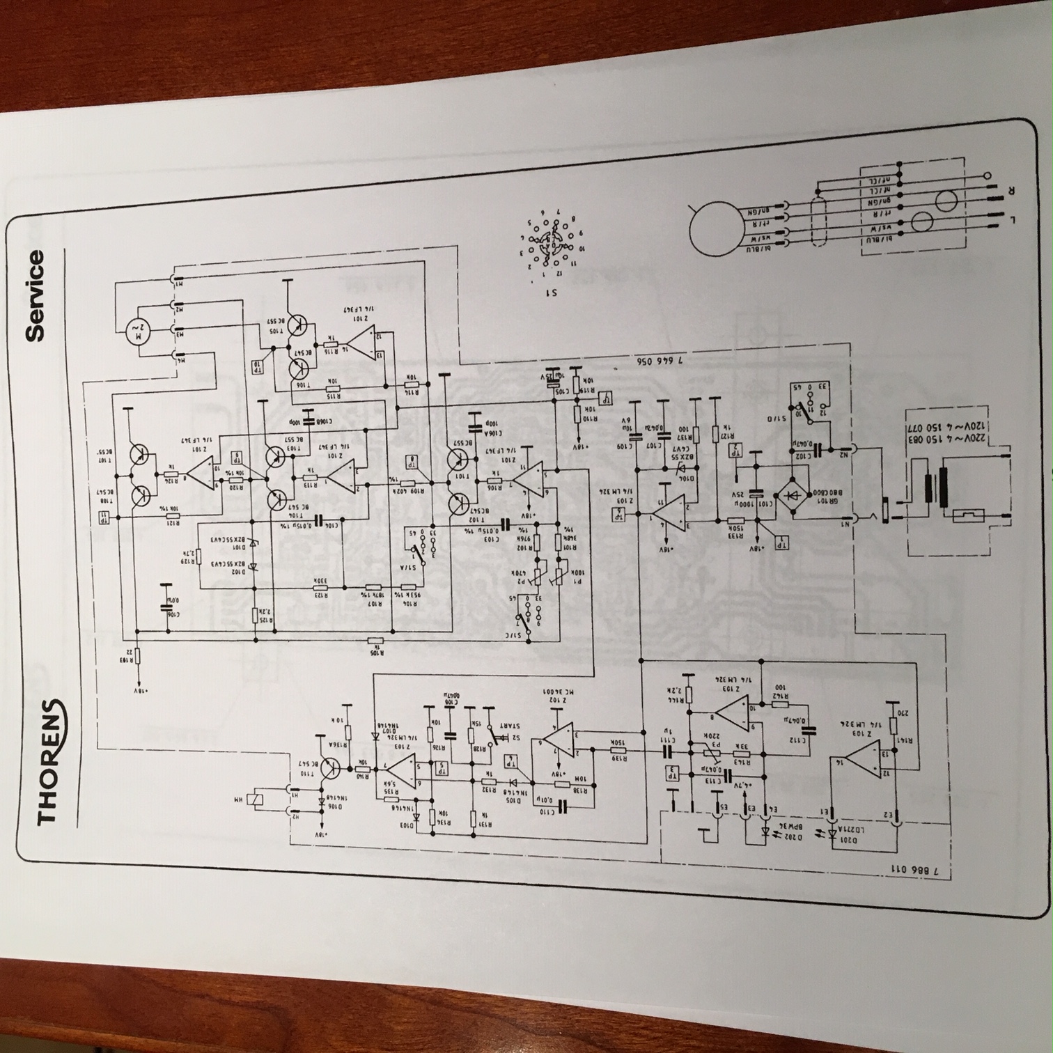

TD 320 scematics
Here are the two different schematics for the speed control unit and PC boards, you will need to match the schematic to your speed control.

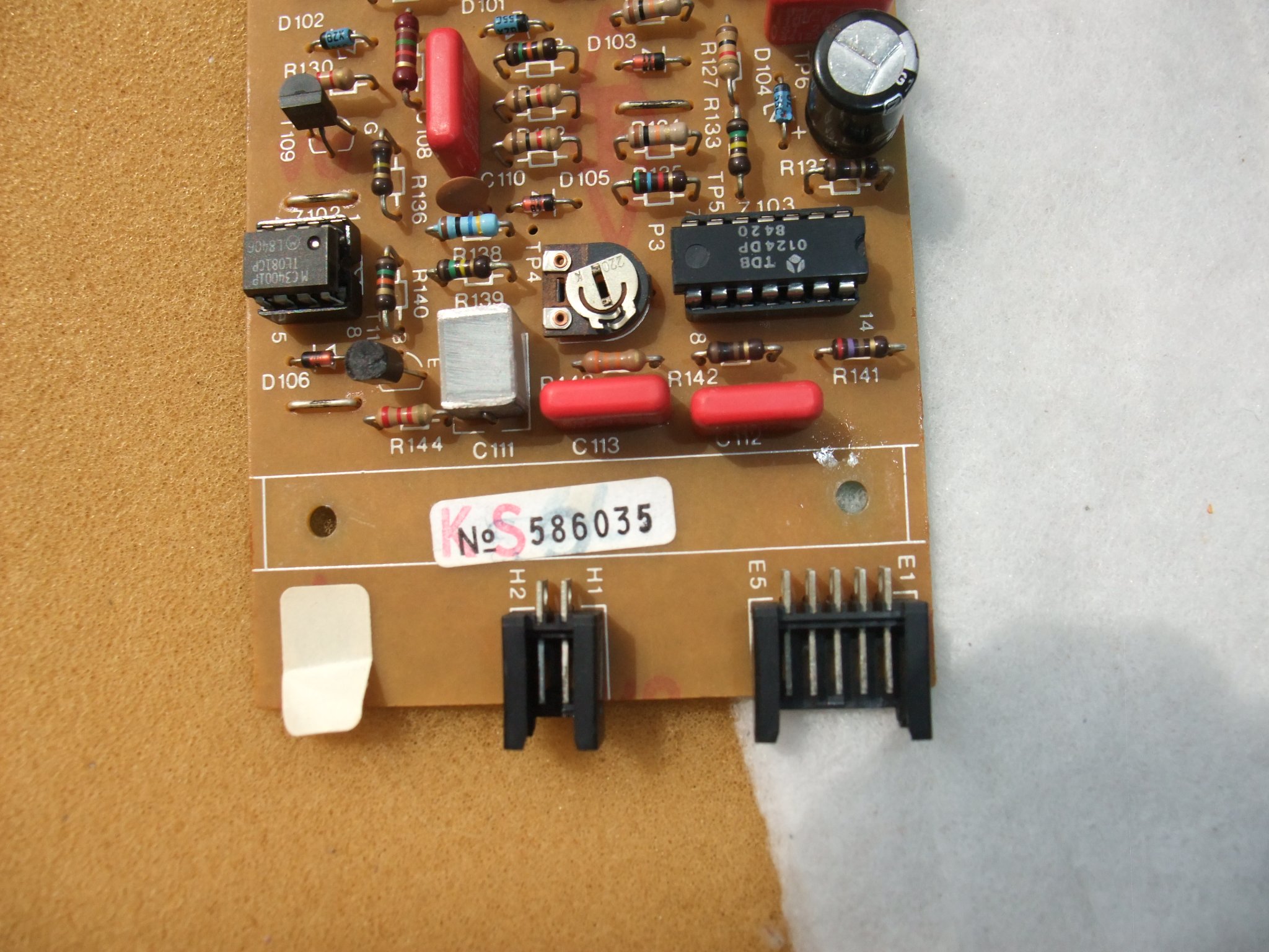

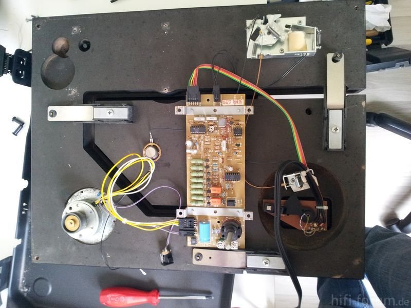

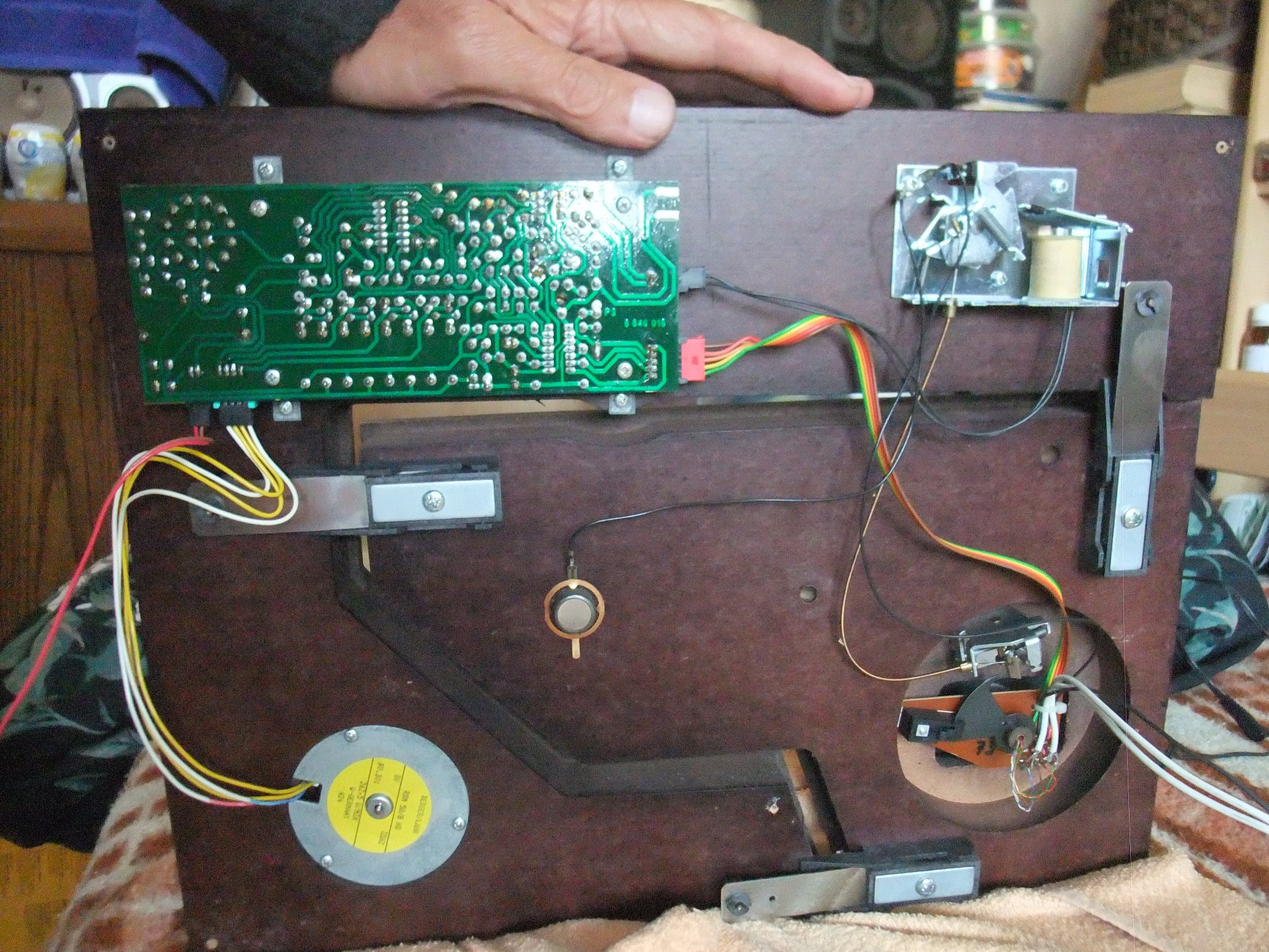

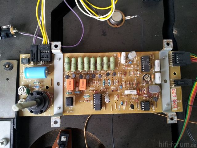

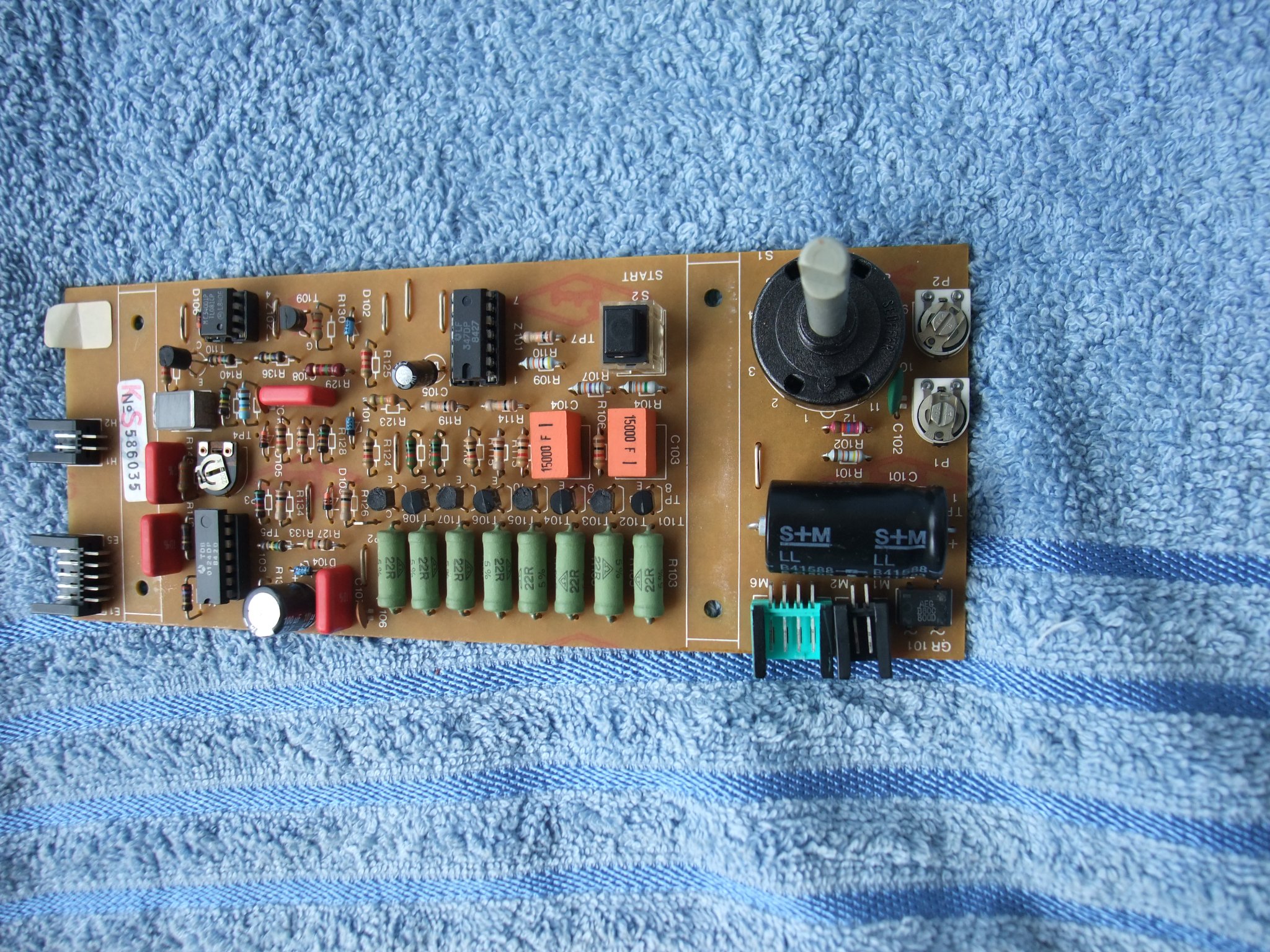

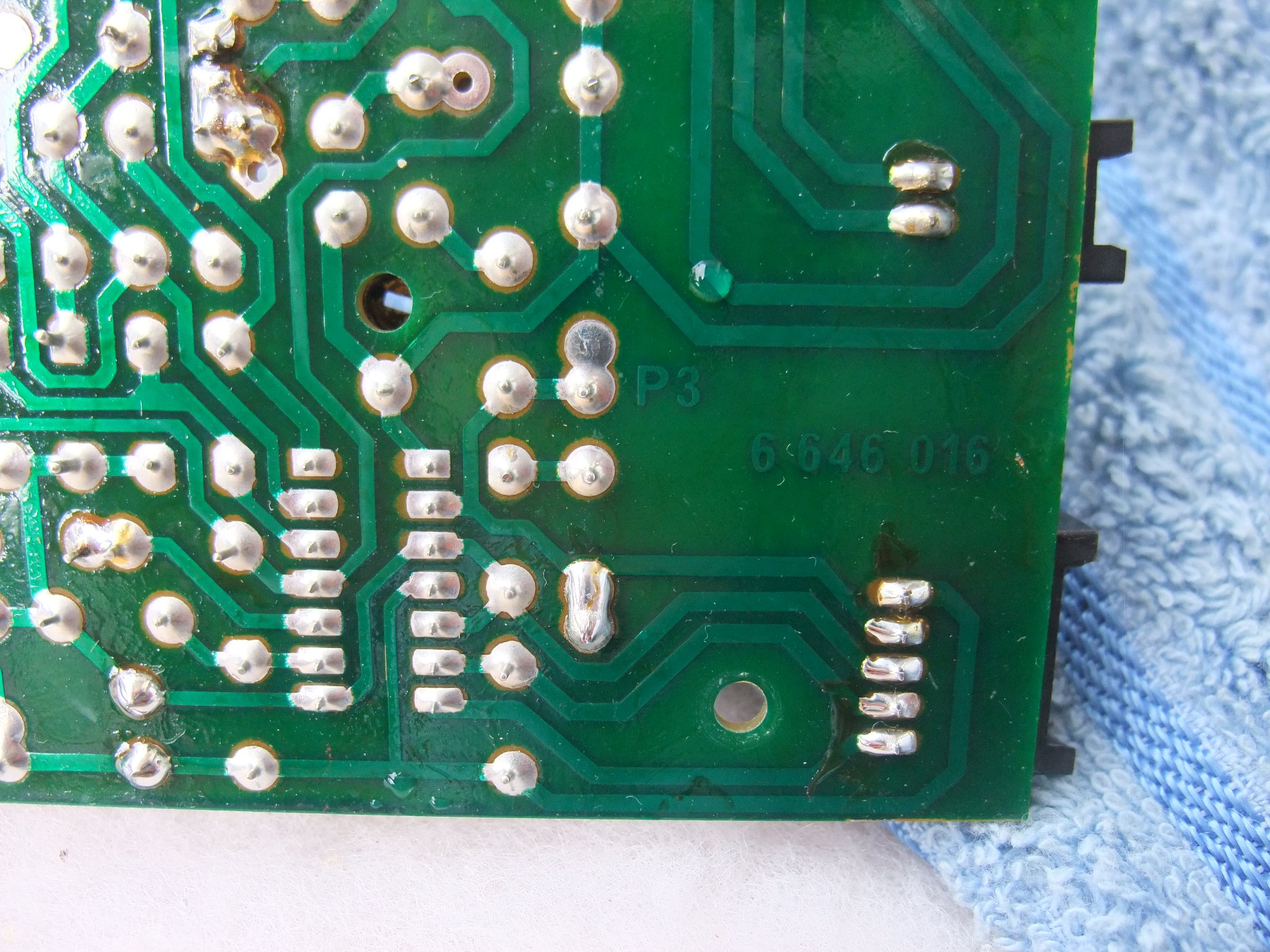

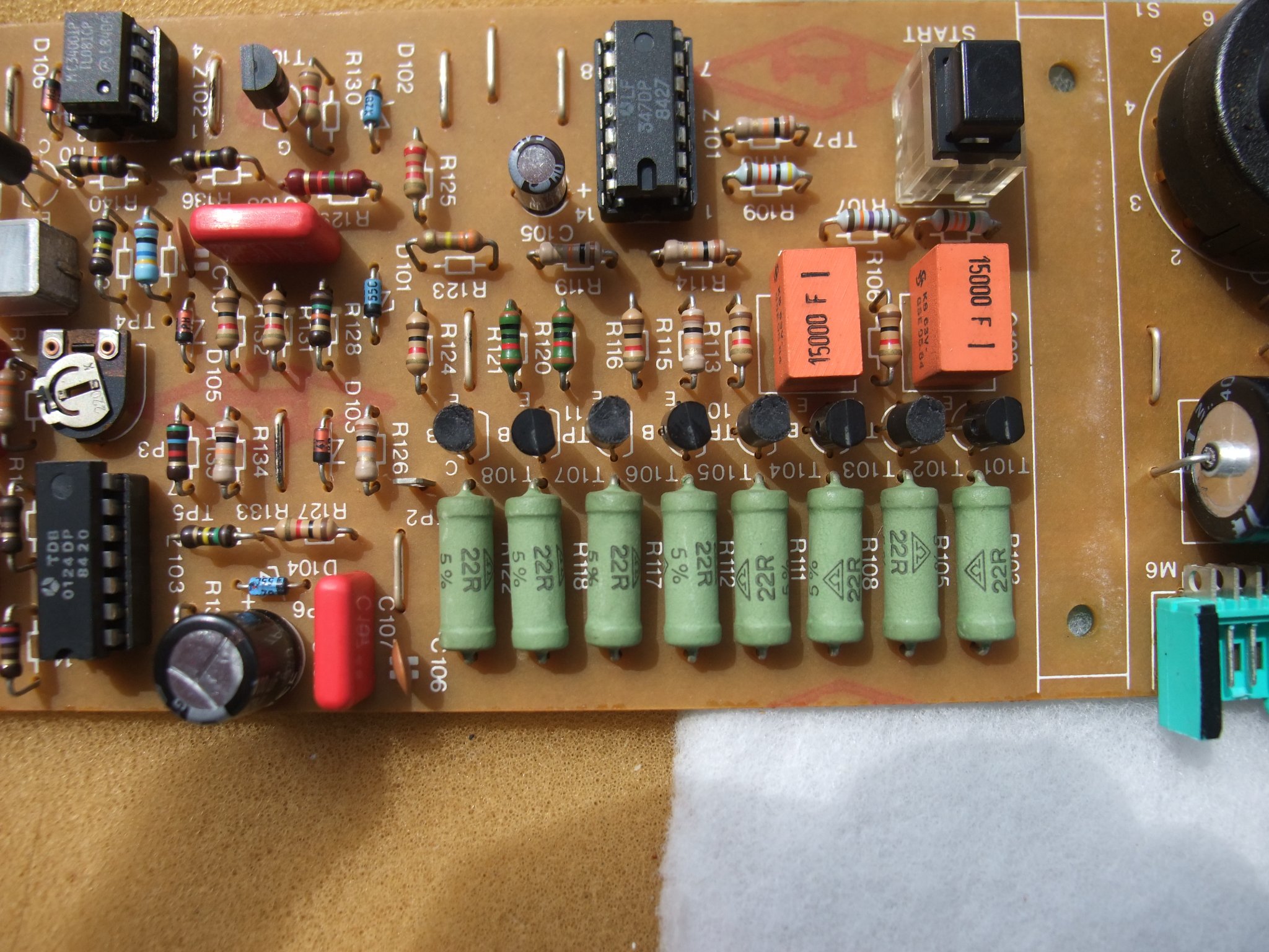

From the motor control unit of TD320 there are different versions. In the moment I want to have a service manual or service bulletin to the board from the first five attached images. Main difference to the most other find on the web are additional 8 pcs. 3W resistors of 22R, connected in the collector traces of the four complementary buffer stages.
Maybe the associated service manual is from an other model. Who know this ?
Thanks for advices.

attached TD320 images of whole device from first five images in post #16
schematics under
https://archives.doctsf.com/documents/afficher_document.php?num_doc=106001&num_fic=1
are both different to this PCB

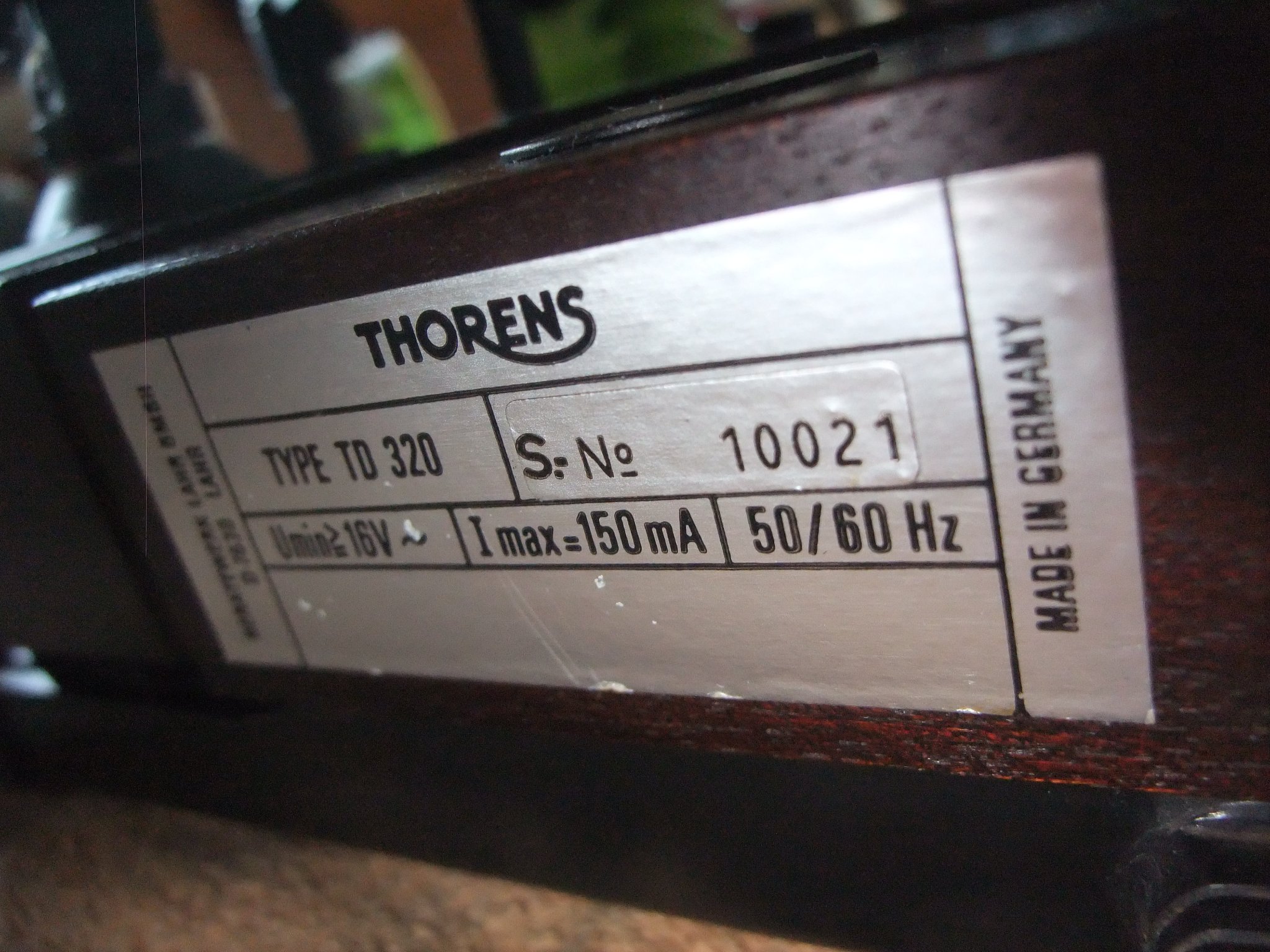

Now I have check a 14V~/270mA version from power supply series FW6299 (wall wart AC/AC adaptor ), TIPTEL order code 4569120, made for Tiptel 270 cord phone:
DC-values at TP1 (C101) : 0V7 without load and 17,9VDC with running turntable motor on 33rpm and 45rpm
AC-values at 233VAC mains voltage: 14,8V~ without load and 14,3V~ with running turntable motor on 33rpm and 45rpm.
The record player sound fine and no thermal issues are to observe on this wall wart AC/AC adaptor.

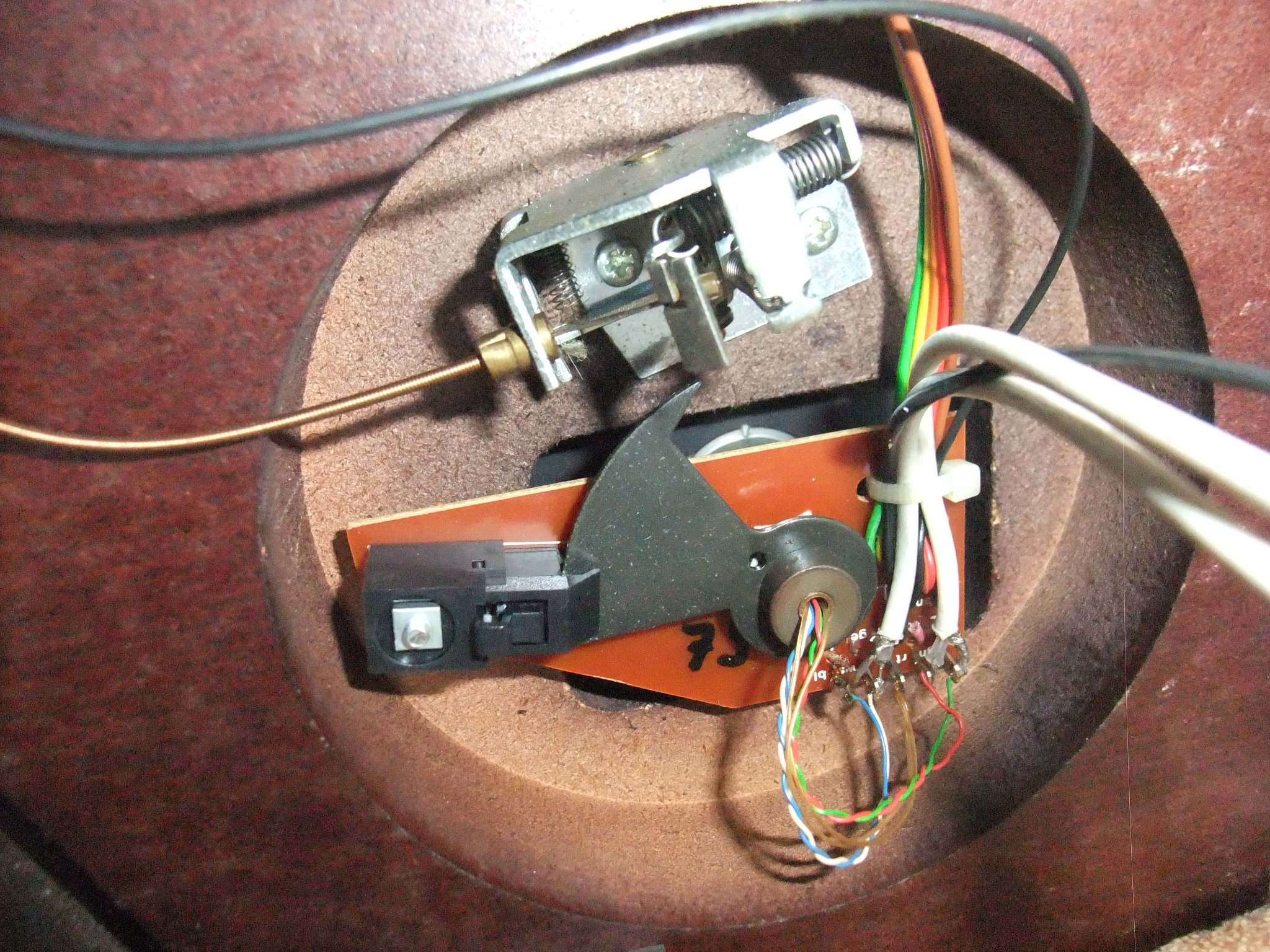

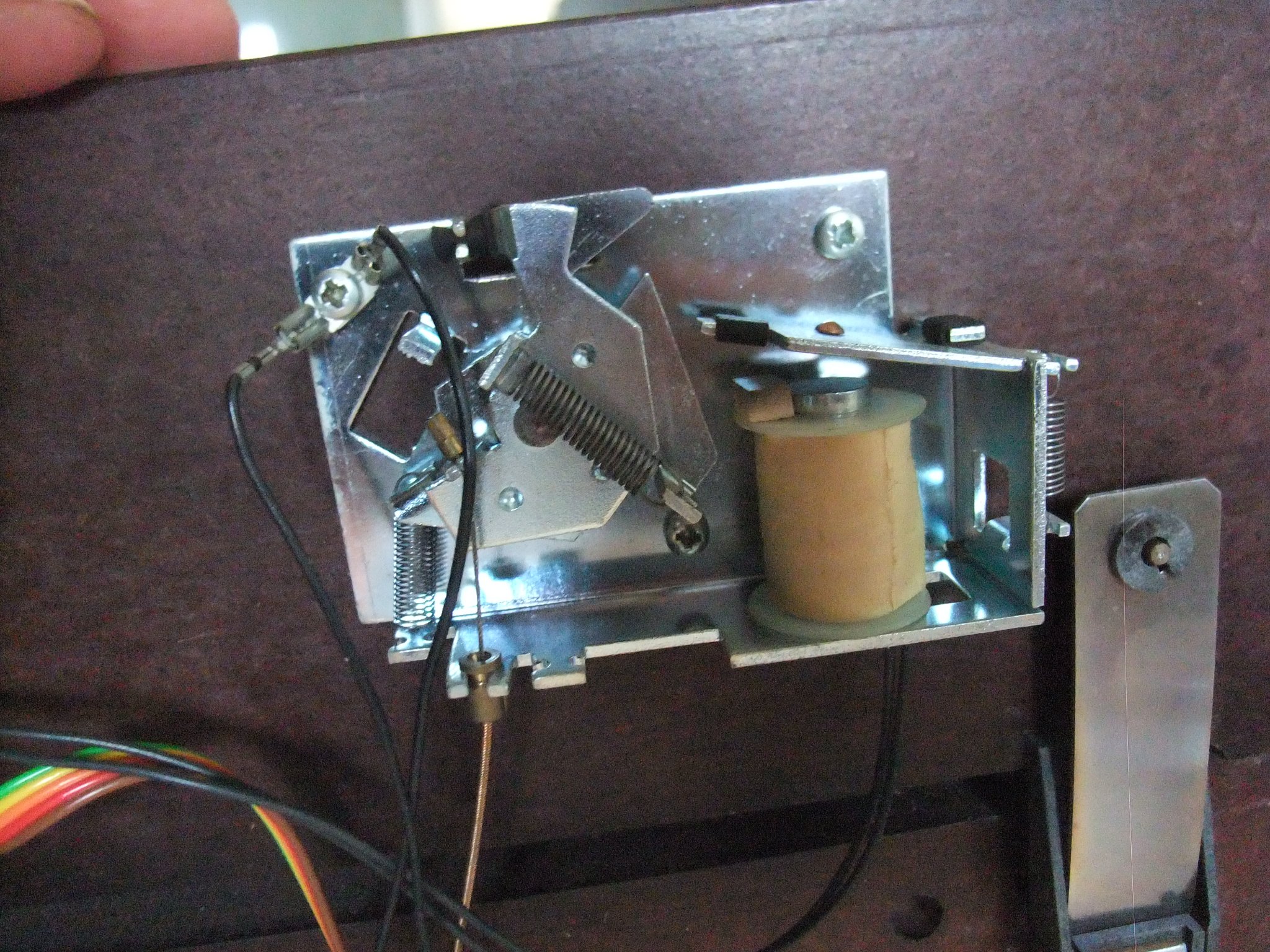

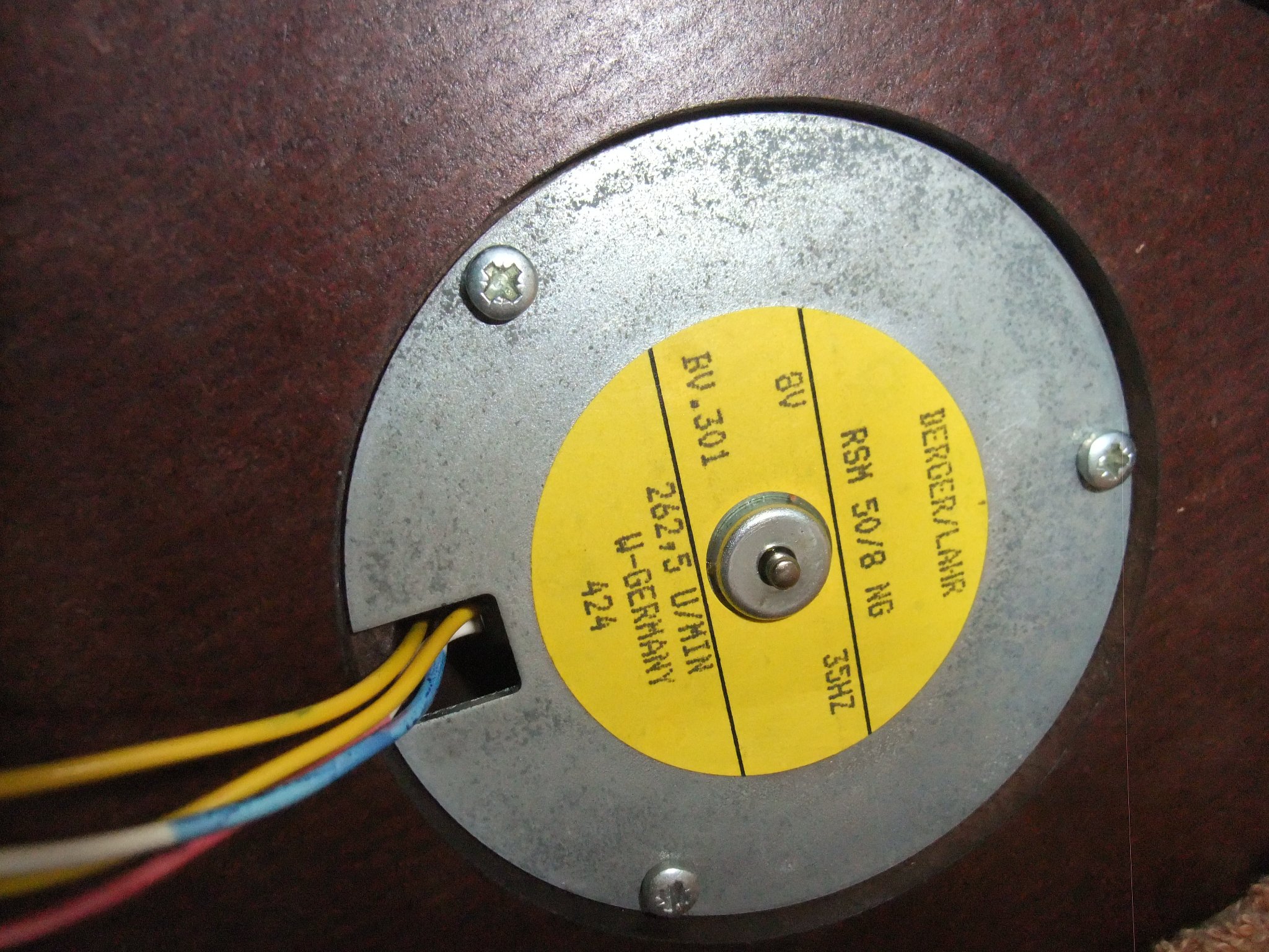

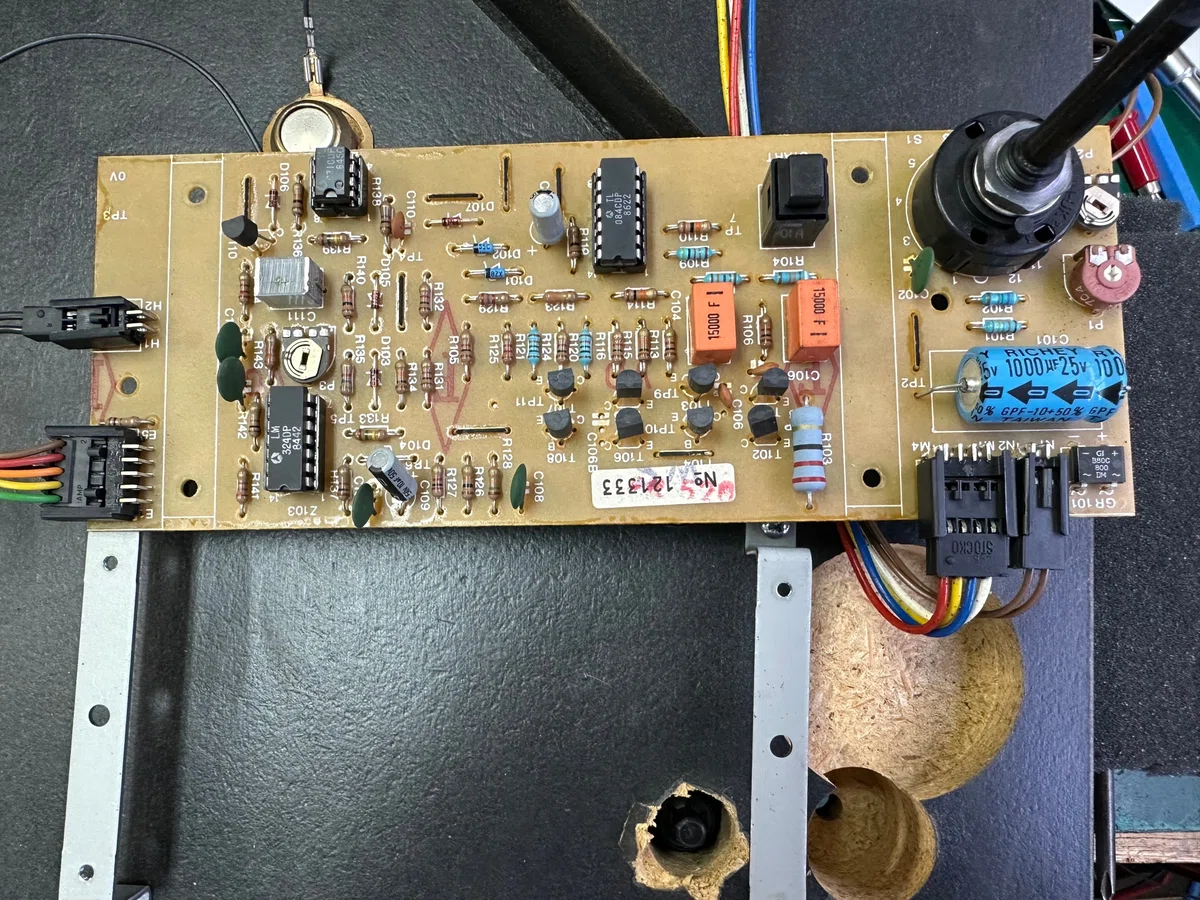

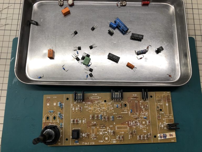

@tiefbassuebertr
I have an early TD-320 I bought new in 1986. I used it daily until about 2000, and it was in storage since.
The power connector is broken. Presumably, it got bashed in storage while.the wall wart was plugged in
I took it apart today and my power supply board is the same as yours. Mine is 6 646 016 A - I guess the "A" indicates a later revision. I don't see any obvious differences between the two boards except that some components are different brands. I know mine is 100% factory original because I bought the turntable new and and it was never serviced in the past.
Not sure why the service manual shows a different / newer PCB {6 646 056). The manual is supposed to cover the early TD-320, it says so in table 1 on page 4, and it lists the correct lubricant spec for the early sintered bearings..
I tried googling "6 646 016" and - nothing at all. Weird. Anyway this is my board:
My turntable was working fine when it went into storage. I will replace the broken power connector, and I plan to replace the electrolytic caps since they've been sitting unused for the last 25 of their 40 years.
I already lubricated the platter spindle with the correct Mobil DTE, and I plan to clean and grease pivots and mechanical touch points.
Is there other maintenance I should consider performing while the turntable is taken apart? Thank you!
images 7-11 in post #16 show the PCB version according the schematic in post #14.
your PCB version is according the images 1-5 in post #16. At first glance the difference are the additional green ceramic resistors R103-122 (22R/3W) - not mentioned in the schematic in post #14.
BTW - what means the term "power connector" in this case ? Mean you the associated wall wart AC/AC adaptor as to see in the images from post #1 under
Thorens outdoor plug-in Power Supply (AC/AC Adaptor) for TD 180-280-316-318-320-321 ?
Hello, I meant the power jack on the turntable is broken:
According to my readings it's a Roka 520 255 1. It is obsolete, and I was not able to locate a NOS one.
The Roka 520 255 0 is the same connector but designed for PCB mounting, and someone on eBay is selling 10 pcs for $7.99 with free shipping so I ordered that.
Fortunately there is plenty of room in the Thorens chassis to rig up new wire connections 🙂
