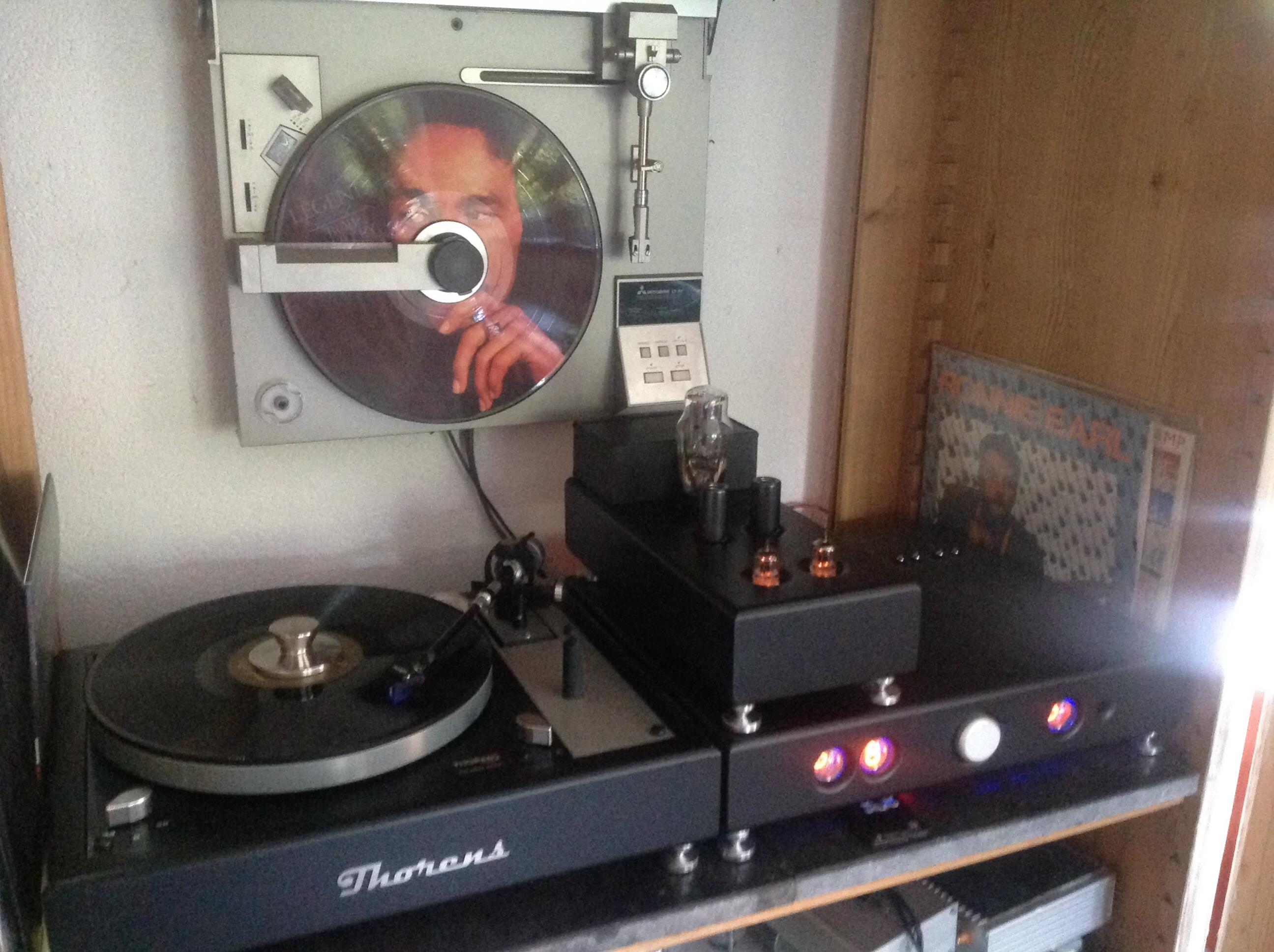

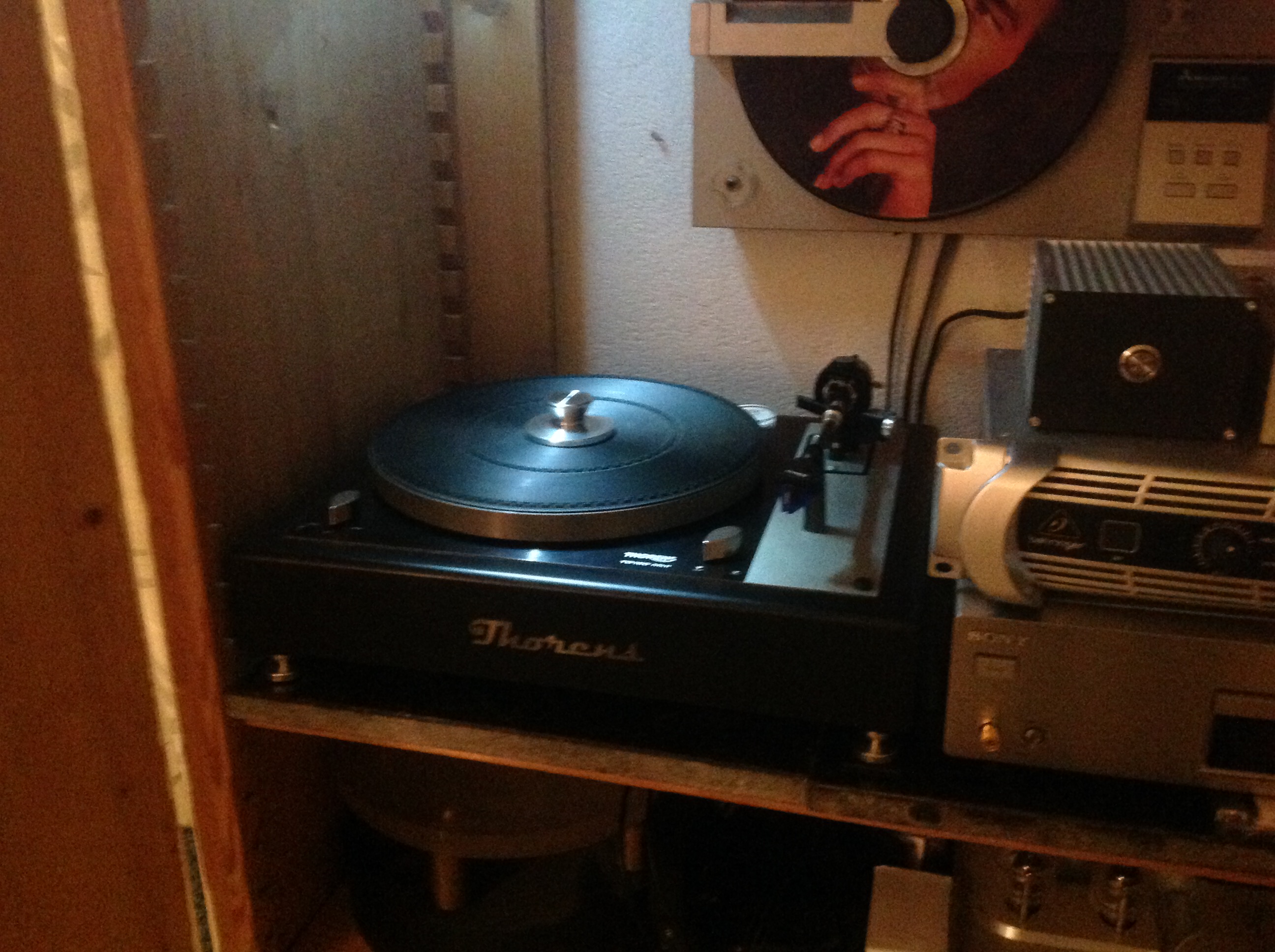

some inspiration, i build it from 25mm mdf.

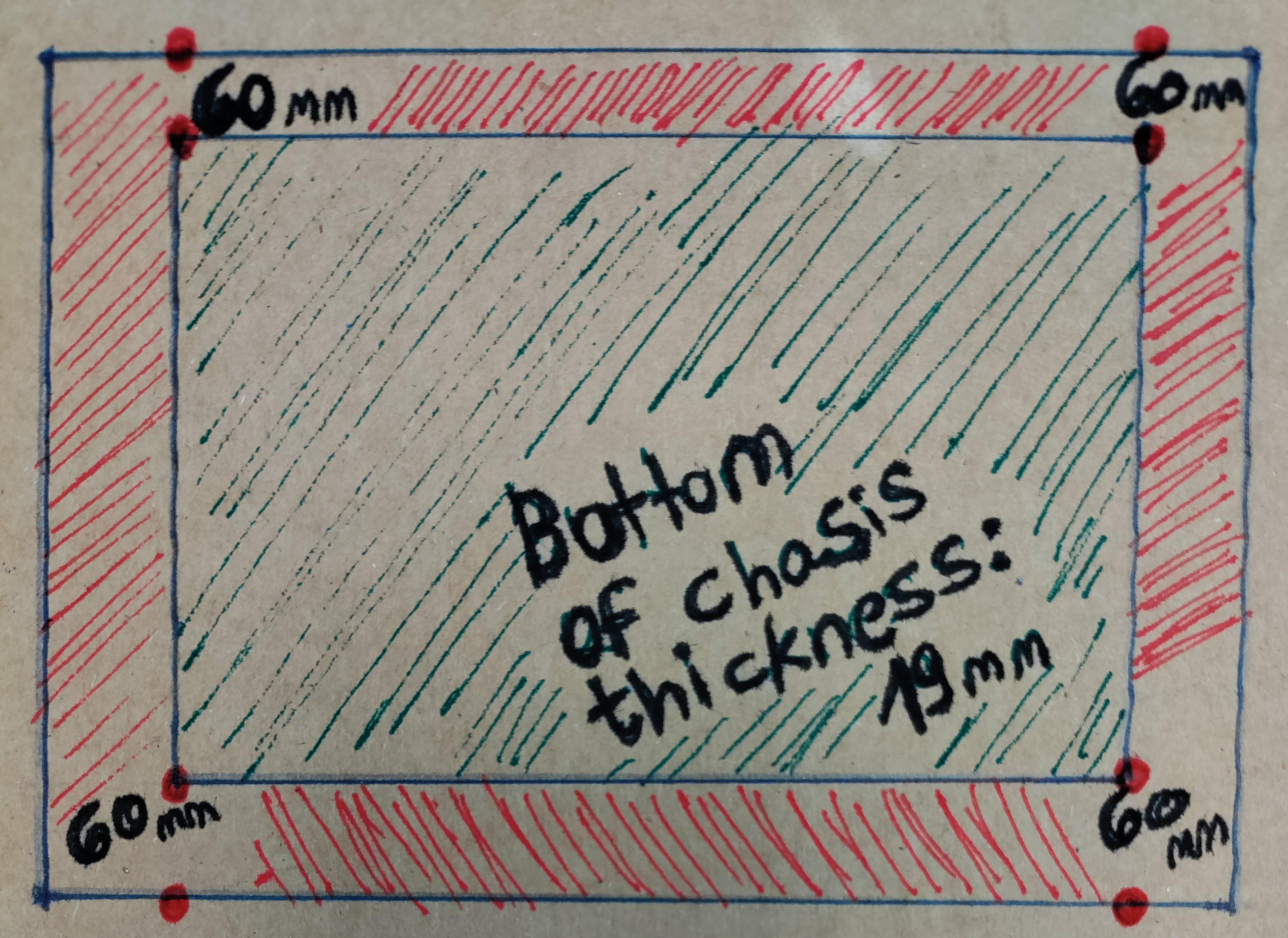

Hi Adelmo,
1. Do you have photos from your project? if do, can you please share?
2. You mean in "wall thickness" = the 4 pieces creates the frame of the base?
3. I still did not got the thing with the "3 pieces like a U upset down".
4. "eight" - what do you mean in '8'?
I drawed as i want to make sure I understood.
Got it right?
I own A 166 mk ii...
Thank you very much

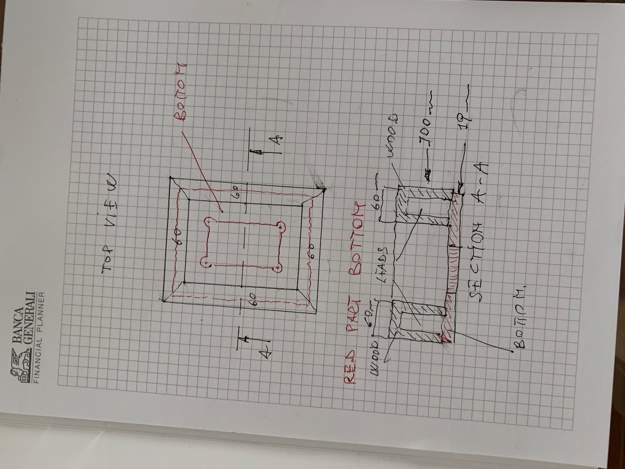

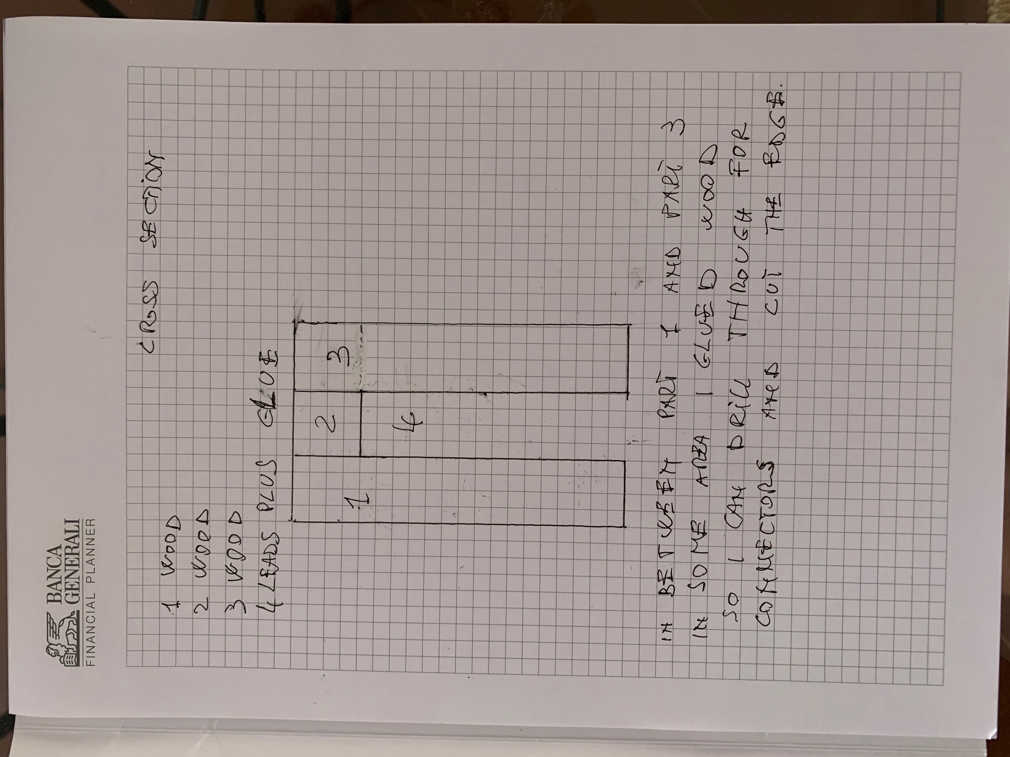

Hi Shaby,
Your drawing is correct but not for the bottom drawing.
I attach here with a hand drawing ( sorry I am not good at it ) for the cross section of the 60mm frame. Kindly note that to make it you shall need to cut the edge 45 degree and there you shall need to have the whole wooden in the whole cross section so it is not a u shape in that area. The same apply where you need to drill holes for connectors or IEC plug or ground wire......
The bottom drawing of yours is not correct. the bottom need to cover the open u shape as you shall need either glue it or bolt it to the open U shape, the center hole I made was square. I attach a hand drawing. Hope can help.
I like to highlight that my plinth sounded better than the original plinth, but perhaps there are other material that may sound better than the one I used. debate on material is almost an end less issue, lately is very fashion panzer or others......
Mahogany is easy to get, easy to work with and easy to finish the surface, I think have a reasonable and good sounding quality and combined with thin leads used for guns it had a good result for me.
Hope it can help.
Rgds
Adelmo
