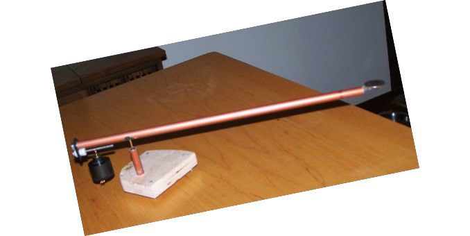

Or make your own arm
which can be vary cost effective and very good performance wise.
A single quid has got me thus far....

jrevillug...very nice idea...and a similar to a thought I had....
the us eof bamboo makes good "sense" to me. The bearing is something that I'd thought about as well (have a few of the VHS drums kicking around). I imagine that the limiting factor is the quality of the internal tonearm wiring, and how you connect it to your phono stage.
