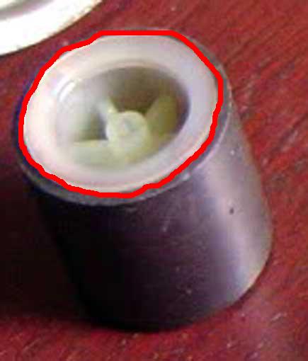

well - just found culprit for tickling sound in Thorens motors ;
I made extensive research on net and all I can find are unfortunate attempts in solving that issue
rotor magnet cylinder is filled with two equal plastic cores/bushings ;
but - after many hours of operation - there is slight looseness between plastic cores and magnet and that is reason for magnet "rocking" on cores during revolutions
solution : buy some super glue , and pour some of it on both tops of magnet cylinder - between magnet and shoulders of plastic .
problem solved

you must open the motor , drilling points where three stubs are pressed on motor body , and later you must replace them with new ones ( use generic tapped spacers cut to same length) .
whatever you do after removing these tree stubs - use just hands ; you do not need any tool ,and that way you're preventing any damage possibility .
magnet is just pressed on spindle ;
as reminder - there is double metal washer on each side of magnet/shaft combo
dismantle everything and be careful to put magnet back on spindle in same orientation - because of rotating orientation ; anyway - side with shorter center hole part and additional small plastic "ring" is lower -bottom side
clean/wash bearings and shaft with benzin or alcohol
put several drops of super-glue right where I mark with red on attached pic - between ferite and plastic shoulder; glue both sides , off course
wait half hour before motor completing procedure
use graphite grease for shaft/bearings - thin oil is story for little kids , obviously .

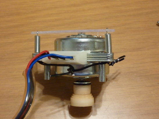

Knocking sound solved

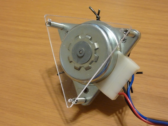

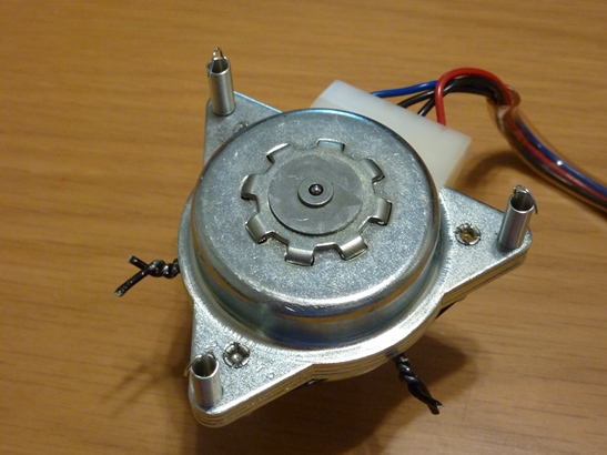

I'd like to post my solution for the knocking sound problem on my Thorens TD 160 which I found so irritating that I just had to try something. I didn't trust myself to disassemble the motor so I applied gentle pressure on the spindle below with my fingernail and noticed the knocking stopped. I doubted that anything was loose within the motor itself. I'd advise a more professional solution than mine, e.g. a kit from eBay. However I'm pleased to say that my idea brought success without the overhead of postage and customs duty.

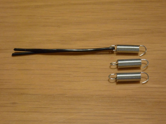

First buy a few small identical springs. Squeeze one side to just fit into one of the motor holes. Use stiff isolated wire (e.g. Bonsai wire) and loop it through the squeezed spring end:
... picture 1 ...
Pull it through the motor hole:
... picture 2 ...

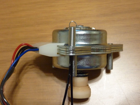

until it stands upright:
... picture 3 ...
twist the isolated wire to prevent the springs from coming out:
... picture 4 ...
The 3 springs stand upright on the underside of the motor:
... picture 5 ...

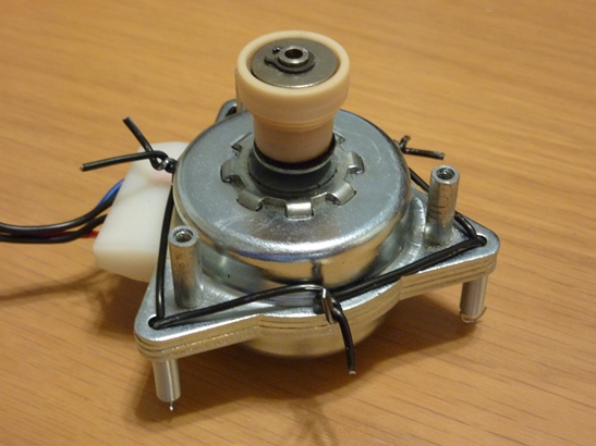

Saw a triangular piece of plastic or stronger material, make three holes and loop the springs into them:
... picture 6 ...

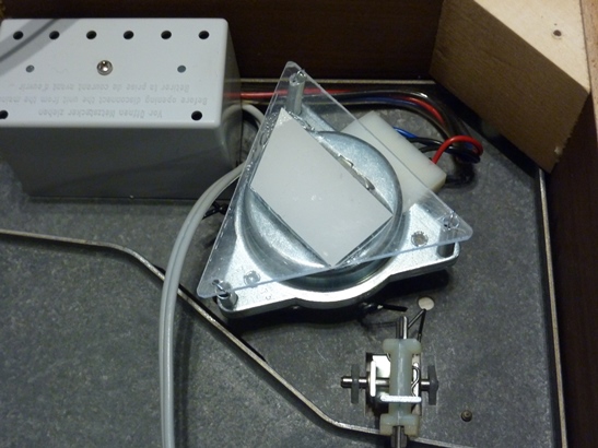

If the length of the springs is right, gentle pressure should be applied to the spindle:
... picture 7 ...
It's important that only the tip of the spindle touches the transparent surface. A small piece of glass could be glued onto it if you want a less abrasive support for the motor spindle. That's it! Very makeshift, but costs almost nothing to try out. I'm very happy with the result!

I think all these posters are referring to rotor end float............ I had to glue a piece of thin glass (cut from a mirror) - see picture. I think this will last 🙂
End float allows the rotor to sit anywhere between the end stop limits.
It can move between the end stops depending on load, external vibration and supply voltage.
The solution as found is to limit end float. And use a little bit of oil in the remaining end float gap to damp oscillation in the remaining tiny gap.
The gap must not be zero, otherwise temperature expansion could in worst case lock the motor, or wear out the end stops and the excessive end float returns.
I use the spring loaded plate to push the motor spindle (aka rotor end float) to the top - there's no restriction on the gap. In my case this eliminates the knocking sound. I have a slight concern that motor spindle now rests on the upper limit instead of gravity pushing it downwards, i.e. some other part may wear out. Anyway, if it doesn't last I'll likely invest in a Thorens TD 203 using my current AT OC7 MC-cartridge.
