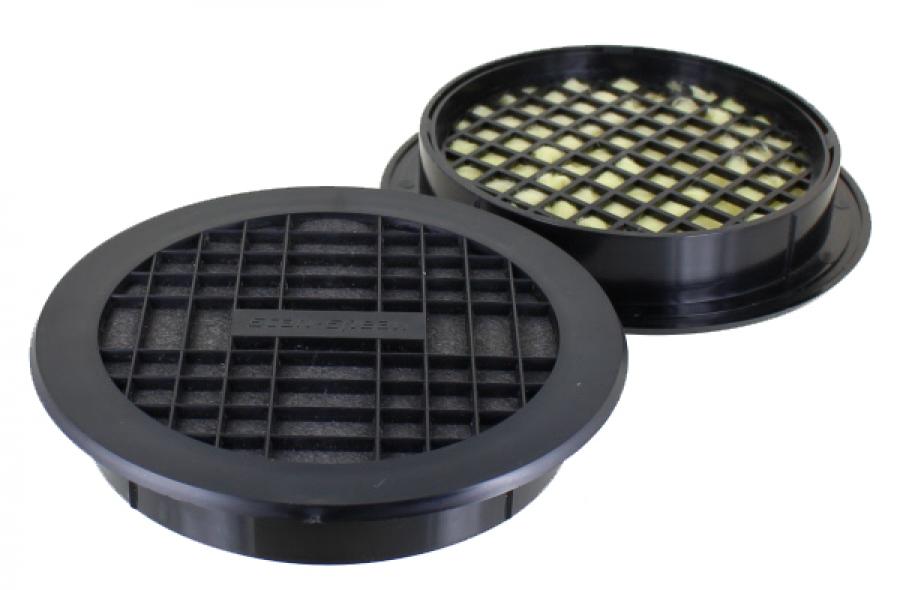

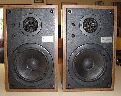

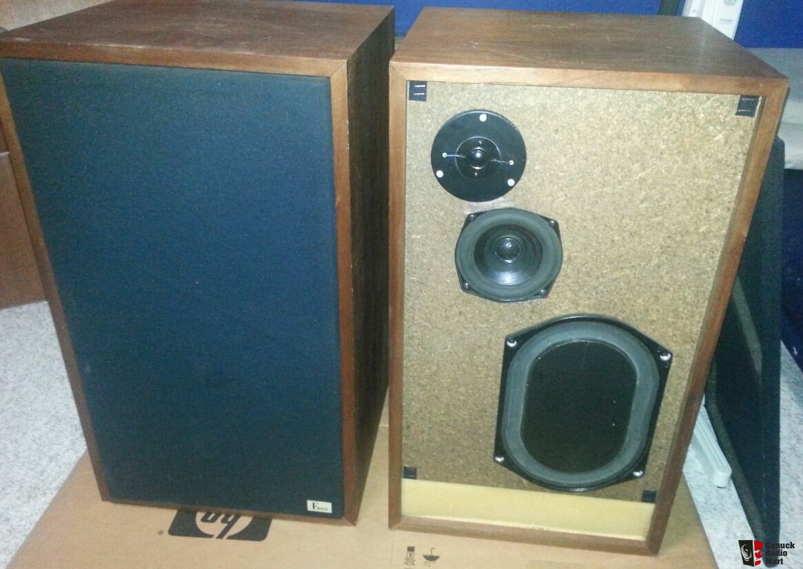

I also came across this post from 2007 from philthien on Tech Talk.
Fried made several versions of Beta speakers, and one of them used two smaller holes (maybe 1/2") in the baffle as aperiodic vents. I imagine the backs of the holes was covered with some material. But I guess you don't have to worry about port noise so you don't need to go overboard on size. I have heard Beta speakers and was amazed by the bass coming from such a small package.
I'm including a pic.

So where would an Aperiodic Vented cabinet end up for volume and F3???
And, how do I determine the volume?

Fried made a bunck of aperiodic loudspeakers. The R & The Q were standout. Essentially a box with a substantial slot vent filled with foam rubber (i think they could have used better, looked like it could have been a slice from a foam mattress).
Never saw a Q with such nice veneer, the ones we had were cosmetically similar to the bigger R.
