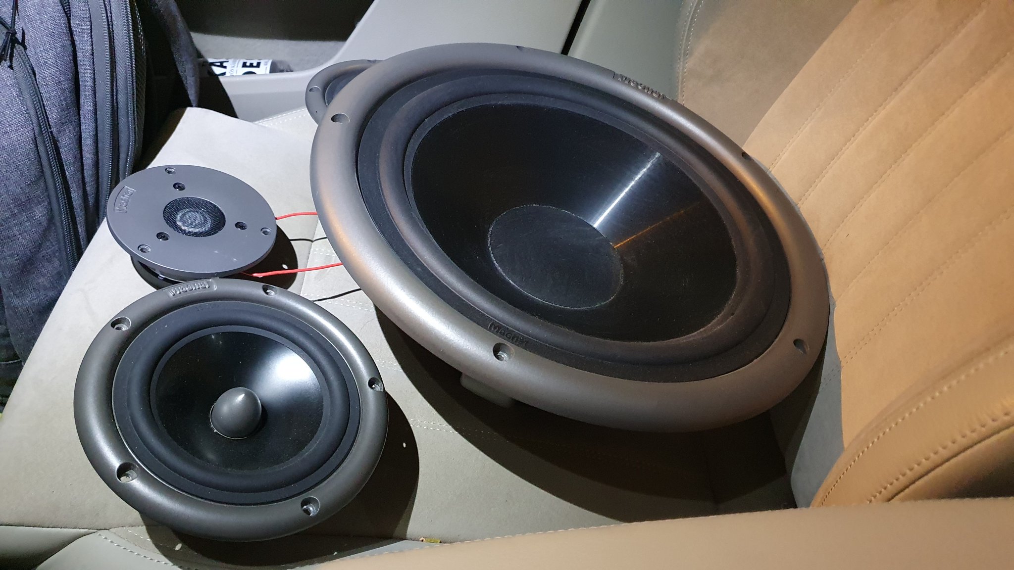

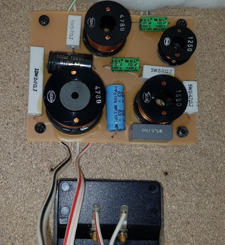

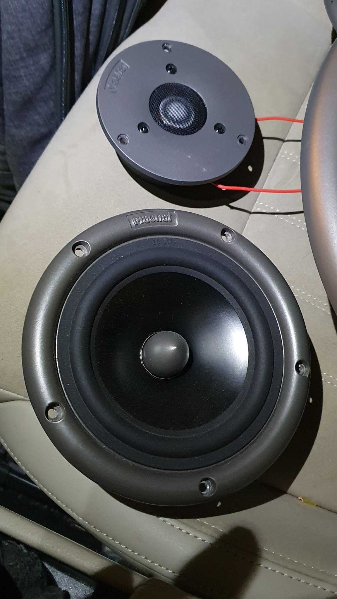

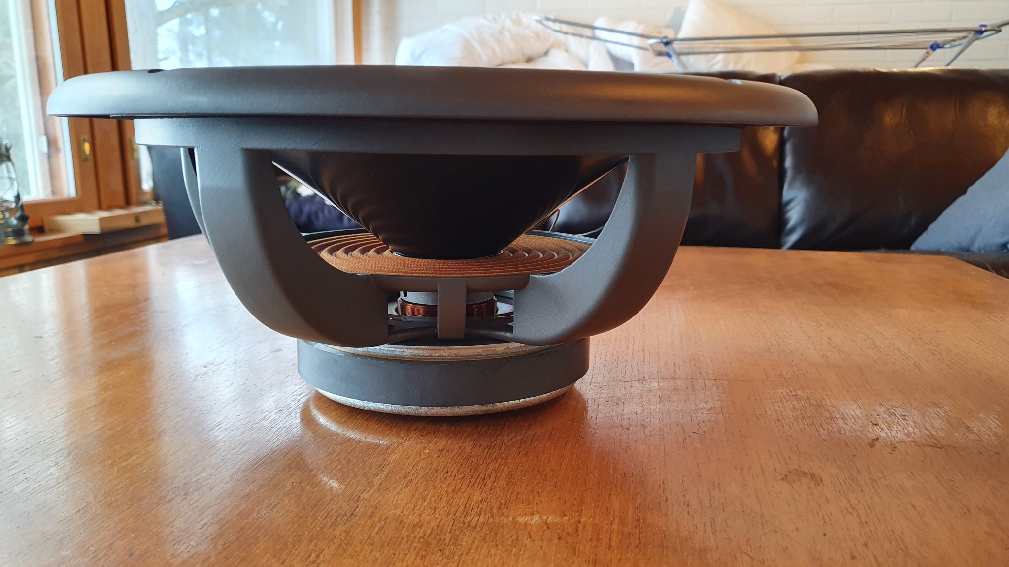

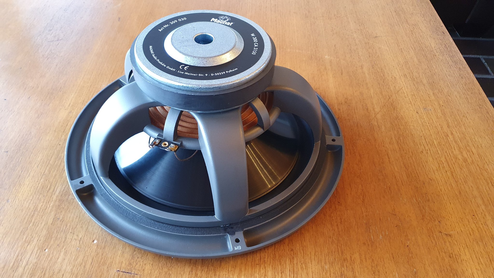

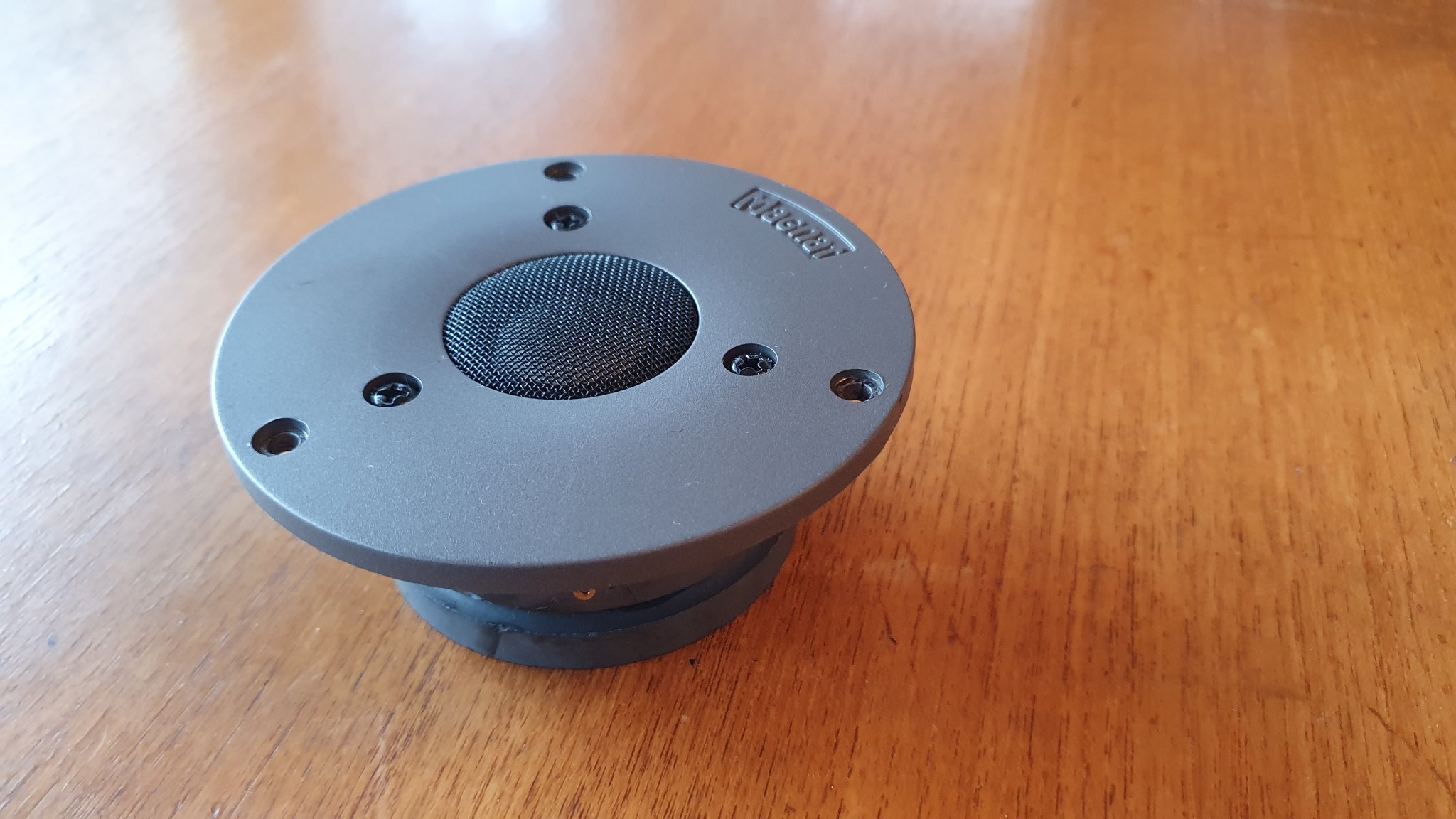

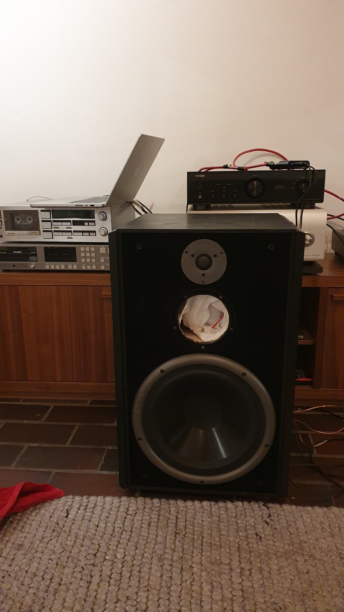

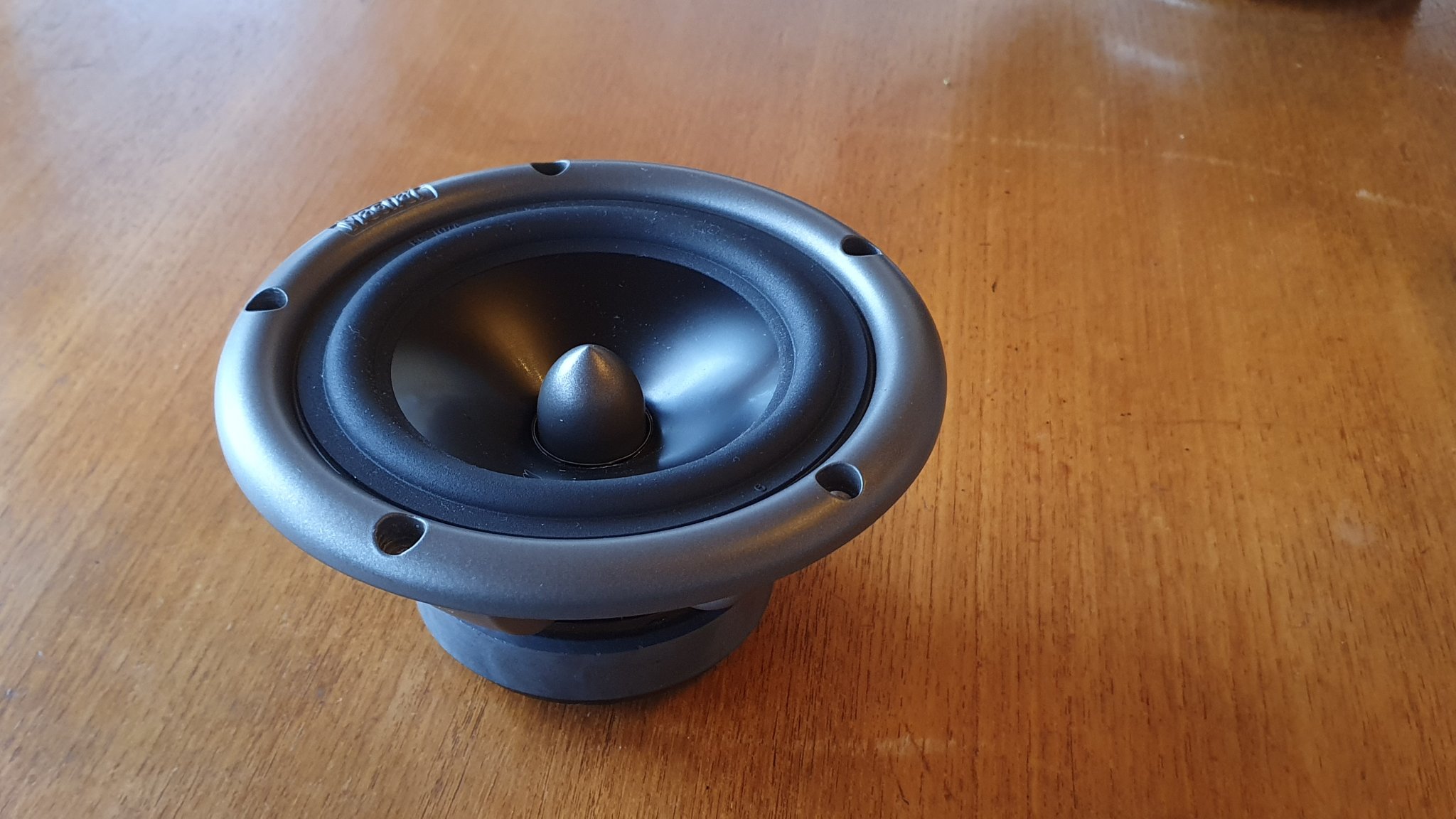

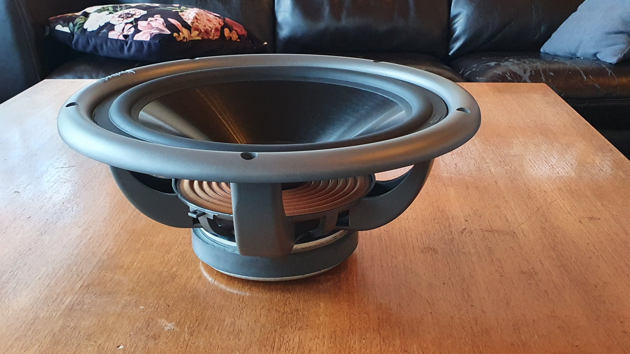

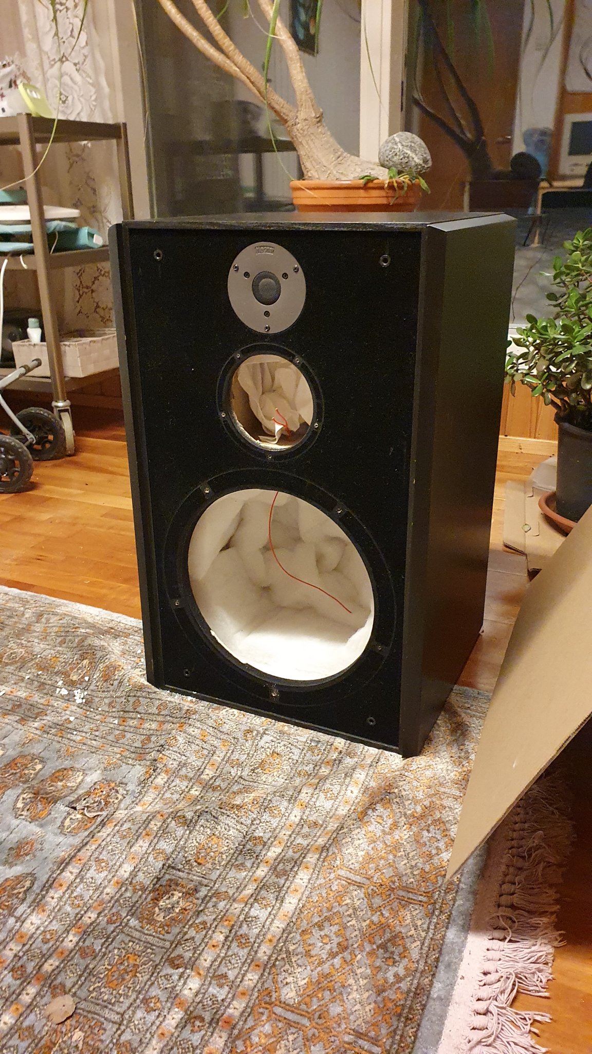

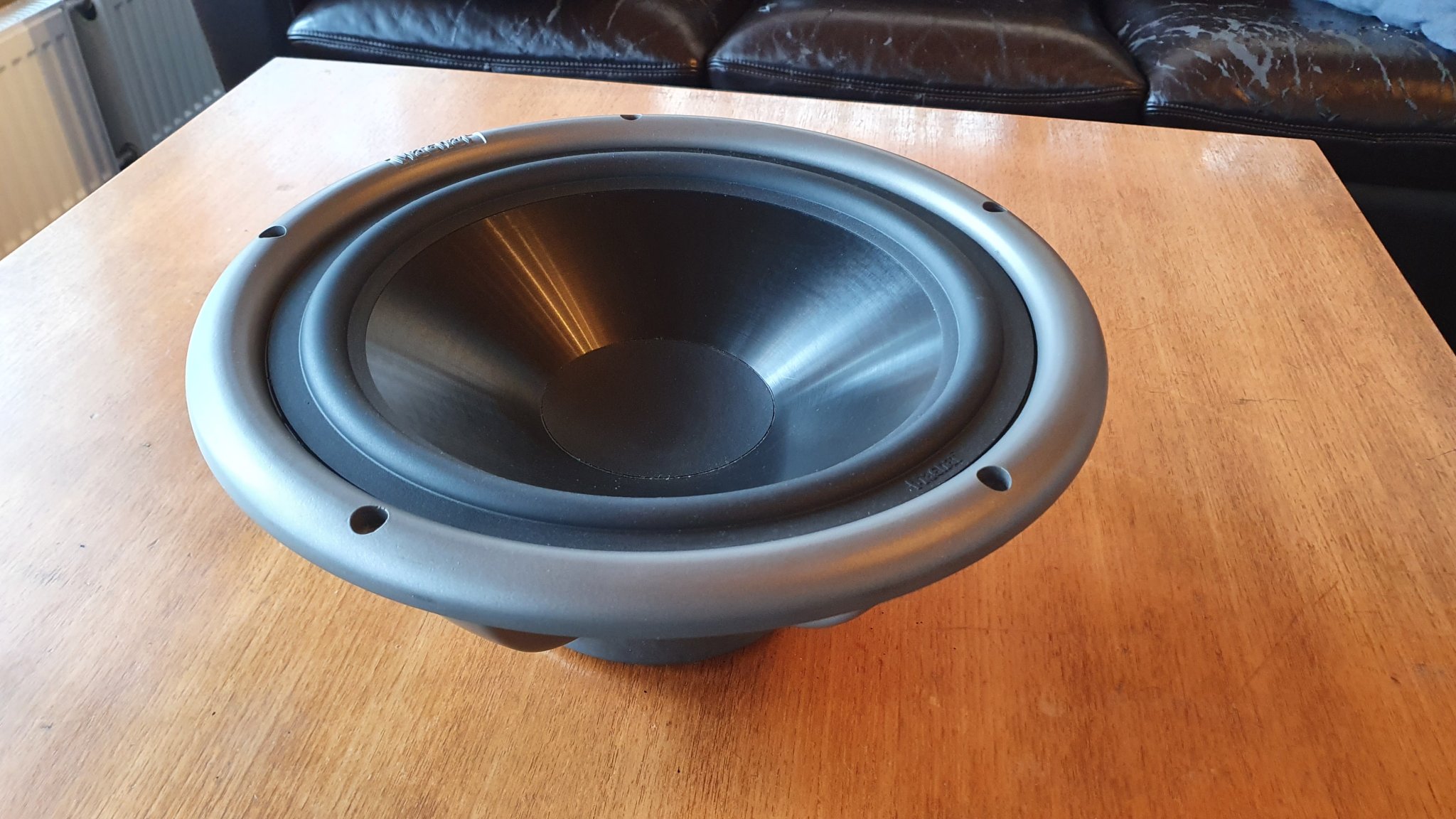

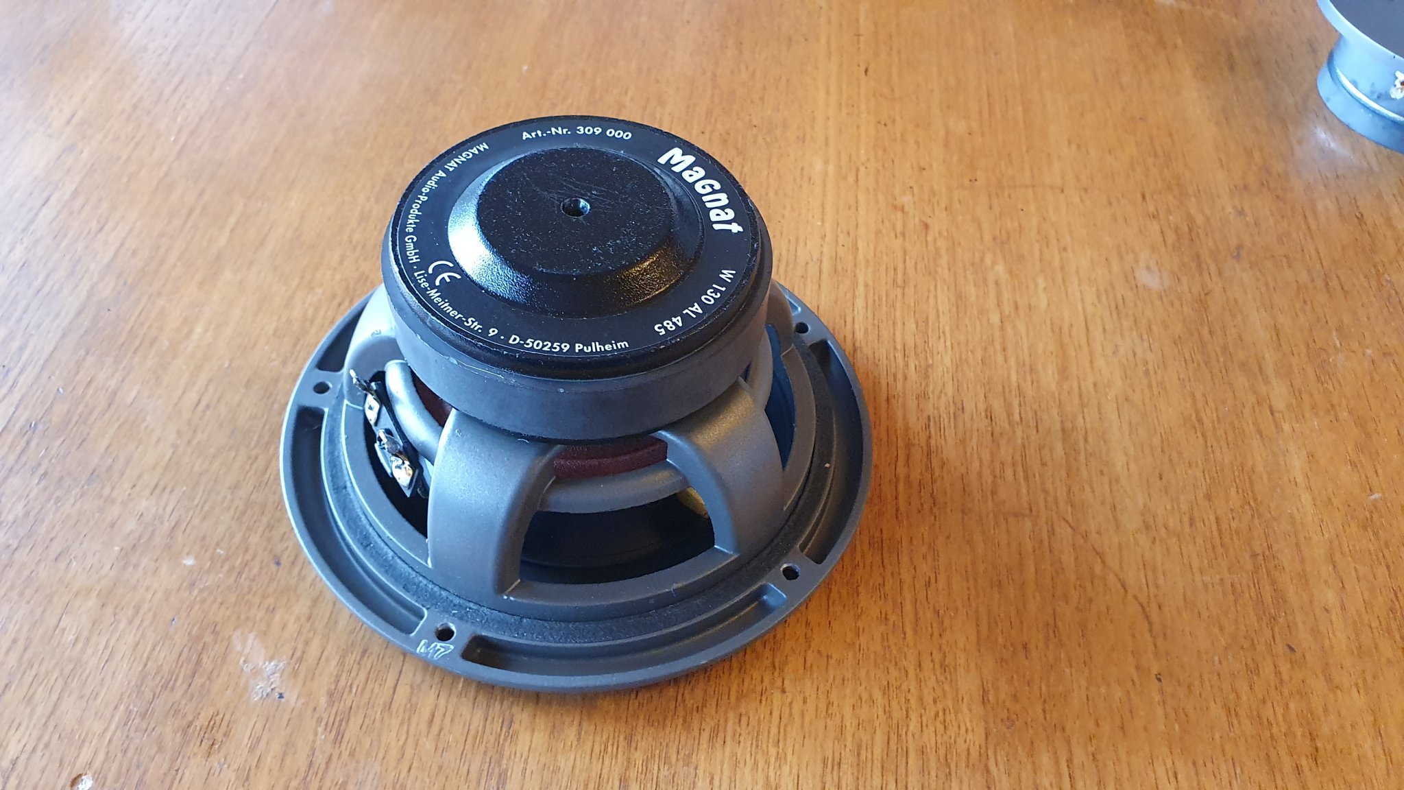

Some quick photos, did pick them up today..
Tomorrow i will put better photos of drivers and measure them, Bass is ok, but i hope that mid & tweeter is as well.. We shall see..
Damn these are heavy!

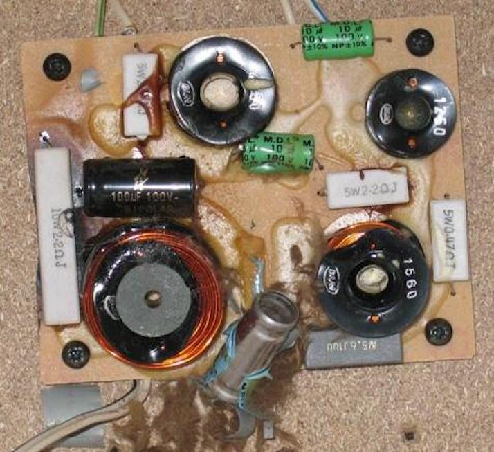

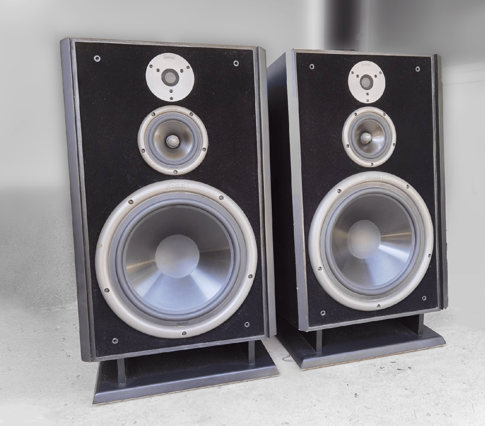

Found some information and picture of original crossover.
I really doubt about that sensitivity, it was ok but little bass light with Threshold t200 (100w class A).
Stereoplay did review it with: Sehr Gut and Magnat cum laude ( what a wordplay..)
This really was a highend speaker, even if it does not look like it..

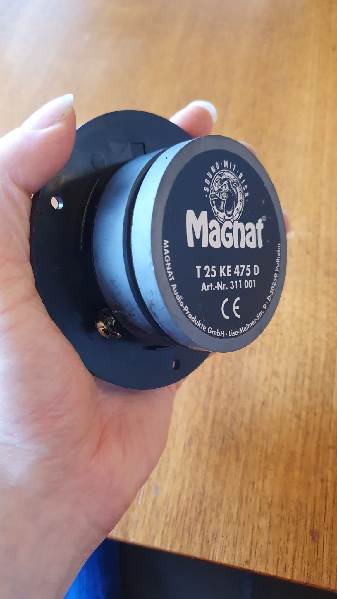

That is the best part: There is no ribbon!
I don't know enough german to know what was the idea behind whole range of "All ribbon" speakers, but from what i have learned over the net it has something to do with voice coil??:

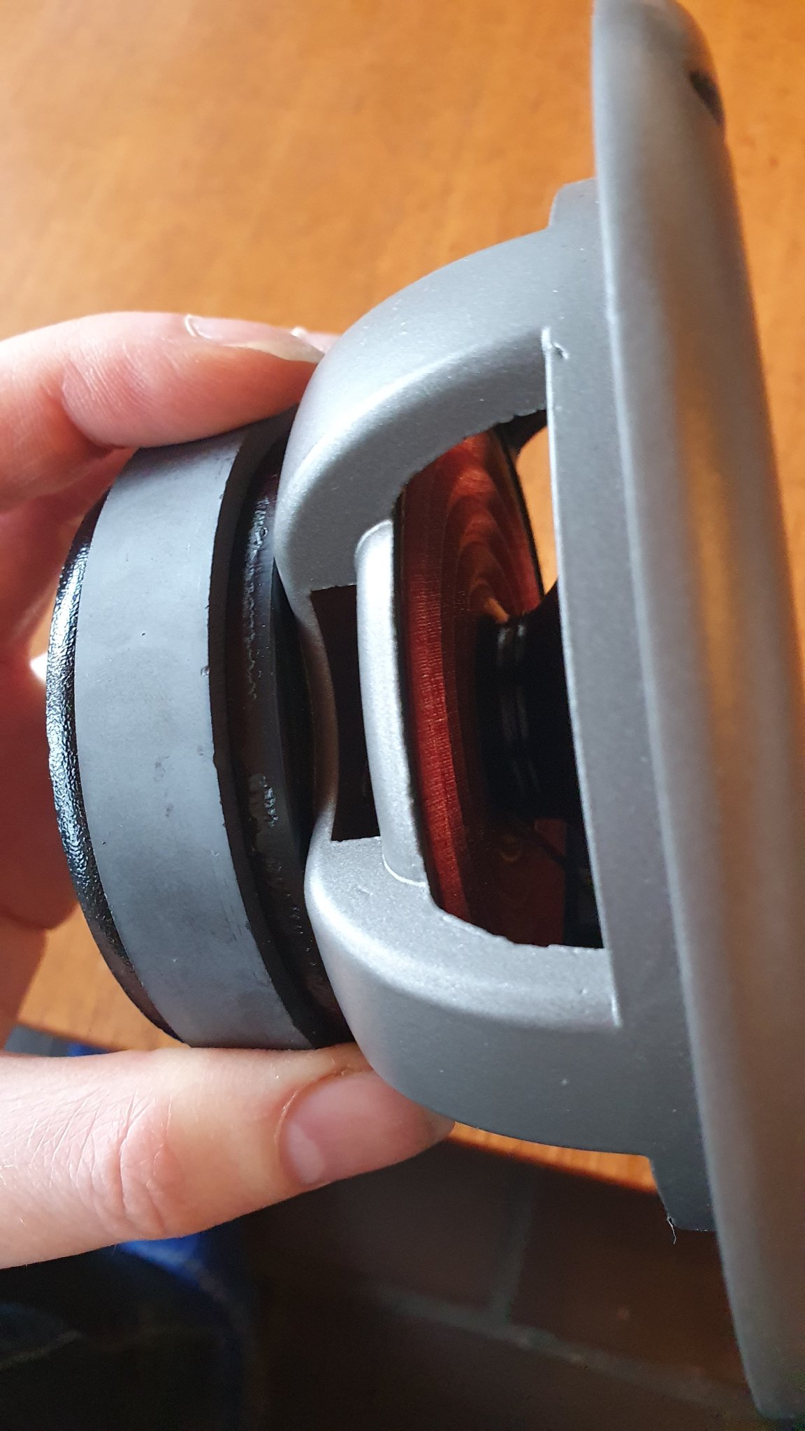

The 'ribbon' on the original All Ribbon speakers referred to the ribbon-shaped voice coil wire indeed. Those were from the days of the infamous Magnat Plasma high frequency units (heard that one once, I was impressed then). I guess you could compare it to the hexatech coils from Dynaudio some years after.

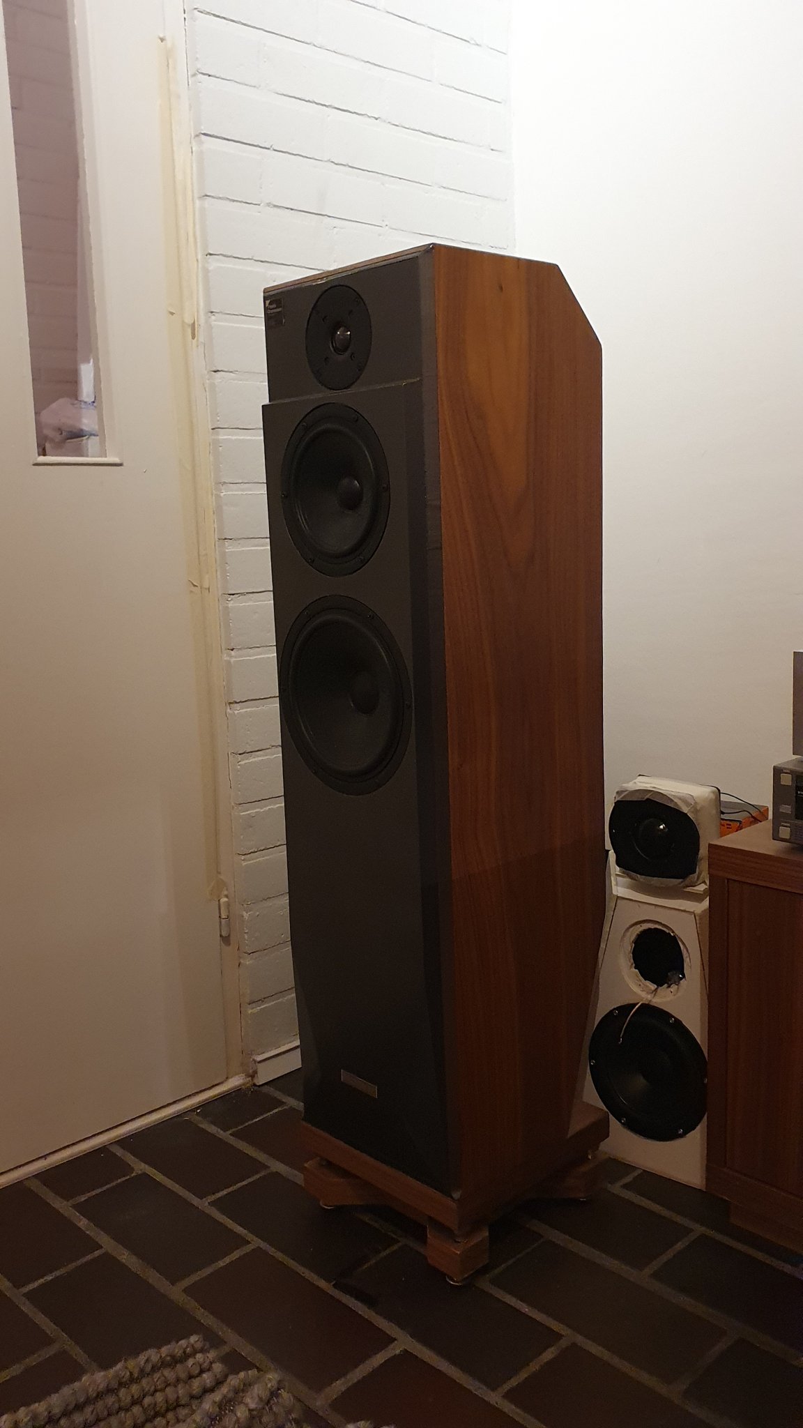

My next speaker after they got destroyed was Tannoy TD10 (look it up), only speaker that i felt was about same level as my magnat. That speaker got the highest ever reviewed score on old Finnish HIFILEHTI magazine that used blind tests as part of their evaluation, it was also hated by importers for this reason..
I remember by that time going into my first ever hifi exhibition in finland with my friend, i was expecting so much and was very excited. It was held in SAS hotel that is wide rooms, but concrete building.
I was totally and completely. disappointed, nothing at show made sound quality that was on the same level as my magnat at home, my friend shared my opinion. I stopped going into them for 10+ years because of this! (this was the first hint i had, how much room acoustics matter..)
Anyway as. i final take, one more story:
-I had my 40's birthday party last summer by this same house i lived by that time, and i had built Troels Faital 3wc-10 with Level 1+ crossovers (alumen z + duelund pure copper).
When i was putting the speakers up for party, my friend of over 20+ years came to help my setting everything up. He listened Faitals for about 20
seconds and said "These are not as good as magnat", and. i had to agree, they were much worse..
So, what is the final truth? We will probably never know. I think they did something right with this model, since i have listened some other magnat speakers after this and they were not as good as this model..

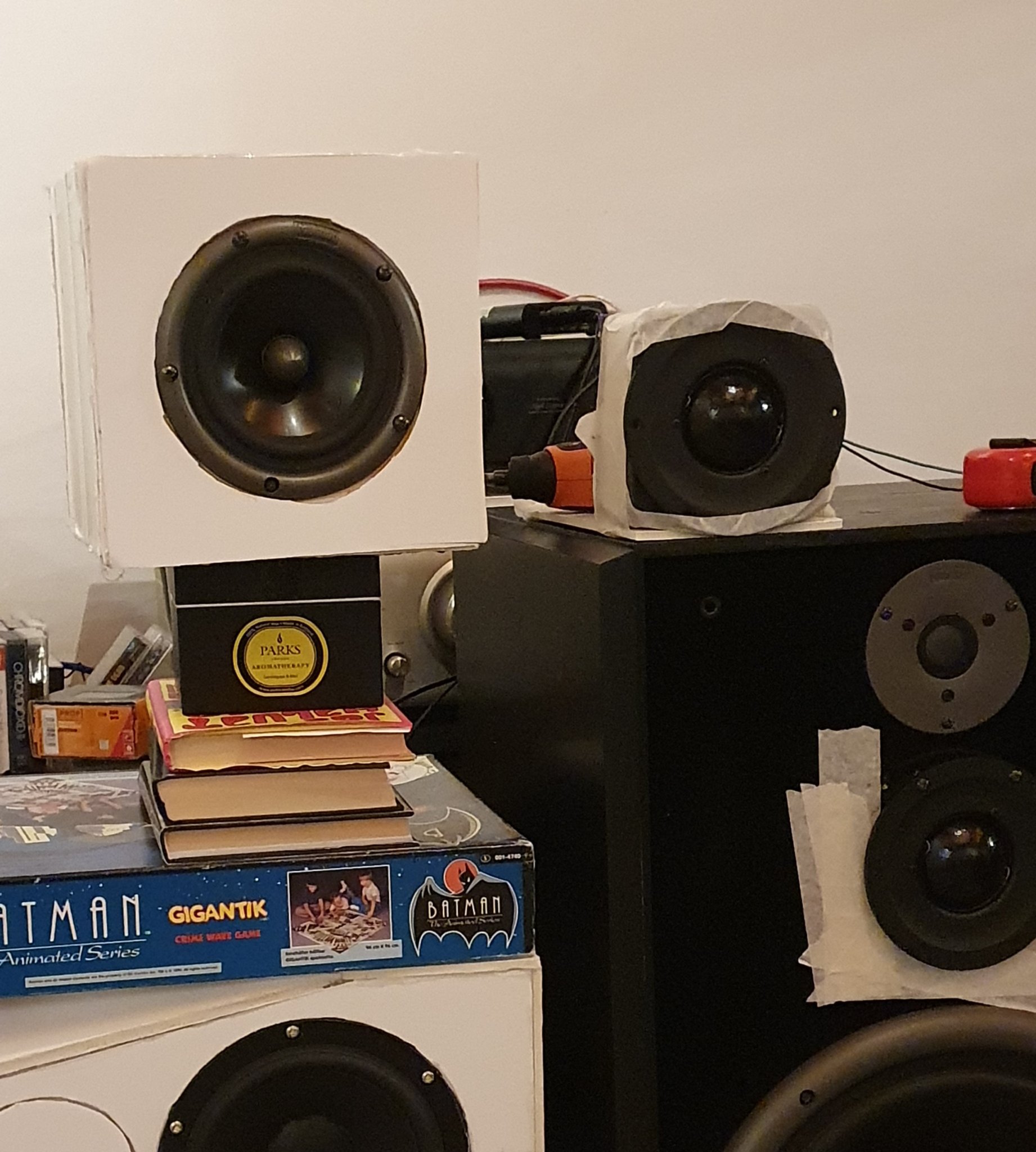

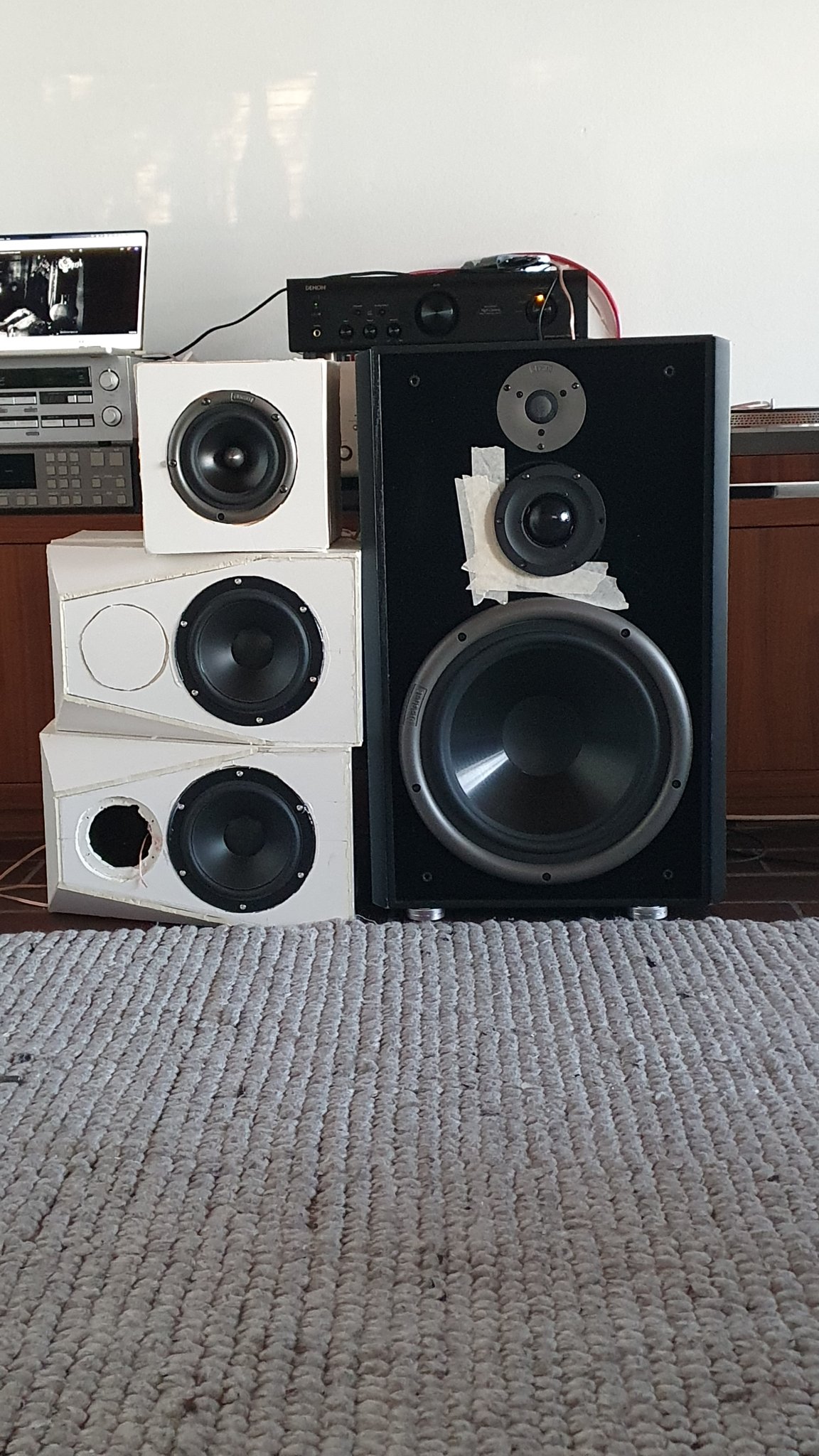

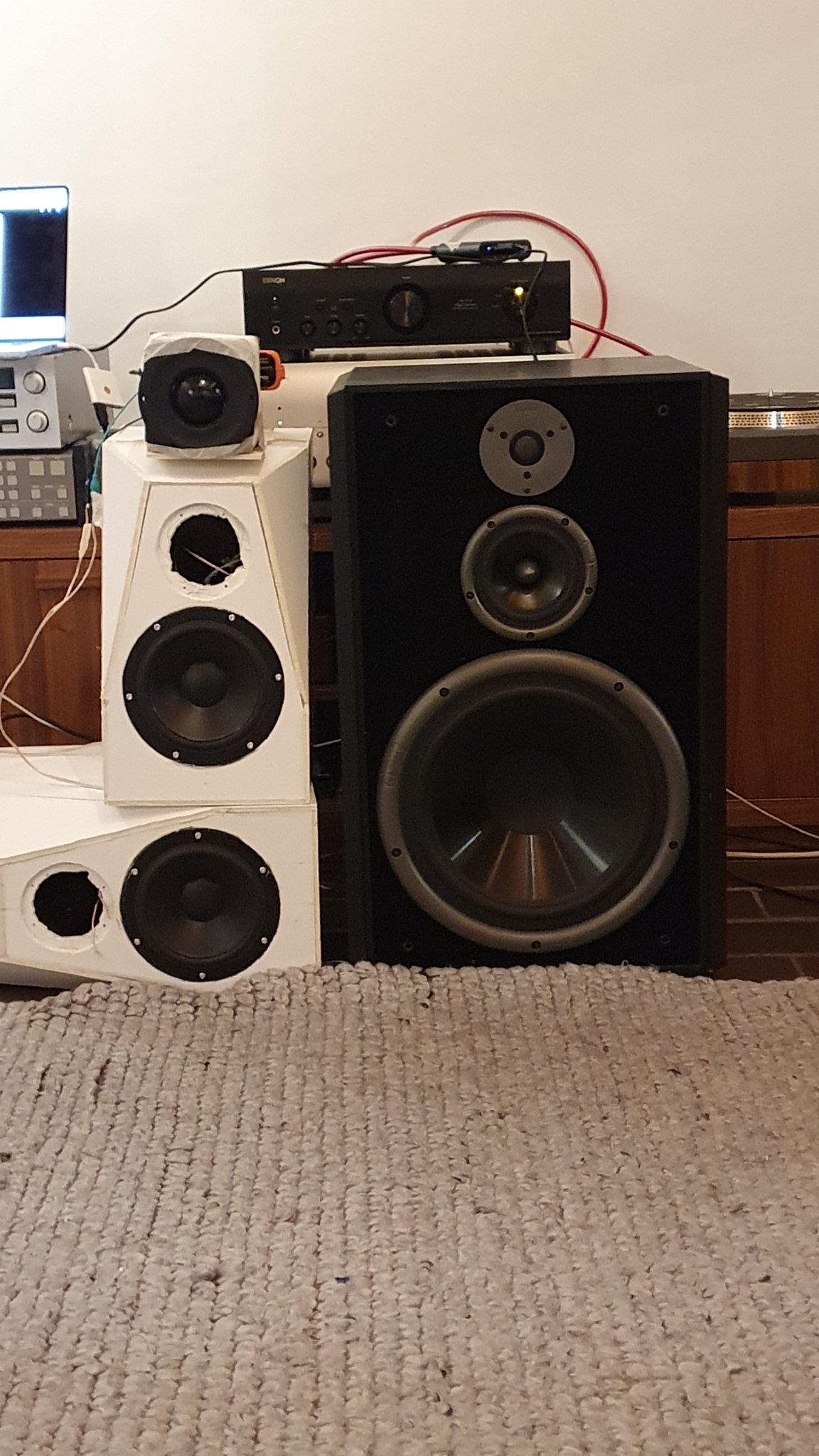

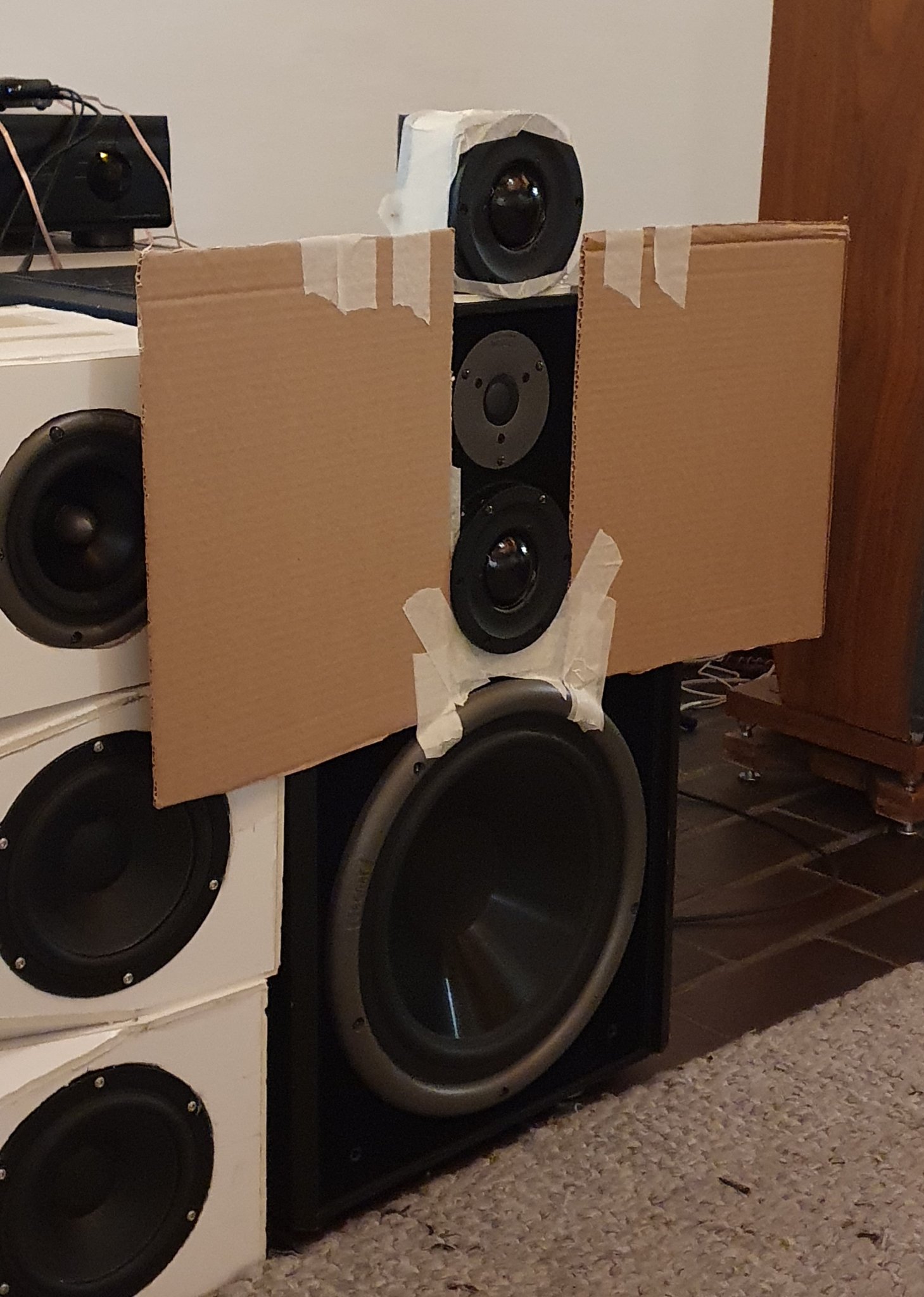

Actually, i was. also thinking in this case doing the makeover because i will be using them and do not like big black boxes anymore.. Maybe i should have written "remaking" instead of rebuilding..
But that depends the condition of drivers and bass driver ( should be fine, but lets test..)
NS2000 style:
NS2000 style:

Well a little progress, lets look at the drivers:
Bass driver:
-Seems fine, no damage that i can see, good build quality.
Middriver:
-No damage i can see, heavy for a 13cm unit!
Tweeter:
-Front panel looks like aluminium, but seem to be plastic. Dome is ceramic. Ok clean build quality.
-No damage from outside, next listening & measurement:
Bass driver:
Middriver:
Tweeter:
Listening Bass driver:
-It works!
I made crossover with active 3rd 60hz, basically to compare it with Troels Discovery 861, that uses 22W/8534G00 Discover 8" woofer.
I listened without other drivers, only comparing it to bass VS bass, so not much music over 150hz..
I listened Opeth ghost of perdition to see how it plays doublebass, and fast sharp drumkicks.
Seems ok, more powerful than 8534 but not as sharp.

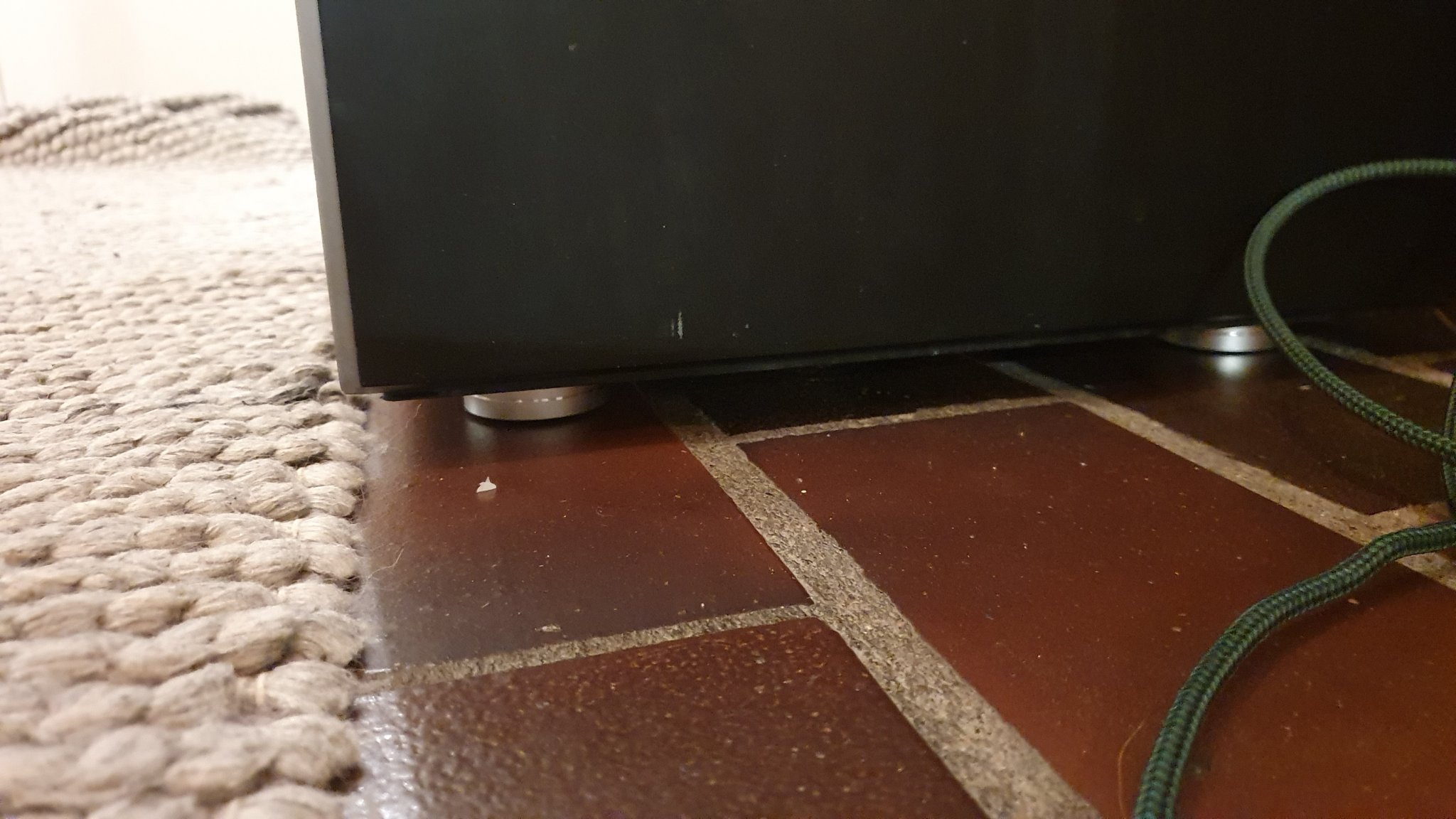

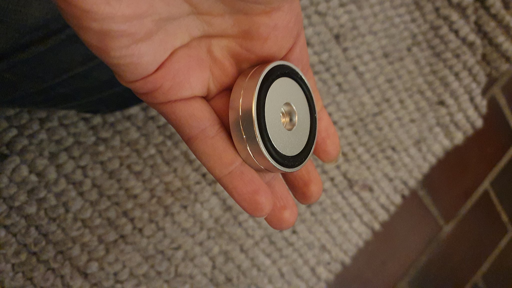

Could it need so footers? I have built complicated isolation stand under 861, so lets add something under magnat too..
Here it is with heavy aluminium&rubber footers.
Much better, now the tighthness is same with 8534, but plays louder and with more authority.. Promising.. Also tested it out with higher crossover to see does it sound bad with higher crossover, it did not..
Troels Discovery 861:
-It works!

Those drivers look quite OK to me. The tweeter resembles the Visaton KE25SC. Glad parts seem to be working.

I did first test on the magnat baffle using active:
bass lowpass 700 LR4
Mid lowpass 700 LR2 / Highpass 3500 LR2
It works, sound smooth and fine. But how does it test against modern highend middome?
Comparison test:
Same crosspoints for em1308 dome with AT 18h52 woofer on the left side.
Rough 1-speaker (channels put into mono) comparison test on different music, quitar, synth, etc..
Morel has as a midrange on same frequency:
-More Air
-More detail
-Tone is same, smooth
-It is "open" sounding, where as magnat mid in is "boxy" sounding in comparison, like muzzled over..
How much is the cabinet reason for this? Or mostly lack of it with morel?
Lets test it again.
I built small box for magnat mid, and put morel dome in magnat box, let's repeat the test:
Now the parts have changed, in this new configuration:
-Now magnat midrange sounds open and airy (than before in cabinet)
-it is now littlebit more open than morel dome
-littlebit more detailed than morel
In magnat cabinet, morel sounds now boxy, closed in, less airy and less detailed, muzzled.
I have been reading that old "classic" 3way configuration might not be so good anymore (Big sharp edged box), now that we have different ways to build and test cabinets..
Im actually starting to believe it based on this test..
Right now im putting building this further on hold, until i have more answers what kind of box would be best for these parts..
Would changing mid and tweeter configuration to similar offset like in ns 1000 help??
My brother has ns1000 upstairs (im building this on our workspace), i might need to convince him next week to loan it for me for a day top test it out..
I think i will ask more opinions (about different cabinet choises) and test a bit more. Maybe if edges are rounded, mid/tweeter offset from middle and bass does not have that "magnat" edge but is flush mounted?

Also, i need to order DSP that has 6 channel capacity, my humbly 2x4 minidsp is hitting it limits here..
Also tested out if the 1cm edges that go over the front baffle might be partly reason for lower performance.
Made two guides that overlap the edges. It actually helped a lot, and testing it out against same dome on the top, it does not give up too much performance now.. It seems the side were mostly reason for lower performance.
And one more test where the dome and cone midrange are the same height:
Now the magnat midrange really shows it real colours, it actually is a very good driver.. Almost same air & details as morel, but bit sweeter tone. I actually forgot to test things few times and just listened.. That IS a good sign.
Next week testing against ns 1000 to see, can traditional 3way cabinet be still good..
