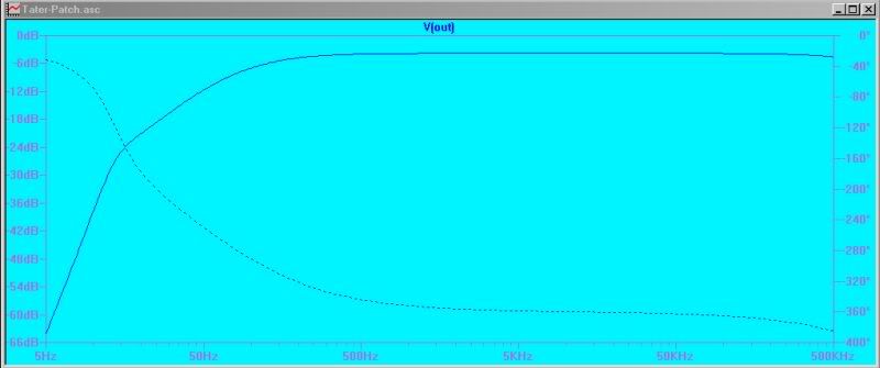

To be clear I have not made this amp yet, and I hope the collective wisdom here can point out any errors.
I intend to run my ribbons down to 100hz, so I need a sharp rolloff. The amp does double duty as a quasi 4th order highpass filter. By jiggering the coupling and de-coupling cap values I was able to get a progressively sharper rolloff with a 3db down point of 100 hz . As a bonus, this reduced the value of the cathode by-pass caps to the point that I don’t have to use electrolytic…beauty.
Simulating in LtSpice at 1 Watt gives this distortion breakdown…

The 1Watt FFT , and the 4 Watt FFT show a nice harmonic progression that’s mostly second order.
As shown, the the tubes are running with 240V at the plates, -3.1V at the grids, and at 37.25mA .
Iv’e attached the Ltspice .asy file along with the files for the output transformer for Yvesm’s OPT Assistant in case anybody wants to play with them.
Ok, be brutal…let me know if/were I’m screwing up here, as well as any suggestions to improve on it.

Oopsie...reviewing my post, I see the most imprtant part, the questions , didn't make it in (it was late and I was copying from Word).
Anyhoo..First, this is my first spice simulated design, actually it’s my first spice anything. Just how accurate is spice at predicting "real world" performance? I suspect it boils down to the accuracy of the tube model.
Second...I want to be able to swing the B+ from 150-260 so that I can find the operating point that best suits my ageing ears. The resistors in parallel of the cathode resistor will be a 20k pot so I can accommodate any bias needs. What approach would you guys recommend ? I’m thinking a dedicated variac, or, a series regulator. As this is intended for very efficient speakers, and has no feedback above 25hz, low ripple is a must. Any suggestions as to just how low I should shoot for ? I’m just starting the supply design, and want to make sure I’ve got a usable target.
Third…The ribbon that this will be driving will have NO tolerance for the low frequency swings that occur during turn on. I’m thinking a relay protection circuit. Is a simple delay the best way to go, or should I consider some sort of monitor circuit that closes the relay after it settles ?

> Ok, be brutal. . .
OK.
> -3.1V at the grids,
So why drop 8.25V in the 220 ohm cathode resistors? It isn't improving bias stability. Seems like six extra parts.
Why have three separate grid coupling R-C networks? One should do for the whole trio.
> a firm believer in the “simple as it can be” school of thought
I've just chopped ten parts out, and I say it will work the same. What am I missing? Oh . . . .
> I want to be able to swing the B+ from 150-260 so that I can find the operating point that best suits my ageing ears....What approach would you guys recommend?
Unless you like the sound of clipping, the highest voltage the tubes will stand. Why would a "starved" amp sound better? (Let's see what kind of debate that remark stirs-up!)
For the first decade, it is only 6dB/octave, pretty tame for reducing bass-slap. If you get clever with C7 L1, you can get a self resonance around 100Hz. Scale the R/L ratio for a Q-bump about 3dB at 100Hz, then shorten the grid R-C network so it is 3dB down at 100Hz; you get flat to 100Hz and 18dB/oct below that. THAT will keep the bass (and much of your start-up thump) out of the floppy ribbon. And incidentally, leads to cheaper parts: like 1uFd and 4H. Do some more fiddles to get your desired slope 50Hz-100Hz.

Hello PRR
The resistors in parallel with the cathode resistors represent a 20k pot. This gives me the flexibility to match the tubes operating points, it also provides for changing this point around.
Agreed..however, I noticed during simulation that the tubes see-saw, ie, when I lower the bias of one, the other two go up when set up with a common R-C. In fact, when you cut one out (think loosing a filament) the other two started dissipating around 20 Watts each…not good.
See above
Well I don’t want to clip the amp, I figure my max volume will have to go down with the B+. As far as “starving” goes, in its current configuration I’m technically “over-feeding” it as it has an official Vmax of 150V. I suspect I’ll end up were it is, I just want to be able to confirm were it is, is “right”.
Look closer (I know, it’s a junky screen grab), the curve is progressive, its down 9db at 50hz and ends up at 24dB per octave around 25hz. I chose the gentle initial slope so as to not throw the phase to far out at the x-over point. It’s -75deg. At 100hz. It’s a balancing act to be sure, and I may have to change it.
Hmm…I’ll have to play with that…interesting idea.
See above
It's a good idea to stick to this plan because of the very wide variations in the specs of these hot tubes. The whole idea seems a redundancy but it's really a good way to handle 6C45p's. This is DIY after all and "engineering economy" is no issue.
John
EC8010 said:The input capacitance of your proposed amplifier will be rather large to say the least...
I guess roughly 350-450pF.
distortion figures using LTSpice
Valveitude :
Your tube model is using Koren's equations, and I have found it to be pretty good, so your tube model probably should be OK.
But there are 2 other factors that can affect the reality of distortion indicated by spice.
I'm confoozid...wouldn't that value range shunted by 33.3k (100k/3) indicate a roll-off between 10kz-15kz ? My simulation shows considerably more extension than that. What am I missing here? Truth be told, I selected the grid resistors based on this circuit , as it seemed to be the "optimistic" choice. I may lower it.
Does the input capacitance effect more than the frequency
response ?
P.S. I can sleep easier Sy knowing your extreme makeover has seemed to be a success. Your old avatar was giving me the willie's ( I suppose that was the point )
Good to hear
The first is the transformer. Your transformer model is not very realistic in that it has no resistance, or capacitance, or core saturation effects.
Yah, I know. Since I will be winding it myself, I don't have any "real" numbers to go by. I figure that it will be the limiting factor in the actual amp, and its performance compared to the projection will tell me how well I did winding it.
There are several ways to model the resistance and capacitance
Which method would you suggest ?
The second thing to look out for with respect to harmonics with spice is the minimum time step used when you run the transient analysis. I only mention this since you state this is your first time spiceing something. You may already know this.
I found this out the hard way. After getting some screwy results, I searched this forum and learned about the time step thingy, I also saw that the sample window needs to be divisible by the freq., ie, a 12 ms sample for 1k.
So that I dont have to recalculate stuff every time I change frequencies, I use the following set of parameters in and include file :
Egg-suh-lent!!! I WILL play with that. How do you toggle between fast/accurate ?
Casey

The RC time constant you need to look at is the source impedance of the circuit driving the Spud with the Spud's input capacitance. Then verify that the source has the capability to source enough current to drive that capacitance to whatever is the required voltage at the highest desired frequency.
Dirch Passer will only be grinning at you until I find an even ookier avatar. The search continues...
Gotcha..thanx. Putting 5k of resistance in series with the source dropped the 20khz response .5 dB. The whole system is starting from scratch, looks like I'll need to ensure my source impedance doesn't drop below 5k, preferably 1K.
Oh goody...can't wait.
Uhh..that should be "doesn't rise above 5K"..think I'll go snif some more glue.

I use the following type of model. It can be expanded to do push pull, and ultralinear, and multiple outputs.
.SUBCKT 5KSE P1 P2 Sp1 Sp2
* Single ended audio transformer
* 5k to 8 ohm, 10 to 40KHz
LP1 1 P2 40.26021568H ; PRIMARY
LSA 2 Sp2 0.064416345H ; SPEAKER SECONDARY
KALL LP1 LSA 0.999499875 ;
RP1 P1 1 56
RS Sp1 2 .1
.ENDS
Basically you can set the 3 dB points by varying the coupling factor. So if the 3db points are specified, you can calculate the required coupling factor. I have the eqautions somewhere, but I am having trouble finding them. Basically they are the equations for broadband transformer coupling. I have a spread sheet I use for the calculations.
Now the model is not totally realistic, but at least it gives an upper and lower frequency roll off. I have tried other models based on a leakage inductance combined with a transformer with K =1, but I found these gave trouble in some circuits for some reason.
In the transient dialog box I just enter the parameter names rather than values ie for the full accuracy run
for Stop Time enter {Period2}
for Start Time enter {Period}
for Maximum Timestep enter {hTMax}
I start at {Period} rather than 0 to give the circuit time to settle down a bit.
for a quick check I do
Stop Time {Period}
Start Time 0
Maximum Timestep {TMax}
and of course on the schematic I have the statements
.inc MyLibs.inc (which contains those equations, and other stuff )
.param Freq = 1k (or whatever I want )
and in my voltage source and Four statement I put {Freq} wherever a frequency is called for.
