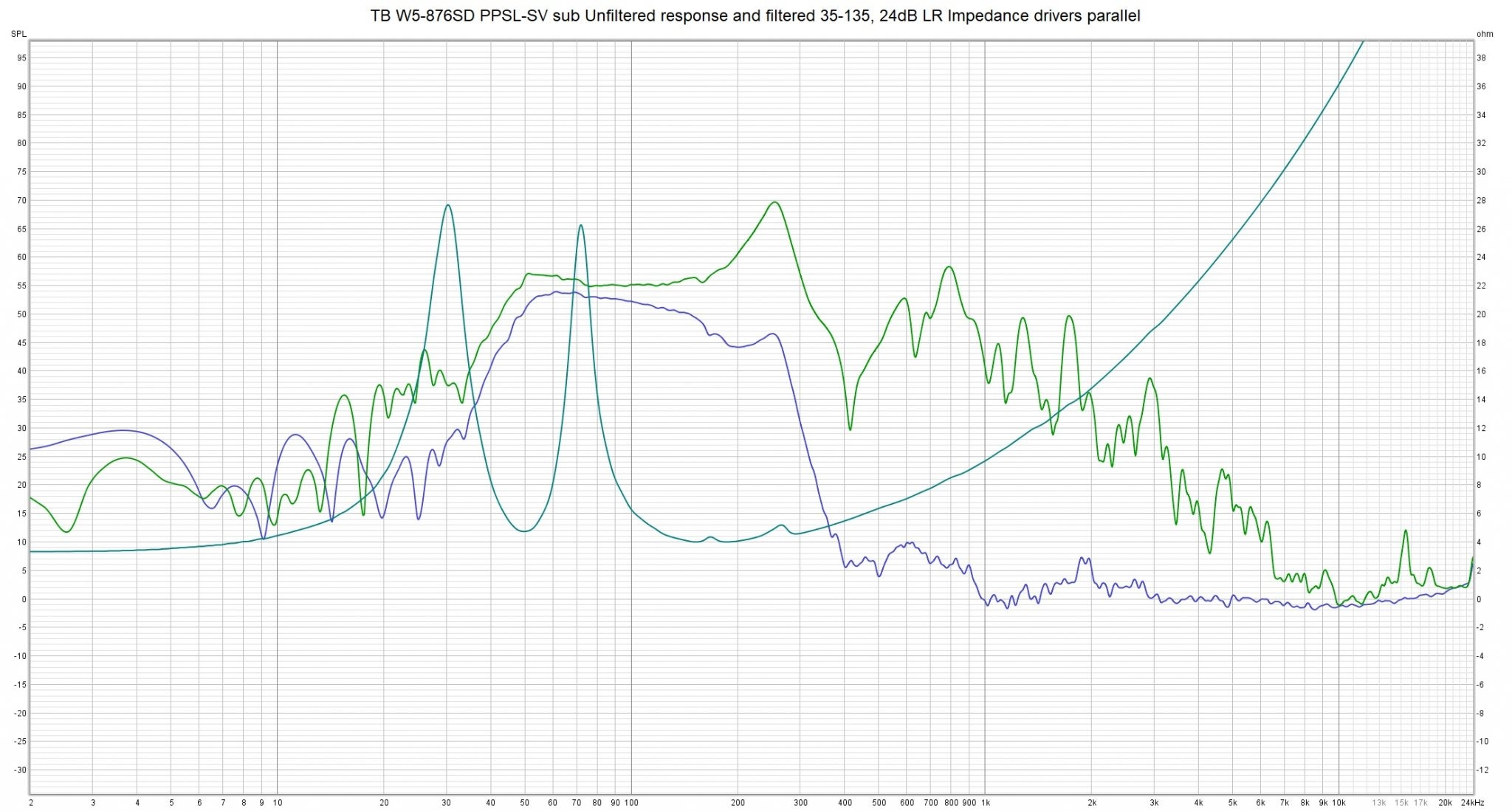

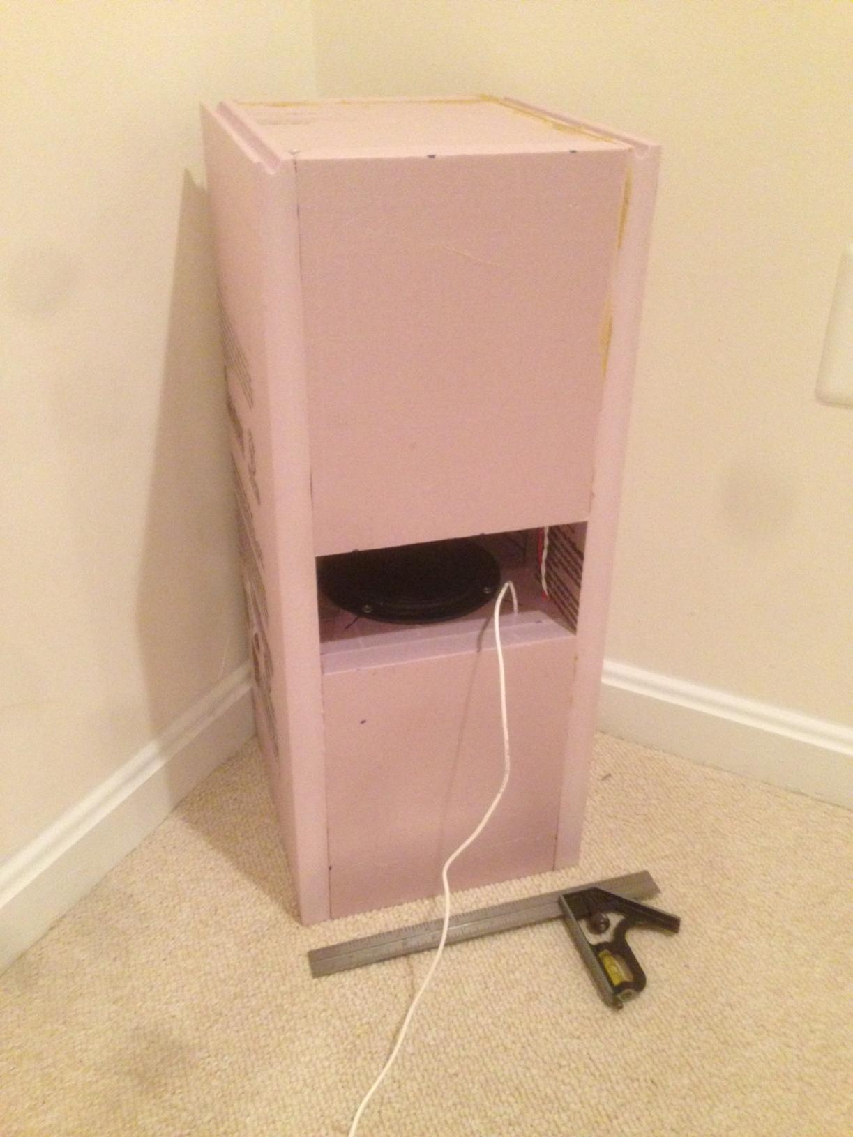

I made a band pass sub with two 5.25in Tang Band sub drivers in a tall format that may work for you. Would have to recalculate with driver of your choice but you get the idea.
https://www.diyaudio.com/community/threads/light-as-air-slot-loaded-band-pass-sub.258433/

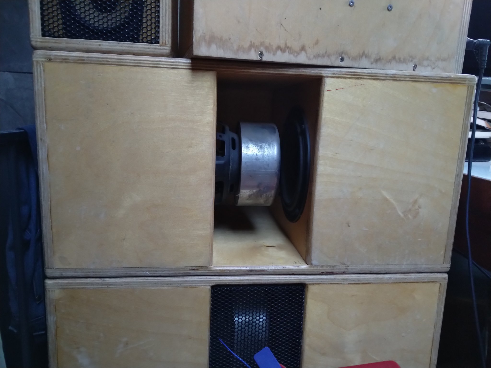

I built a couple very very similar to these to use as subs for a battery system, imo they sound great, been running them for a few years now. People are often surprised at the Spl from only 4 5 inch drivers! The peak in response above the passband does need taming with parametric though... Paired with a couple of dual 3" mid tops with dome tweeter.
