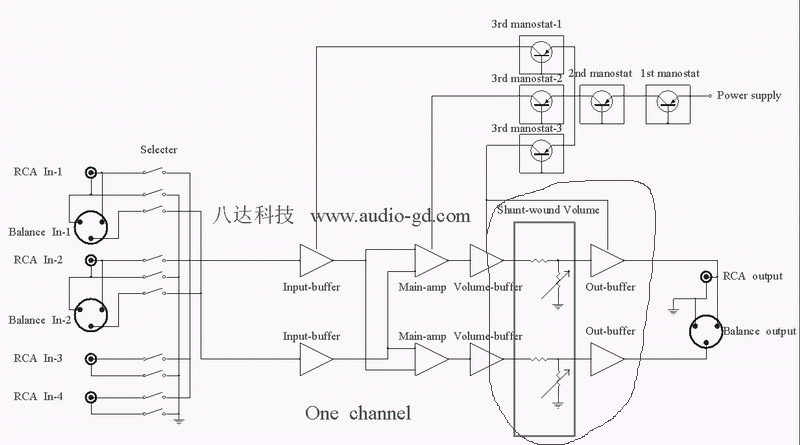

The remote control paratactic volume control
The very good control type,it can better than R2R control type.

I dont want to rain on your parade but i would like to mention a few dissadvantages with your design. Depending on your volume setting your input impedance is different this means a different noise figure and a different bandwidth (which again means different noise figure).
Sorry but i just noticed your image. Iam not a big fan of having the volume control ONLY on the output (or in the middle). While having the volume control not on the input increases the noise performance it degrades the distortion. Your input stages are going to be swinging large voltages compared to a circuit with a volume control on the input. I guess its one trade off for another, designer's preference
