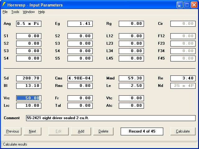

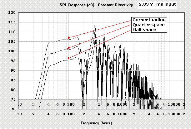

After many TH, FLH, etc high efficiency pa designs... and the last xxx years in car audio before going pa... I'm still of the opinion that a small sealed sounds best in-car. That's not to put down unhorn, ported, bandpass, or any of the other interesting designs out there.
To show my point: Here's a simple sim of the lowly 55-2421. (ok, 8 of them) That fit your requirements. Even a 3015lf in a 50liter sealed will accomplish your stated goal.

plug in the hornresp numbers I gave you above, and you'll see what it can accomplish.
But the short answer is yes, 8mcm or a 3015lf would accomplish what you asked.

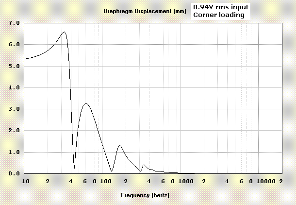

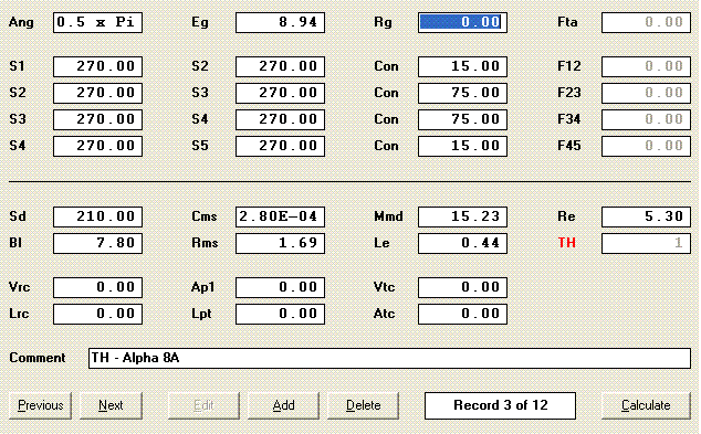

And just for fun, here's a design using a little 8 inch mid-bass driver (Eminence Alpha 8A) that delivers the goodies.
An amp capable of 10W into 8 ohms (or 20W into 4 ohms) can drive it to Xmax in band and close to Xlim out of band, so it's ideal for those little bridge amps that run straight off the "12V" battery.
I've no idea how "room gain" works with horns in cars though.
p.s. I've been thinking about this for home use - 115dB over 2 octaves with a 10 watt amp - yum!
