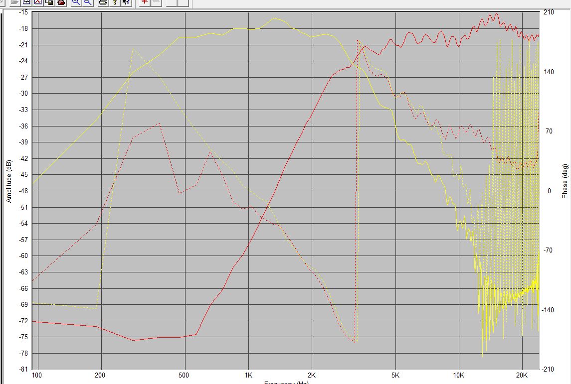

Probably several ways to approach DSP allignment and achieve a good result. I would be tempted to add the high pass and low pass filters that gave a combined response (driver and network combined) that looked most like a Linkwitz Riley shape and then just adjust time delay while watching the combined frequency response. Most DSP programs let you fine tune delay and it should be very easy to see what particular delay gave the best sum, especially if you can adjust the delay on the fly.
The problems with looking at ETC is it tends to direct you to allign delay for the middle of the woofer's range relative to the middle of the tweeter's range, etc. You really need to get allignment for the crossover region, rather than the driver's mid sections.

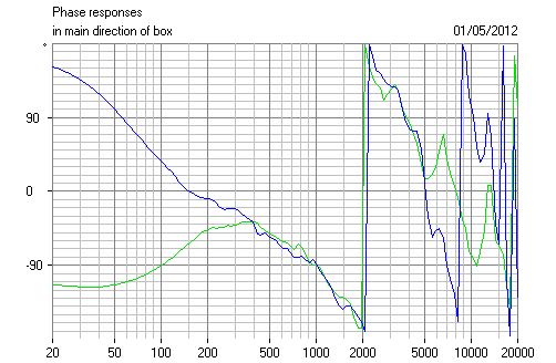

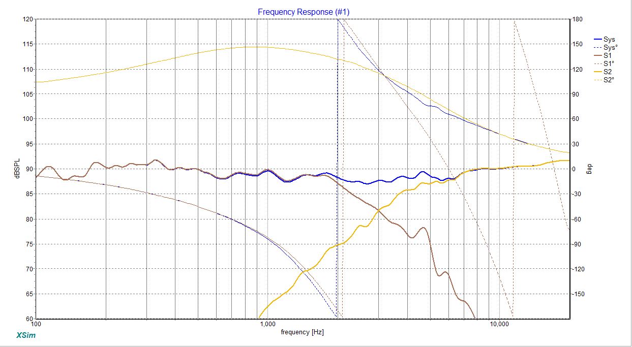

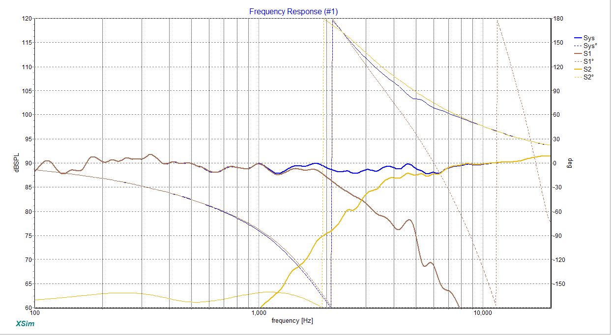

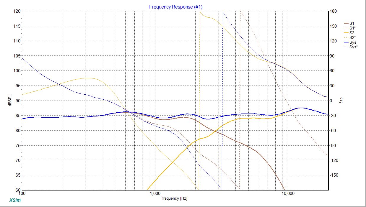

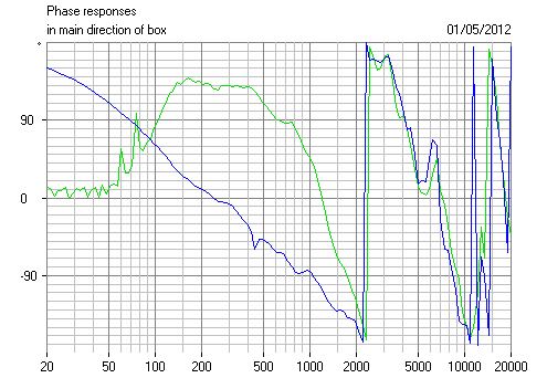

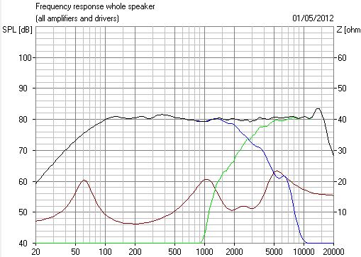

Sorry to revive an old thread but I'm not sure if I can start a new one(and didn't know how). I have been using X-Sim for awhile now but am just now realizing the importance of phase tracking. Can someone take a look at these and see if Phase is good and if not, maybe give me some info or tips on what to look for? Thanks
It looks OK. You can't do a great deal with phase, with a single measurement per driver approach other than to see they are near each other, say within 90 degrees.
my understanding is, get the amplitude as close as possible to your acoustic target.
trouble is, i see a lot of crossover talk where the acoustic output is not mentioned.
get the acoustic target right and the phase will be correct i.e. if the output is LR4 the phase is LR4.
then, delay caused by driver offset and the action of the crossover filter can then be dialled in.

Thanks AllenB. These are three different crossovers. I'm wondering which one is the best as far as phase is concerned? My guess is XO-2-phase? When each driver phase curve switches from -180 to +180(vertical lines) is it best to have those as close as possible or even overlapping being the best? Is XO-1 not as good as XO-2 because the vertical lines are farther apart in the crossover region? Sorry for all the dumb questions but I am fairly new to this and want to make sure I am looking for the right things in X-SIM as far as phase is concerned. Thanks for the help.
