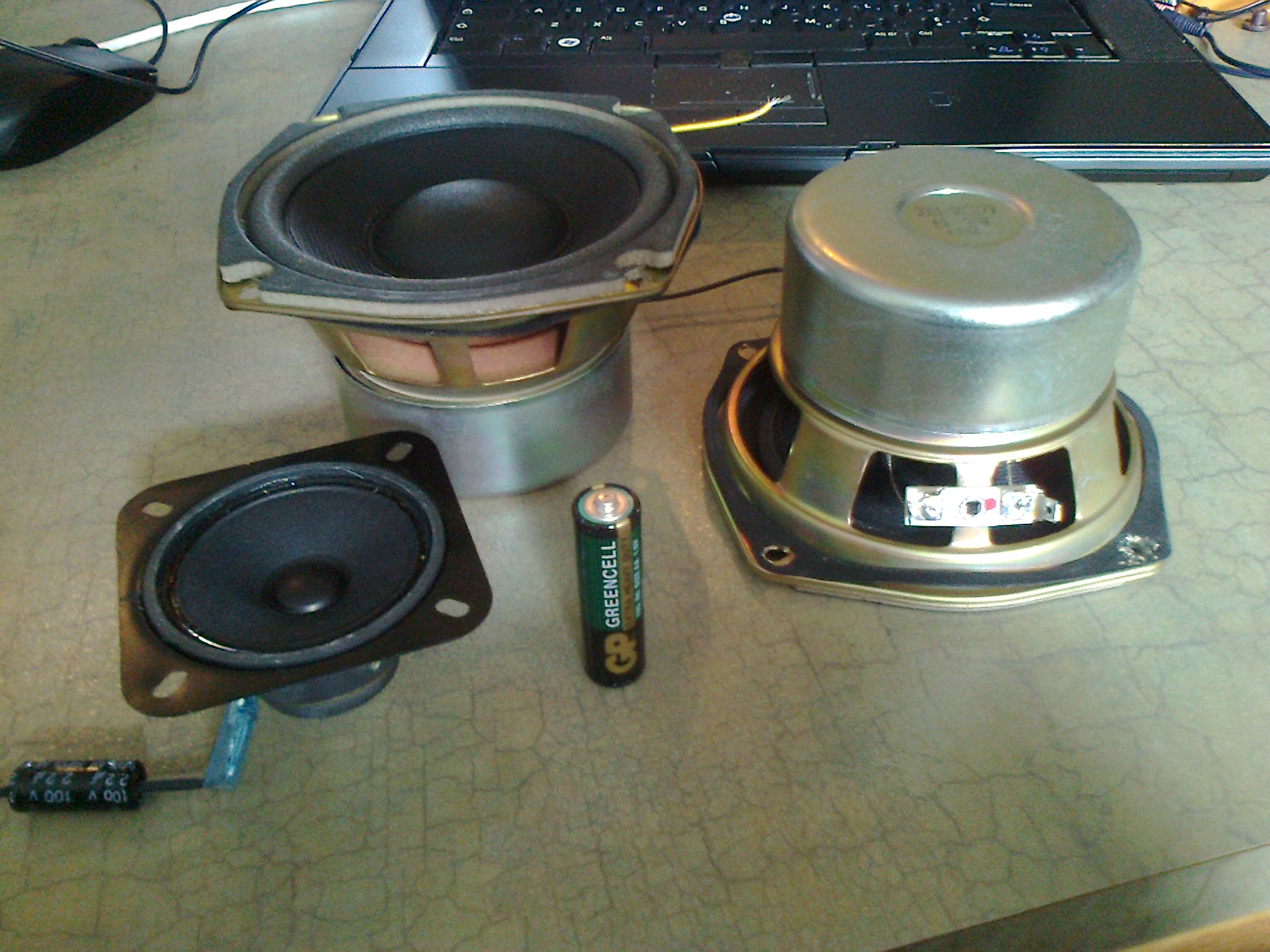

I have a pair of speaker already bridged removed from an old samsung TV. As they look good for me, I like to build a wood box to re-use it. As I am more carpenter than an electronician. I like to know what should be the internal volume requested for an ideal wood-box.
Hear are the specifications found for those drivers
3001-001107 Samsung Speaker, ;20W,8OHM,95DB,1300HZ
3001-000279 Samsung Speaker, 30W, 8OHM, 91DB, 20HZ
capacitor 100v 2.2uf ( the crossover )

I don't think anybody can help you with such, as the information about your speakers isn't sufficient. Can you please tell us what size the little woofer is and if possible post pictures.
I'm guessing it is about 4 or 5 inches and if it is a sealed box of about 5 liters may be a safe bet

Obviously a 4" woofer and a 7 cm closed cone tweeter:

Closed box of 3 to 6 liters depending on whether they are 3 or 4 inch woofers, stuffed of course
The other alternatives might be a tall old fashioned transmission line type speaker or Voight pipe.
With an Fs around 70 - 100Hz you don't get much real bass from these tho

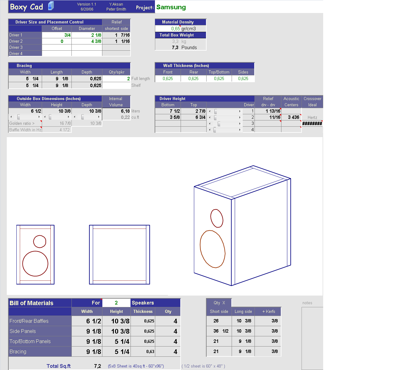

I am impress by all the discussion found under my first concern. It is already useful for me as I found a spreadsheet to help me in designing the box. I will also read more about thing you write. (a tall old fashioned transmission line type speaker or Voight pipe, ...a double chamber reflex )

Here is a first draft for a 6 liter Canadian maple box made with boxycad2 (a nice tools)
