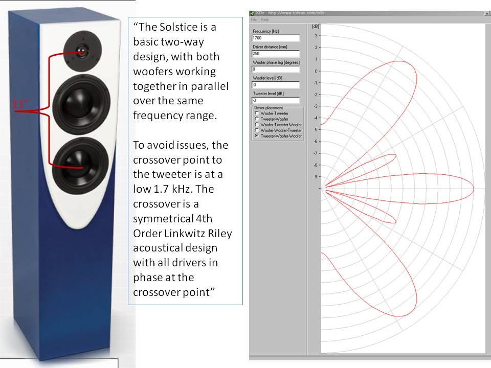

Magazine Reviews:
"Both midrange-woofers cover the same frequencies; this is strictly a two-way design."
" is a two-way, three-driver design, and makes use of very high-quality drivers sourced from Morel and Dynaudio. The two Morel 6" damped polymer composite woofers feature over-sized 3" voice-coils and double magnet construction to optimize linearity, dynamic tracking and power handling. The Morel woofers operate in parallel up to 2kHz, where they cross over to a 1.1" Dynaudio Esotar tweeter. The Esotar utilizes a silk dome and approximates free-air loading via an oversized vent on its pole piece and an aperiodic damping chamber. Like the Morel woofers, the Dynaudio tweeter is designed for extremely high power handling coupled with low distortion and superior linearity at all power levels. The Fontaine II's crossover is of commensurate quality, employing Hovland MusiCap capacitors and Vishay resistors in a 2nd-order, 12 dB/octave configuration. These electrical components were chosen by EgglestonWorks for their sonic transparency and power handling qualities. All internal wiring is by Transparent Cable. Single-wire cable connections are provided via a pair of Cardas five-way rhodium binding posts. Unlike some of the more expensive EgglestonWorks loudspeaker models, which utilize Isobaric and modified transmission-line loading for the bass and midrange drivers, the Fontaine Signature makes use of conventional bass-reflex loading for its woofers via dual ports located on the rear of the cabinet."
The Fontaine Signature by Egglestonworks is similar to Jeff Bagby's Morel-based Solstice kit sold by Parts Express. The Solstice gets good reviews from diy-builders. BUT..Simulation of this TMM topoogy with the 11" C-to-C between the dome tweeter and bottom 6" midrange shows lobing with comb fitering. If you favor this cabinet shape, I would look for a real 3-way T-M-W design with a sealed midrange and ported woofer.
--------from earlier Soltice post--------
The Solstice uses a TMM topology where both 6" midrange drivers are connected to one crossover circuit with a 1700Hz acoustic LR4 slope. The Center of the tweeter -to the- Center of the lower midrange is over 10" (250mm). Simple "xdir" simulation of the polar interference patterns around the crossover frequency due to this large C-to-C suggest that an experienced listener would notice a change in the soundstage, both from "location queues" and "variations in SPL" as sound energy oddly spreads over a wider room volume. Seating position becomes more critical.
A more traditional TM-W three way would put the top 6" midrange in a small sealed volume for optimum transient response, and use the lower 6" midbass as a ported bass reflex woofer. This would require a 3-way crossover, although a 2.5-way circuit has been used in several successful designs == a separate inductor adjusted for a lower frequency is connected from the top midrange crossover circuit directly to the bottom midbass.

canvas,
My goal was to present simulation data and generate discussion on 2-way TMM designs like the Fontaine and Solstice as a caution that lobing and comb filtering would occur which trained-ear listeners would find "off".
A 1700Hz crossover sine wave corresponds to a 7" wavelength. When the separation between two or more drivers vibrating at 1700Hz starts to exceed 7", cancelation between a +sine pressure wave from the tweeter can angle-mix at the listener with a -sine pressure wave from the lower midrange and generate null pressure zones around the listener(s). Beaming starts, and turns into comb filtering.(attached Xdir sim)
