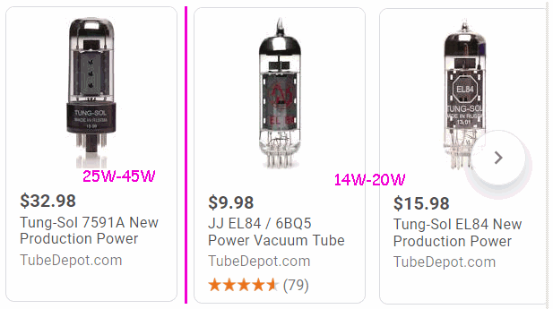

I have not done that yet. I just unloaded the console and read through the original manual it came with. It is a Fisher Electra VII, Model E-49. I learned something new according to the original manual. I believe this unit will allow me to use a variety of power tubes. I believe my current model uses 7591A power tubes, however the manual for this model says that it uses EL84 or 7189 power tubes (states that it is auto-bias), but no mention of the 7591A. The goal tomorrow is to pull the power amp out of the cabinet and put the two units side by side to see how close to identical they are. I started Googling this evening, and it may be that these are very similar units, but not identical. If that's true, then the idea of using them as a set of mono-blocks is probably out, but I could still use them as a set of pretty closely matched set of horizontal bi-amps (one used for lows, and one for highs). I guess I'll find out more tomorrow!

..... 7591A power tubes, .... EL84 or 7189 power tubes...
Not even in the same league.
If the Fisher was a car, offered with wide choice of engine, the 7591 is "the V-8", the EL84/6BQ5 is "the Four".
EL84 is a very excellent tube. The 7591 goes a bit louder, and the number on the spec-sheet is about double.
