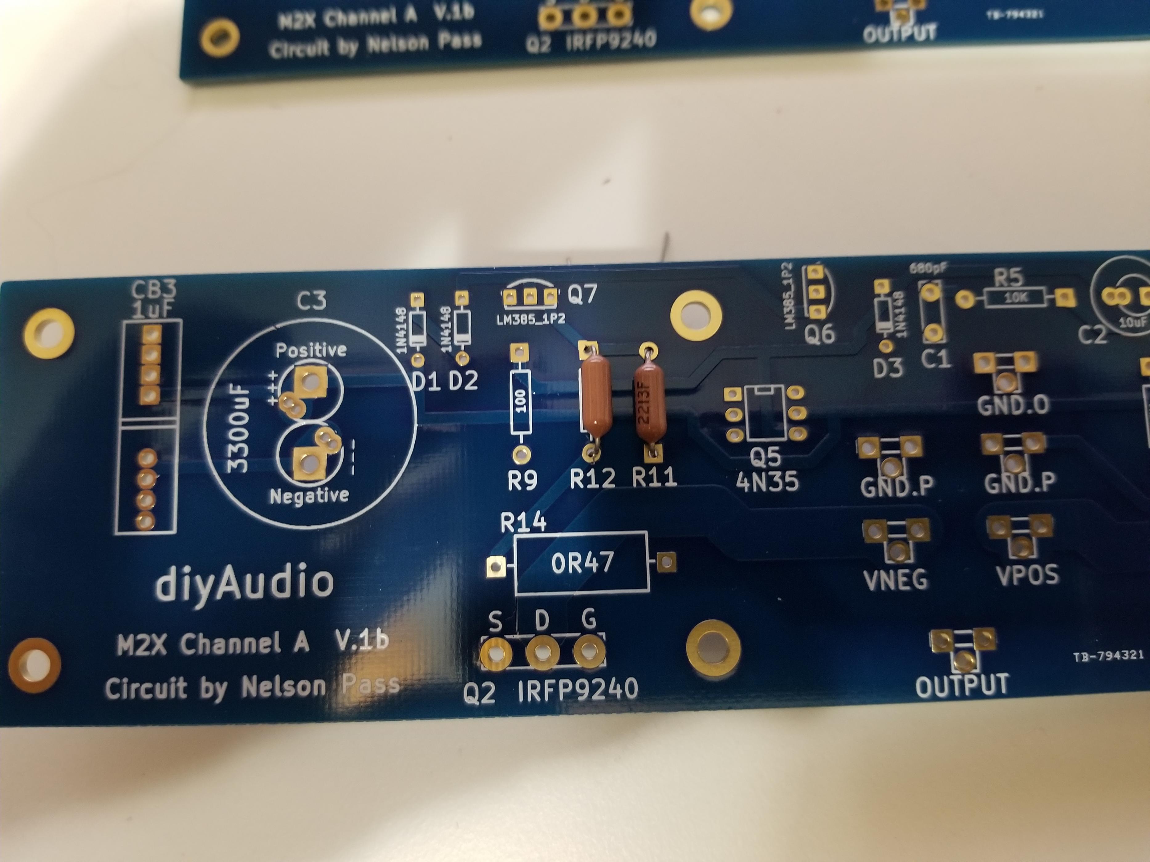

As promised, here is the report on the replacement M2X boards. Four were sent and all four are defective. This is the specific reason. When only two resistors, R12 and R11 are added to an otherwise blank card, the reading from the bottom of each reads 221 ohms, not the correct 321. So the board is creating some additional, faulty path from R12 to R11 that negates the 100 ohm value of R12 and supplies only 221 ohms. The schematic makes it clear that no such path should exist and that the path from R12 to R11 is direct with no other components installed.
This value, along with the incorrect path, will keep the Optocoupler from limiting the voltage rise and, therefore, none of these boards will operate.
To be careful, one of the boards had the 3-step build mentioned earlier completed. First R14, R12, and R11 were installed. Incorrect reading of 221 at the bottom of the resistors and from R14 to Pin 2, 4N35 Opto. Then the rest of the resistors for this portion of the circuit were added: R9, R13, R10, and R8. Same 221 ohm reading. Finally, the Diodes, transistors, and OptoCoupler were installed, the latter with a Dip-6 socket to ensure security. Same 221 ohm reading and the same defective board that will not, of course, operate.
The post is supplied for potential purchasers of these boards so that they know that one person, who has built 4 of these boards completely, and has tested four others, has received only one working board. Because of these incorrect boards, over $400 has been spent on wasted parts and over $1K on the total project including power supplies and chassis that now serve no purpose.
The DIY store has been informed, now 3 times, of this problem and should test their remaining boards for the problem described above before continuing to send out defective merchandise. Failure to do so will generate many disgruntled DIYers who have no working M2X and lost monies.
Craigl59, If you measure 221 ohms with just 2 resistors installed, then it's most likely there should be some path on the board shorting the two ends of R12. Measure just R12 first (you should get a short there) and then put one probe on the bottom point of R12 and poke arround with the other probe to find the path that is shorting the R12.

Alvis: Please re-read my explanation above: no components other than the 2 resistors are checked at first. So any short, if existing, must be a board problem. Have spent the time to check the correct continuity of each component on the board and to also check for shorts to other components -- for all of the board parts and for all the short possibilities. Found none and this is, of course, curious. But the fault described above exists, is on 7 of the 8 boards sent to me, and will not go away. Nor has it ever been explained by others on this board. The proof that this is a board issue comes from the fact that one board sent to me operates correctly, has the correct reading of 321 from R12 to R11 base, and functions properly within the circuit.
Dantwomey can help us a bunch by measuring R12 and R11 on his boards and reporting his readings -- along with the date of his purchase.
This is not about belief, this is about the described facts. No-one wants working boards more than me.

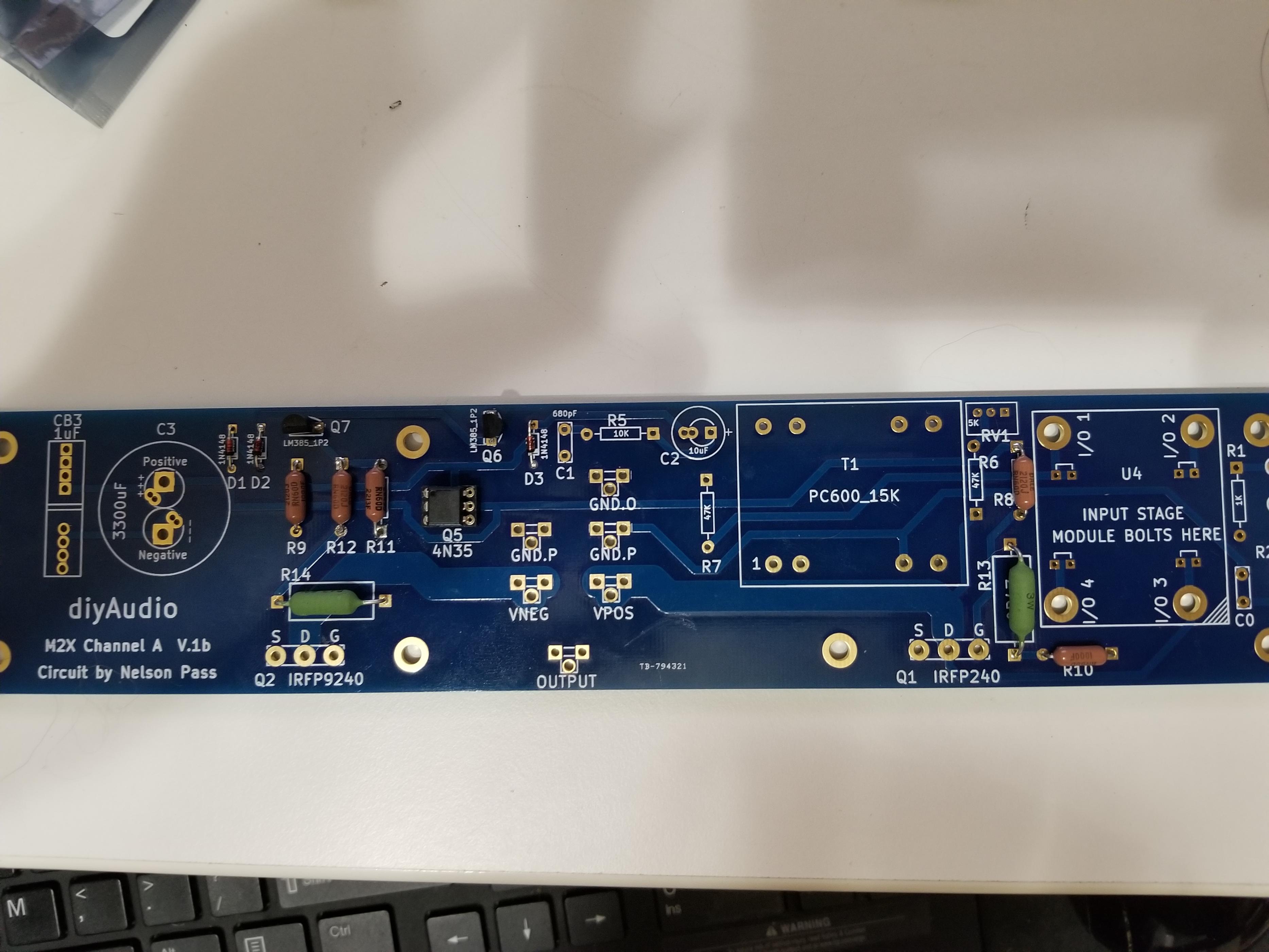

Here are pics of the 2 testings -- they just show what is described and do not, as far as I can tell, provide any helpful data. All of the connections are properly made and because of the board problem, are irrelevant to the issue.

Here is a picture of my partially completed boards, bought in March 2021. Check the revision date with yours because I just completed these last night, started up fine and played music without an issue.
Looks to be a DMM issue, resistor issue or a measurement issue at this point, because it’s not the DIYA boards.
Edit: noticed Q6 on bottom board is backwards, obviously that was fixed before powering it up.
Tim writes:
"If that is the case, then a DMM will read zero ohms across R12 when it is installed, and from pad to pad if no R12 is installed."
R12 reads the correct 100 ohms across and OL from pad to pad when R12 is removed. Again, as noted above, cannot tell why the problem is ocurring and that all of the continuity and short tests made show no problems. But the incorrect reading of 221 for R14 to 4N35 will not go away, is on all of the non-working boards, and IS NOT on the one board that I have that is working.
YOU TELL ME why this value can appear with only two resistors installed -- please do so.
