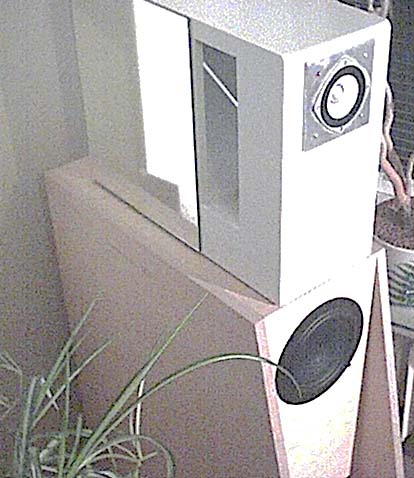

the desktop miniparagon (with fostex drivers)
I wouldn't mind having one on my desktop. Takes up a bit more space though.
now this is just too damned cute, and quite a piece of craftsmanship
kudos to the builder
